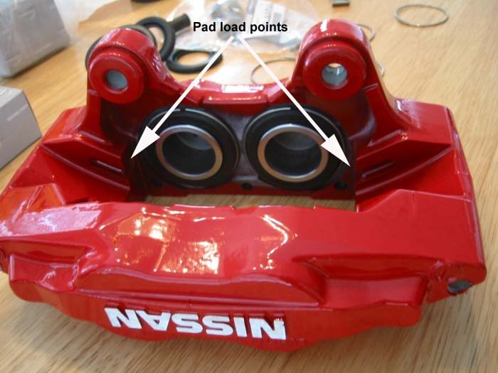

I am currently in the middle of doing this conversion and I have what may seem like a silly question but,
The Nissan calipers are to suit a 30mm disc rotor and the HQ discs are 25.4mm. Is it possible or not advisable to use a pair of shims/ spacers on each side of the pads, up against the caliper pistons to reduce the pad to rotor gap.
As Datto mentioned, rotor wear will be now more critical due to the difference in rotor thickness that the calipers were originally designed for.
Depending on the design of the caliper and the thickness of the spacer there may be a potential for the pads to be ejected from the caliper once worn down to the pad backing plate.
You should check the design of the caliper to see if this is possible with a the under size disc. If it is possible for the pads to be ejected then you could incorporate a scraper in the spacer design. The scraper would contact the disc making a noise when the pad has worn to its safe limit.
Held in with pins.

Held in with pins.
In the picture below I can see the pads are held in position by pins however the pins are not designed to take the load when the brakes are applied. The body of the caliper is designed to take the load from the pads when the brakes are applied. If the pad backing plates are pushed beyond the shoulders of the caliper there is not much holding them in place. On many calipers there is nothing holding the pad in place once it is pushed past the shoulder.

this is the problem with back yard engineering. 'shell be right' when theyre the things stopping you hitting something, doesn't really fly.
why not disassemble the calliper and machine the mating faces so that your pads will always con tact the caliper shoulder?
#70 dattoman
Posted 25 June 2009 - 08:53 PM
Because the caliper will then need a groove cut again for the Oring to seat... which requires a good mill :)
