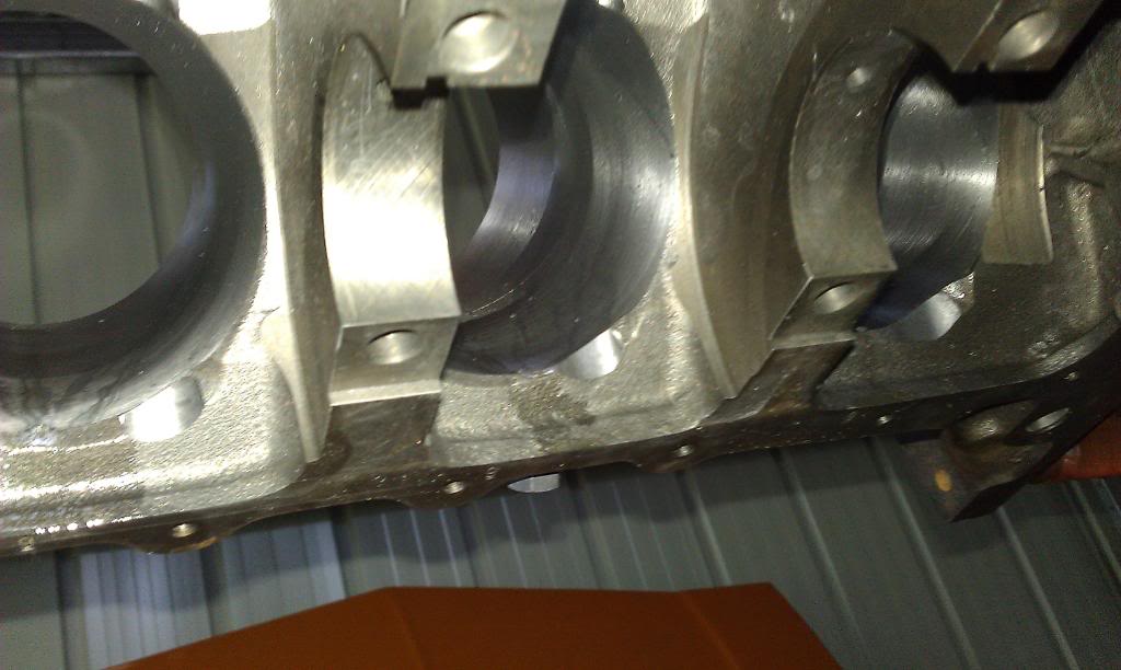

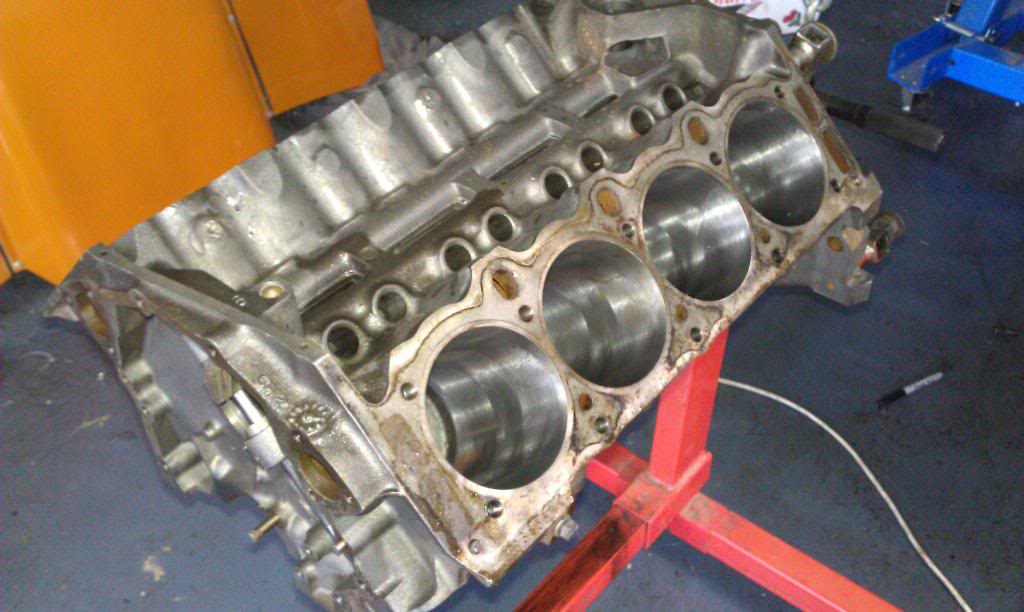

#454 MRLXSS
Posted 21 December 2010 - 06:12 PM
I know, not much to look at, but it makes me happy!
Now to dummy assemble over the Holidays!
#455 MRLXSS
Posted 28 December 2010 - 06:30 PM
All Dummy assembled up. Checked all the clearances and deck heights etc...
In the new year, the block will get decked and bottom end balanced! Then its just the heads that gotta be done!
God it looks sexy! to me anyway!

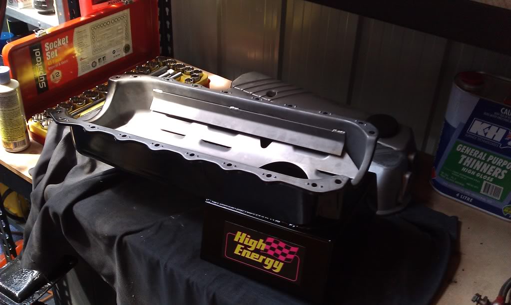

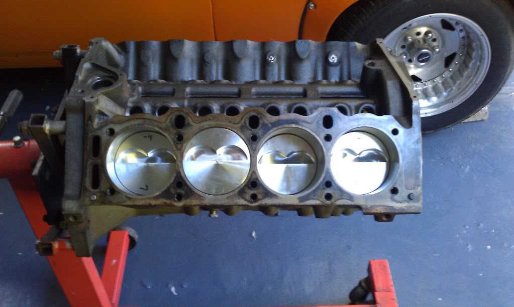

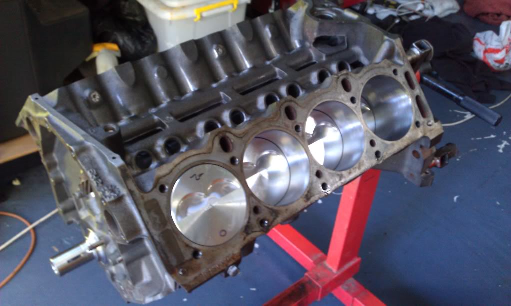

Well, slight update.
Got my cam specs last night. Now Remember, I'm not trying to make maximum peak power, I am aiming for lots of midrange torque and driveability. I don't want to have to spin it to 7000rpm+ as 99% of my driving will be on the street and it will never see those kinda revs. I'm aiming for 425-450hp with 400+ ft/lbs of torque as well.
Static Compression I think is around 10.8:1
Heads have been pocket ported (VN Heads). Apparently should be flowing around 540hp now?
The Cam is a Solid Clive Cam
Here are the specs
Lobe Lift
Ex .326
In .326
Timing Ad
Open Close
85-43
45-83
Duration
239
239
Valve Clearance
.015
.015
Valve Lift (With my 1.65:1 Rollers)
.526
.526
Wade Cams have a very similar cam and says the rev range is 3600-7000 Rev range on a 308, so a 355 it'll be more like 3100-6500. Which is pretty much exactly what I asked for.
http://www.wadecams...._2 ... pfi).htm (341c Cam)
Also got my High Energy Sump, just got a Super Street One, it looks the goods and Im very happy with it! I think I might drop the T700 off to the trans builder next weekend and get that underway.
I'm pretty excited about it all! My bottom end and heads are a bit over-kill for my initial set-up. I thought I might as well do that right now, as oppose to having to do it all again in the future. I'm just excited as to start having a crack at breaking into the 11's!
