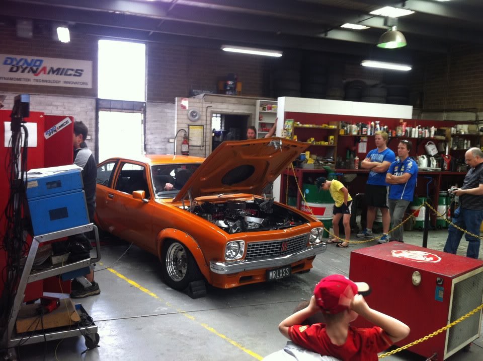

Well, results are in!
She pulled 235rwkw (315rwhp), which I was really happy with seeing the carby is straight out the box! The A:F ratios were as flat as anything, you could almost run a ruler over it! They were probably a bit on the lean side though, I think they were about 12.4:1 and I've set my dizzy up at the bottom end of the range suggested, I have about 4 more degrees to play with there if needed.
The engine is also only about 800kms old! So it should loosen up a bit more too!
I want to eventually get closer to 350rwhp, but first time on the rollers I'm really happy with that number!

HAHA! Funny you say that, we had the Guess the HP prize on the day to raise money for the club... With closest to the number winning a $50 Dan Murphy's voucher!
3 People Guessed 235kw! haha... (Probably helped that I was telling everyone it'd probably be between 220-250rwkw... 235 is bang smack in the middle!)

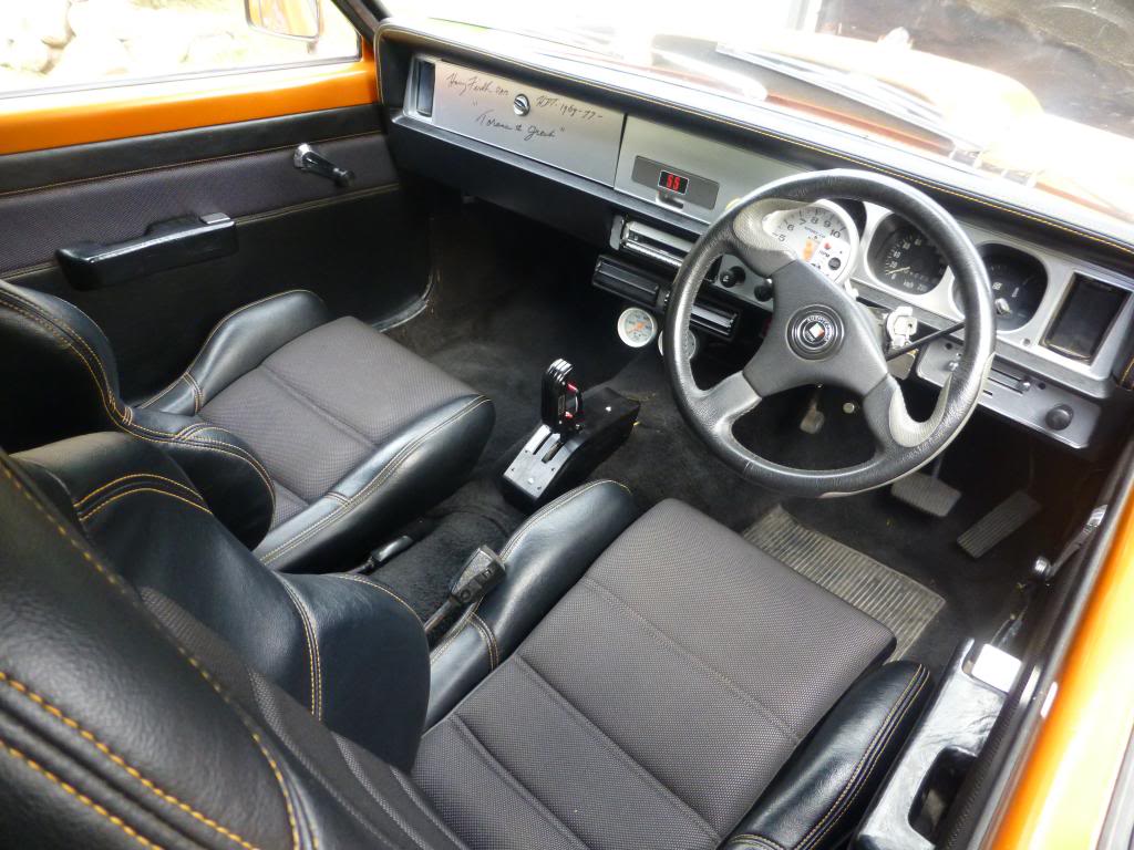

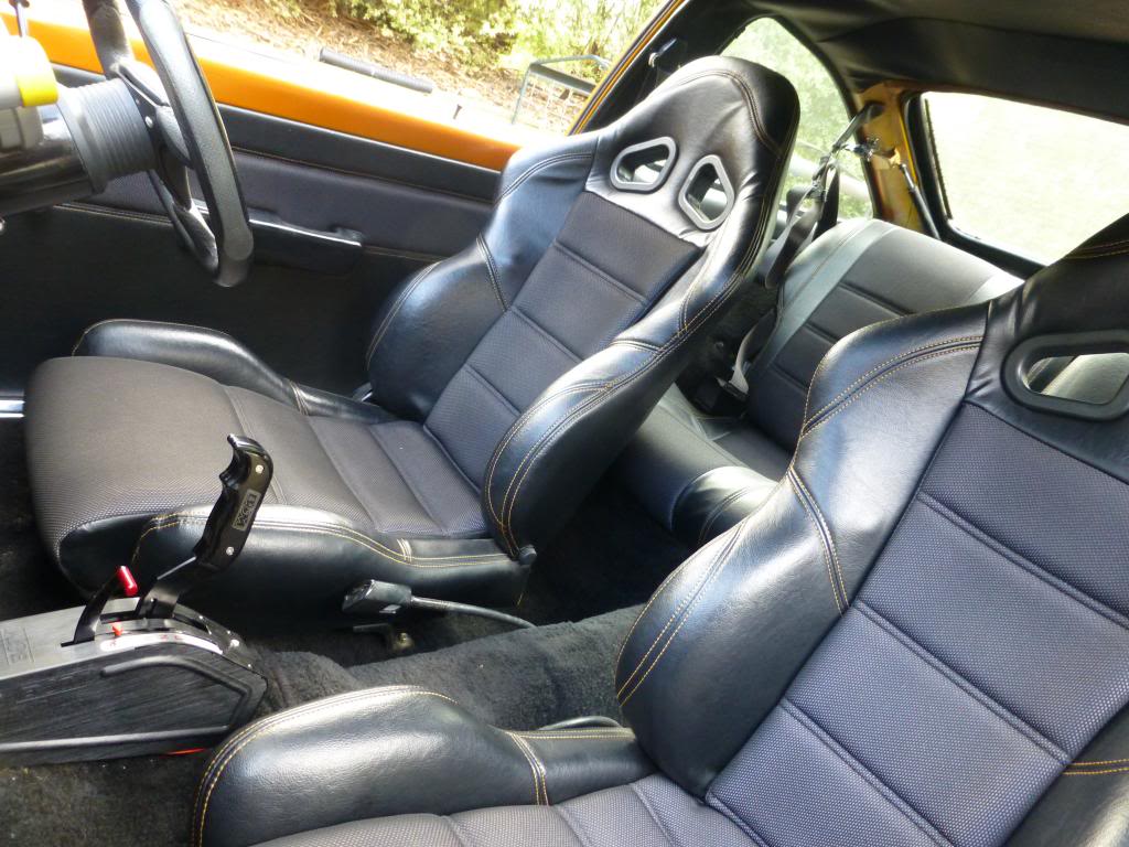

First up, new shifter & cable... I was sick and tired of the old Megashifter... I could never get it set up right (Since found that it was the old melted cable that would have been the problem). But I didnt really like the V-gate style and really wanted to get a ratchet style shifter.
So I bought a B&M Stealth Pro Ratchet Shifter from Summit. This time around I spent the extra time mounting it properly so it wouldn't come loose!
I also vacuumed the car for the first time it ages! It scrubs up alright I reckon!
Anyway, here are a few pics!
