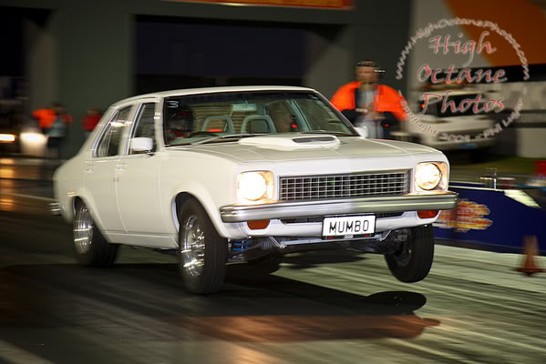

#172 _mumbo_
_mumbo_
Posted 27 January 2010 - 09:24 PM
You make a good point Tiny, thanks guys, i think you guys are swaying me to the cheaper option! (How rare is that!)
Might tell my mate with the spare 308 block that i want it!
My life goal is to get MRLXSS doing wheelstands... Or at least to lift a front wheel... Should i be able to do this with a nice 355?
330 holden strocker soon to be replaced with std stroke 308
This is leaving the line at 4000rpm next time it will be 5200rpm
