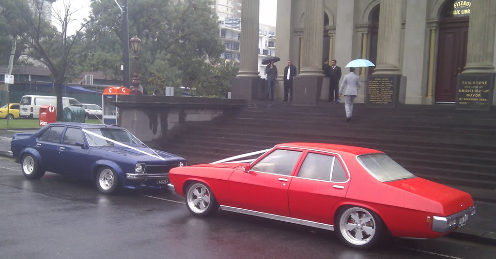

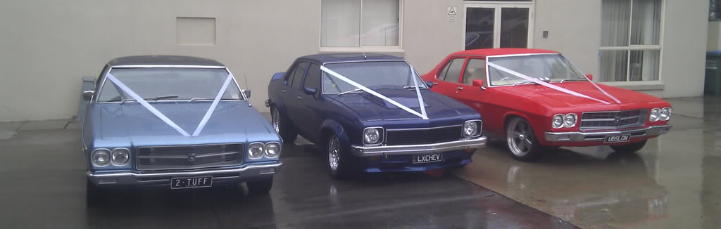

On another note - guess what guys, Rick (TORANR AMORE) tied the knot last Saturday. (Congrats RICK!!!). I was lucky enough to chauffeur him to the church. He had a nice line-up of wedding cars (thanks to the boys from Eastside Cruisers for offering their rides)....

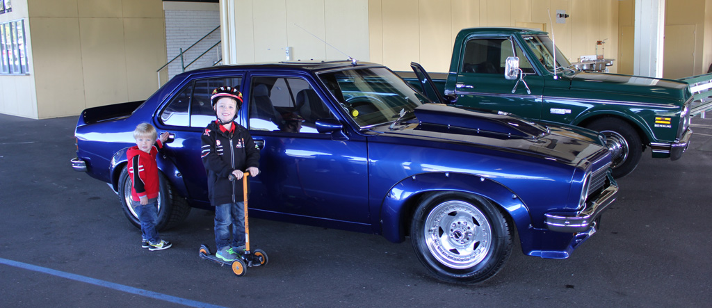

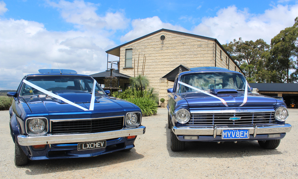

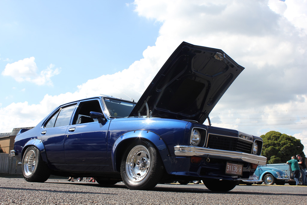

Here's some random photos from recent times, just out and about having fun.....
The kids are growing up real quick, and we've been involved in some weddings which is always great fun....
