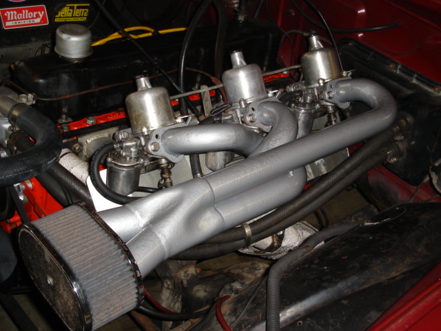

G'day, been reading this with interest! One question, that heat sheild, is it an ACL? I've not long fitted one under my SU's with next to no difference... even the shield gets bloody warm. I have drilled and tapped the inlet manifold to screw it to, not touching the zorst anywhere, still loads of transferred heat. The first sheild I made was .8mm ali. The fancy... expensive ACL is no different! I'm about to try an 'exhausting' type situation...  from the pipes to the guard flutes.
Thoughts please?

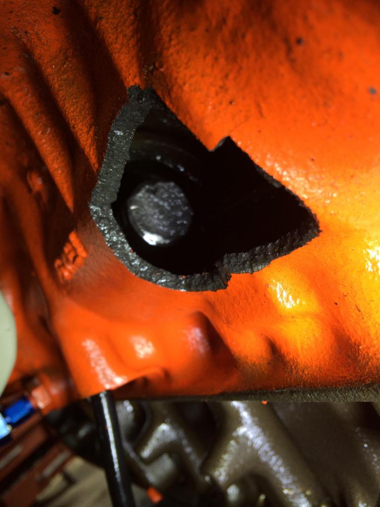

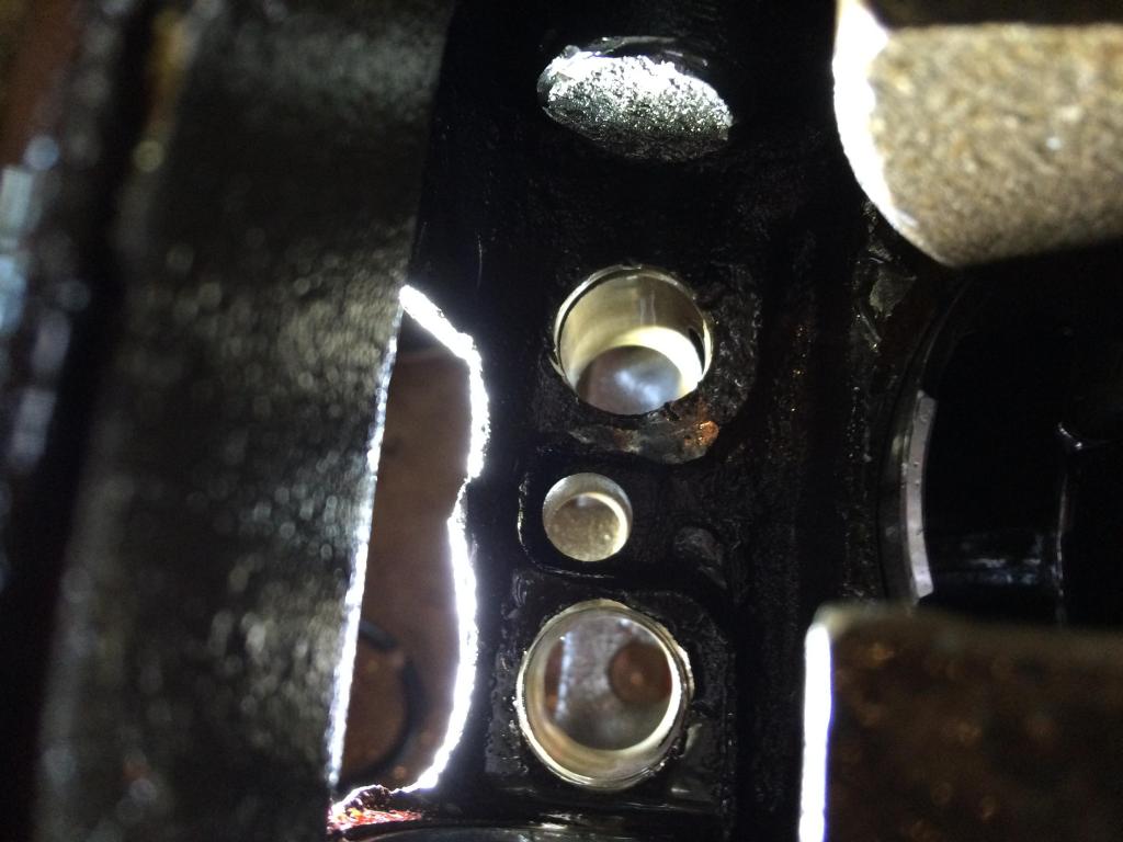

Went to a TnT last night and in the burnout it spat no6 intake and exhaust lobe and their lifters out the side of the block!!!
It was only doing 6800 in the water.
It was still running on 5 cylinders with no oil pressure...........
From what i can tell its just fatigue/too much spring pressure, cast cores normally break behind the first cam journal though which has got me stumped.
Undecided as to whether to put a lazy flat tappet back in or go a to a roller

Wow that is REALLY $hit Kev!
I guess we need someone casting up billet alloy holden 6 blocks now...
So... what did it run on 5 cylinders???😝

who built your motor kev.i would ask for a refund.

That Cam was brittle to break like that, don't you think?

Yes dave I was definitely pushing the boundaries.
400lb open and the core measured .870.
Lol Jason.... I build my own.
Nothing SA EH, I shut er down soon as I saw the light.

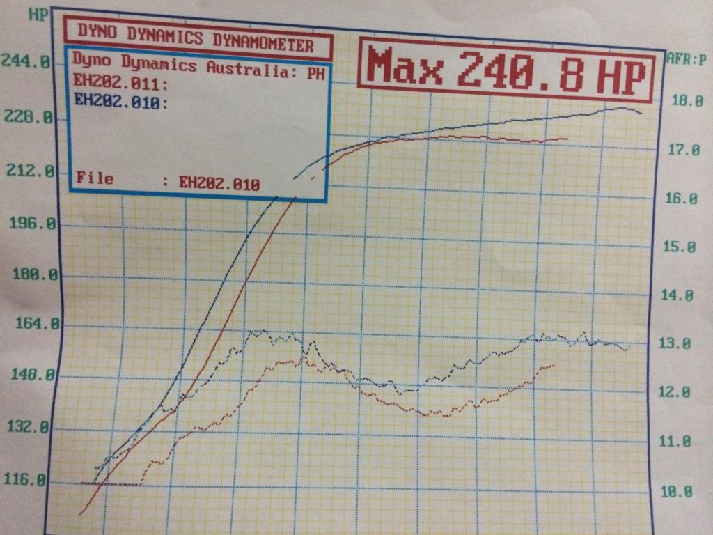

CEE47994-89DF-4FBC-8AB0-89BD419C0507_zps
Blue line is 19.5 in runner length
Red line is 18.5 in runner length
Ran out of spacers after that, peak was at 7000

The runner length certainly made a big difference in the mid range.
Where are you measuring from, the head to the intake side of the carb or the throttle side?

From the valve to the bell mouth.
I've got to get the other sheets when I get a chance, with 17.5 length the curve was considerably worse

I had 17.5 as well with 6 inch ram tubes. No difference felt going up from 3" tubes. Now I have a 29" extractor style inlet, from the carbs, with a Weber filter next to the battery, and the difference was surprising. Far better than ram tubes or the airbox I used to have on it. Initially I made it for a totally different look and when I tested it before finishing I felt a lot more pull from quite low down right through to around 5000. The 3.55 diff feels too low, but the soon to be installed BW will get 3.45 gears so should be better again.
http://oldholden.com/node/107461
Page 2, from post 42 - http://www.gmh-toran...u-set-up/page-2

That's a really good comparison to show Kev, I bet you got a heap of fellas grabbing the measuring stick & walking to their engine bay, I know I did.
Still impressive figures mate.
#243 N/A-PWR
Posted 30 August 2014 - 09:24 PM
Dave,
Your Extractor inlet Ram Tubes are amazing:-
http://www.gmh-toran...e-2#entry722566
thank's for posting,
and I gave you a Like Button for this.
