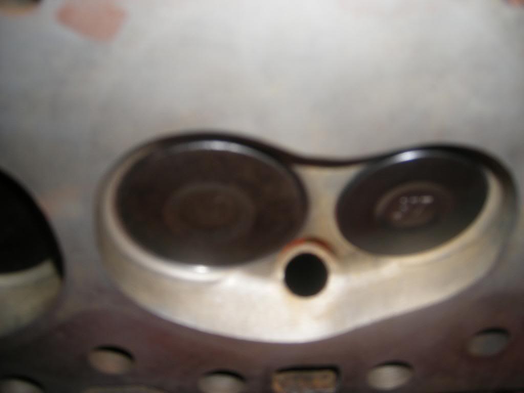

This is the chamber of the head on my motor. Motor is 186 block with 202 crank. Compression ratio is 10.2 to 1, after some machining of piston tops. The head had been shaved quite a bit.
Well i know my engine or head has been reconditioned at one point, because it has a reconditioning sticker on the rocker cover, so i might discover some more surprises with the car... The plot thickens.
If i can get it all sweet, this should be a fast little rocket, hope i don't run into any issues with it though... Just want to bolt it on and get it going!
And yeah i already so run it on premium unleaded.
Hey, half the fun finding out about your motor. I think it will go very well actually , great combo. What Crow cam did you end up with?
