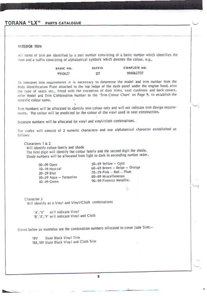

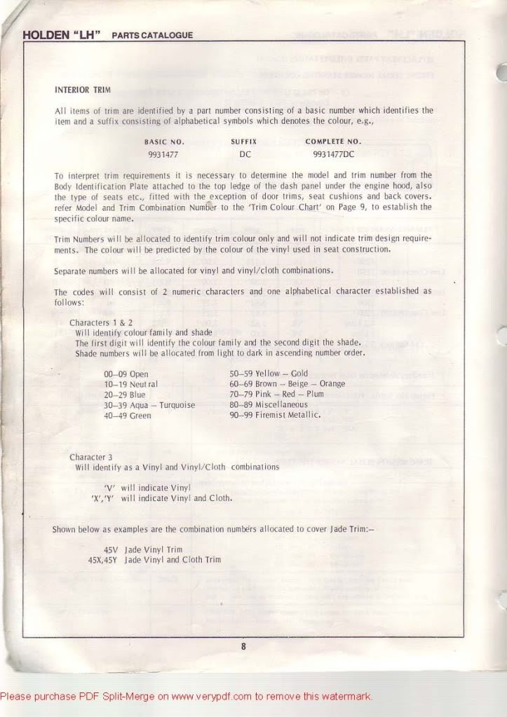

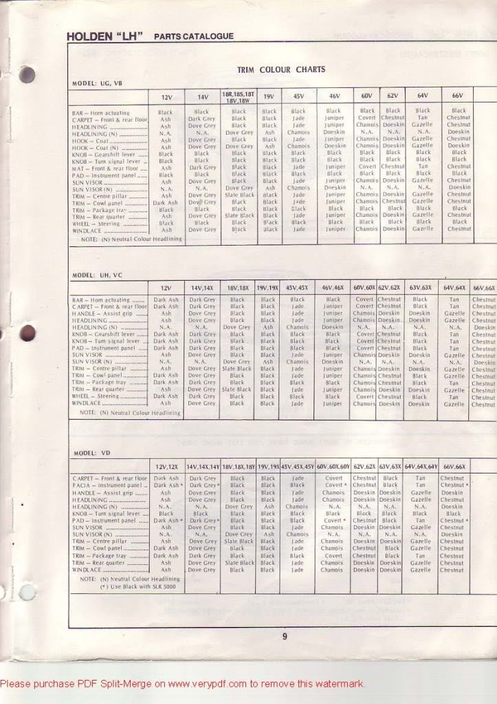

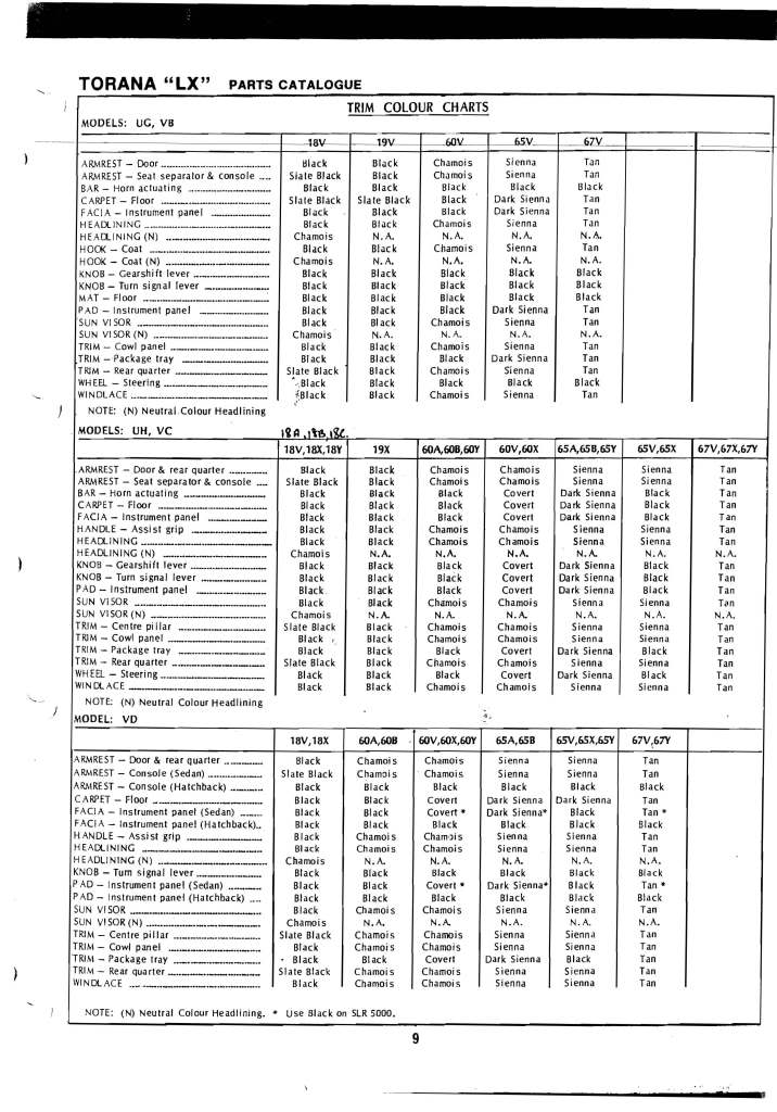

Posted 23 February 2010 - 04:16 PM
Hows that Col?
Edited by darrenmark1, 23 February 2010 - 04:17 PM.
#7 _darrenmark1_
_darrenmark1_
Posted 23 February 2010 - 04:47 PM
Got the LX one to Col...
Amazing what you keep..
Hope that helps

#10 dattoman
Posted 05 March 2010 - 08:56 PM
Hiya Rebecca
67Y on an SS... thats VD style in the listing above
Doesn't say up there does it
I'd guess golfball... but theres smarter guys here than me that will give you the right answer
#11 _sstorana_
_sstorana_
Posted 06 March 2010 - 12:15 PM
Close Datts!
67V is Vinyl,
67Y is Cloth

Mine is 63V but what do the numbers before the 63V indicate for example 1880-63V ?
Ken.
Check out posts #6 & #7.
#22 _LH8VD69_
_LH8VD69_
Posted 23 November 2010 - 09:23 PM
Ken.
Yeah mate perhaps u see it differently but its pretty vauge. Better than nothing for sure but i still can't picture my interior in my mind. Thats why your earlier post of the burgandy LH along with the build plate n pics was excellent. In the chart where does it say door trims or seat colour. Yeah its prolly starin me in the face i just dont see it. I think we should be able to ask whatever questions we like in this thread (that appears to be going nowhere btw) to make things clearer for ourselves but the mod should come along and clear em all up leaving only the posts like the one you left b4 as they are what we actually want to see. Plate pic , interior pic.
#23 Statler
Posted 24 November 2010 - 09:40 AM
Going off the chart listed above, 63V is 'doeskin' with vinyl seats from the LH range. That's my interpretation anyway.
