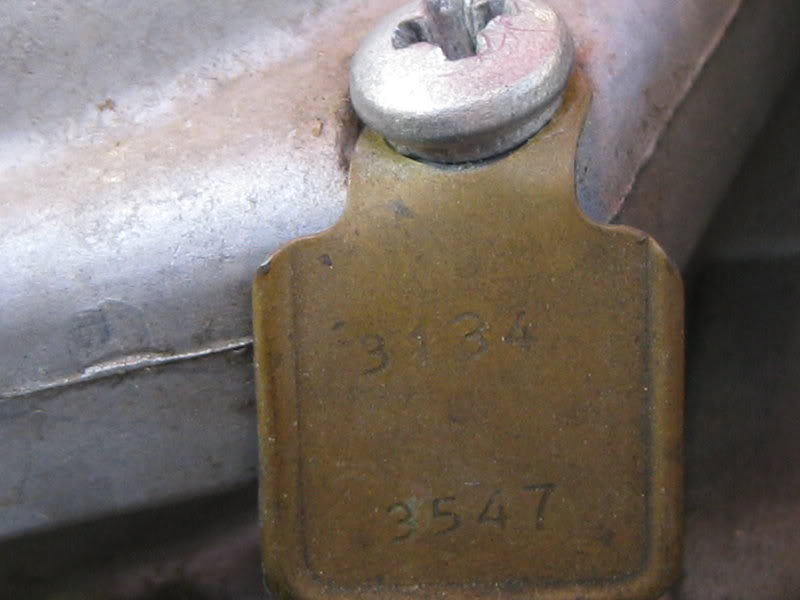

From what i can work out the first 300 LJ XU-1,s ran the 949,s (3521). These 300 LJ XU-1,s have ADR,s of 1/72, 2/72 & 3/72.
While the second lot of 300 LJ XU-1,s ran the 226,s (3547). The first batch of 226,s have a cast date of 1-72 and were used on the cars with ADR,s of 4/72, 5/72, 6/72 & 7/72 from what i can make out.....................

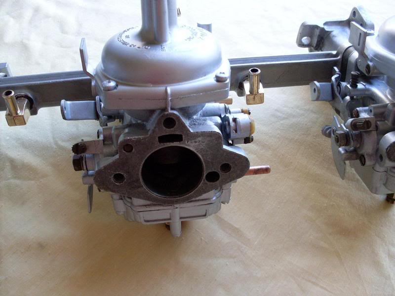

In the middle of restoring my T226 set up and discovered when cleaning them there is a hole on the choke bracket side,2 of them were blocked and one was unblocked,which should be correct,blocked or unblocked???
Can everyone help,......Bruce?? Attached File  101_1518.jpg   35.89K   81 downloadsAttached File  101_1519.jpg   31.75K   97 downloadsAttached File  101_1520.jpg   42.44K   78 downloads
#33 FLY_AGAIN_XU-1
FLY_AGAIN_XU-1
  • Banned
  • 1,653 posts
  • Joined: 01-September 06
Posted 28 October 2009 - 09:31 PM
Unblocked for me Dane,o !!!! Though im hoping that someone that owns one of these cars can verify this for us...................

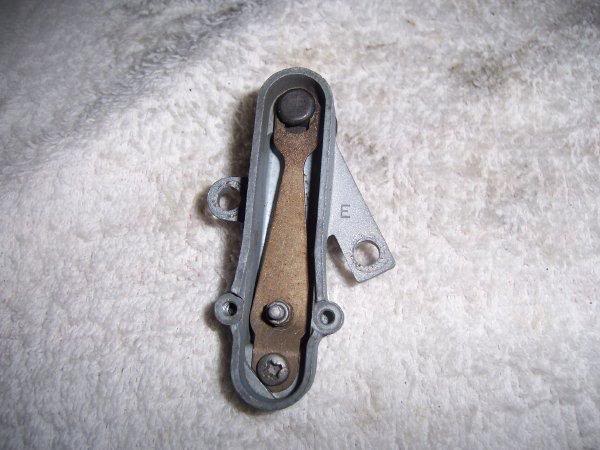

#35 _sunburst73-xu1_
_sunburst73-xu1_
Posted 29 October 2009 - 05:59 AM
Cheers Bruce and Johno
Johno in regards to the compensators mine has a E stamped on all 3 of them( see pic to make sure this is what you ment)wheather there the right or wrong ones I couldn't tell you.
cheers Dane
Attached File  101_1521.jpg   57.47K   24 downloads

the compensators on my 226 set all have the letter E on them
my set of 949s have letter S x2 the other is F..

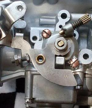

All LJ XU-1 CD 175 stromies have the letter E on there temp compensators and the letter W on there choke brackets. From the early 949,s right through to the 1973 Bathurst T226,s.

The holes in mine were open when I bought the car many moons ago. Some years ago I had my T226s rebuilt by a workshop that specialised in carbies and I had heard good things about this establishment. They looked classy and the dude said they were set for first start up. JP started easily enough but then there was a very strong smell of petrol - the first carby was pissing go juice out that hole onto the exhaust manifold. I was very fortunate that the manifold was relatively cool so no fire. Took that carby back to the dude - he knew straight away what the problem was and he fixed it in a few minutes. I asked him if these holes should be plugged and he said no.
I will never go back there.

mine are all open aswell, i thourt thay where to support your float levels,, and not only that, this is another way of telling the diffrance between the 73 and 72 carbys with-out taking the aircleaner off.

Sunburst , from memory the jet brass fitting at the very bottom of carb was screwed right up - should be two and one quarter turns out after it touches a valve . As for the hole , if this is plugged the carb wont operate correctly , something about needing to breathe through it .

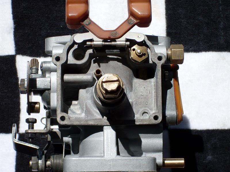

ok here you go, im at the moment in the middle of putting together 3 sets of carbs, those holes are breathers, and it was commen for people whom didnt know what thay where doing to block them of when leaking, these will leak when
1- the float is not sitting correctly
2- when you have restored your carbys and forgot to clean properly
3- when you have shit in your tank
4- when the seat is folked.
this was a commen problem, but is a easy fix, the hardest part of fixxing this problem is taking the carbys off....

if you get dirt under the needle and seat fuel will come out of the hole,
one day i put new fuel line on and there must been a bit of shit in the line and it leaked,
had to pull carby off and clean needle and seat, some rally cars put a copper pipe in the hole to stop dust getting in float chamber

Just to reconfirm with the fuel coming out of the hole thing.Its down to the needle and seat being right.Just finished tuning my motor to put in my car and the carbies on 2 occasions it happened and both times it was to do with the needle and seat.
