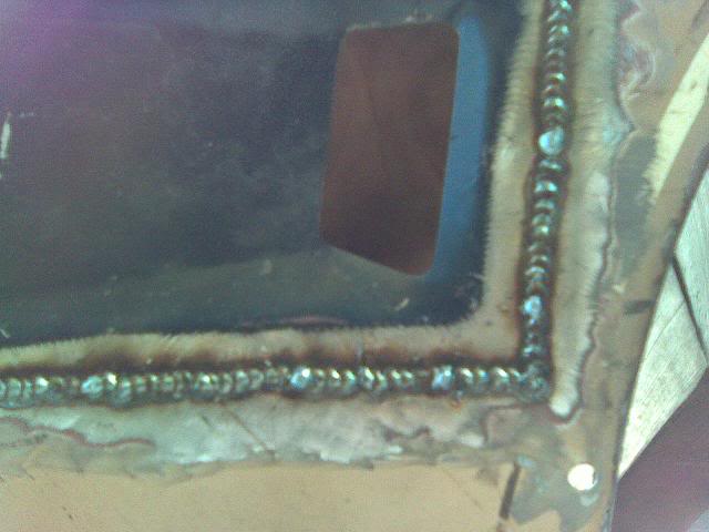

Hey all... Ok well been doing abit of welding of late and am getting better... just 1 problem... When Im doing the tack tack tack... cool.... tack tack tack... cool... method (buttwelded sheetmetal together) the first tack I goto do is always crap, when I pull the trigger it goes, bang bang bang (splat splat splat) then ZZzzzzzzz and does a weld... but then if I do the next tacks pretty quickly (withing say 10seconds) they just go Zzzzzzzz... Zzzzzz... Zzzzz perfectly.... but then if I wait too long, 15seconds Plus... once again the first tack goes pop pop pop zzzzz...
Any ideas?
Here's my latest effort

Is the gas is leaking out of the line?
#42 _Viper_
_Viper_
Posted 02 January 2010 - 09:03 PM
Hmm I dont think so, Even with the welder turned off and the valve on the bottle shut off and left overnight the guage still reads full pressure...
I also tried pressing the trigger abit without actually creating an ark to sorta get the gas "primed" but was still the same... Im leaning towards a wire feed problem? how do you know if you got the correct tension on the feeder?
#43 rodomo
Posted 02 January 2010 - 09:05 PM
Looking at your weld I would say turn the amps up or the wire speed down, try wire speed down.
#44 TerrA LX
Posted 03 January 2010 - 01:22 AM
I carry an old pair if side cutters on the mig and snip the end off the feed wire for a fresh start.

With out reading the whole thread if your getting wire then your wire feeder is fine,
porosity in your welds can be caused by several things.
moisture or surface contamination these i dont think so im sure your metal has been cleaned free of paint and rust,
flow rate to high or more likely to low just screw in the big black knob on your gauge until you reach say to 15 liters per minute.
excessive wind or air movement,
then again in your wire feeder there is a solinoid mind the spelling that i think will controlle open and closed on the gas, if you pull the trigger and get nothing at all then
you may need some repaires.
there are other small things that do affect gas shielding like gun angle and stick out but the welds look good enough from here.
with your wire feed as long as you pull the trigger and get wire you should be good.it should be able to handle a little resistance by hand.
hope this helps a little.

try starting each weld with clean wire, as in cut the bit of shitty wire of so that it is a clean start, but you should only have to do this after you have let it cool for a bit, if your doing tac tac tac it should be fine and shouldnt have to cut the wire at all, or another problem could be that when you strike the first arc there might be a slight delay in the gas, turn the mig off and put the gun near ya ear and hit the trigger and see is there is a delay between when you pull the trigger and when you hear the gas come through !!!!

It could be doing the splating because the steel has cooled down, ie if you insufficient amps. if you turned the amps up this may solve your problem but then it may be too hot. You will just have to play around with the settings, turn the wire down a bit. etc.
This is a lot more noticible when mig welding aluminium. The first part of the weld is always cold. Some high end migs have hot start to compensate for it.

Just saw an interesting tip for thin metal! Vertical downs are your friend, if you can get your work piece in a position to do it that is. Short of that, it is stop-start tacks.
Mmmm, interesting comments on wire feed. With MIG welding, wire feed affects the amount of amps pumping through the machine. Higher the wire feed, the more amps you are pumping through.
Amps with voltage settings needs to be balanced to get a good weld window. There are some combinations of voltage and wire feed where you'll get no good welds at all.
The difference between a good and a bad weld can be a poofteenth adjustment of the wire feed (AMPS). It is a very fine adjustment.

Sorry,
i was referring to setting the tension on the rollers.
Yes slr your amperage is set through your wire feed.Posted Image

A rule of thumb for wire tension is light presure on the edge of the roll of wire with the palm of your hand should stop the wire feeding and make
the rollers slip... don't continuely do this though as it will cause an excess of wire shavings to be drawn into your liner causeing grief... this
tension setting is for solid wire not cored.. the tension for cored wire is much less. a quick check for excessive tension on cored wire is
let a bit of wire feed out of hand piece it should remain straight and not curl up in a spiral, this is called birdcageing.
another tip to to regulary remove your hand piece cable from the machine, remove contact tip, lay it out straight and blow it through with comp
air from tip end back, it will remove any fines in the liner.
When welding always keep your cable as straight and not looped as possible.
Cable/liner problems can be the cause of some hard to detect/solve problems when welding.
Always make sure you have a good earth to this can cause stabbing at the handpiece.
