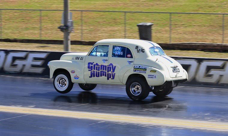

Grumpy Humpy ran 12.59 @ 107.4mph at the nostalgia drags on the weekend.

Posted 14 August 2012 - 12:59 PM
That's good mph.
Is this a stick car or bleeder?
#292 greens nice
greens nice
  • 1,011 posts
  • Name:Kevin
  • Location:QLD
  • Car:EH Holden
  • Joined: 01-November 08
Posted 14 August 2012 - 06:25 PM
That's good mph.
stick of course, runs a t5 and hilux diff.
#293 _STRAIGHTLINEMICK_
_STRAIGHTLINEMICK_
Posted 14 August 2012 - 08:16 PM
Thats a cool lookin humpy,would be cool as a road car,Mick
