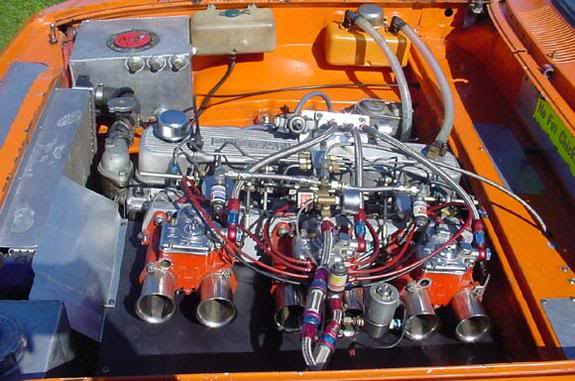

i've retired the banjo from service. there were some odd mods involved to get it to hold together. the 9.90 was more than it could or should have to deal with. with gas i've been using a B/W,seems plenty strong enough.as far as rear end suspension mods go its really very basic back there. std shocks, std lower springs,boxed arms and poly urethane bushes is all, just like the thousands of others out there.

Thats the one!
awesome launch nice and square not all screwed up like its going to turn itself inside out as some cars around do
cheers for the info makes the combo even more impressive.
did you run a rear sway bar?
if you dont mind me asking how much gas were you running?

is this your duggan headed motor?

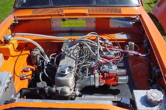

i thought this might be it from my memory but unsure. might give an idea of the amount of gass?

#108 hip6
hip6
  • 202 posts
  • Joined: 18-November 05
Posted 05 August 2010 - 10:29 AM
mine's the one with the gas,thats a pretty old photo, i've changed things around since then. 150hp max was all i could put through it, even then the poor cast pistons couldn't handle a full pass. there's 2 kits plumbed up but only 1 was ever used. the other picture looks like a circuit racer. there is a rear sway bar fitted also. being just a hobby, building it on a budget spending as little as possible and not taking it seriously,you should be able to go a lot quicker just spending a bit and using decent parts.

#113 hip6
hip6
  • 202 posts
Posted 16 August 2010 - 04:43 PM
a few more numbers i didn't mention,coz i thought yous were talking about N/A 9 ports, the same 9 port engine with 120hp gas ran 10.22 @ 129.7mph on M&H 265/55/15 street tyres back in 1997, the duggan headed engine with 150hp gas ran 9.79 @ 135mph in 2002 and 11.29 @ 118.9mph N/A with the 3.9 gears.
