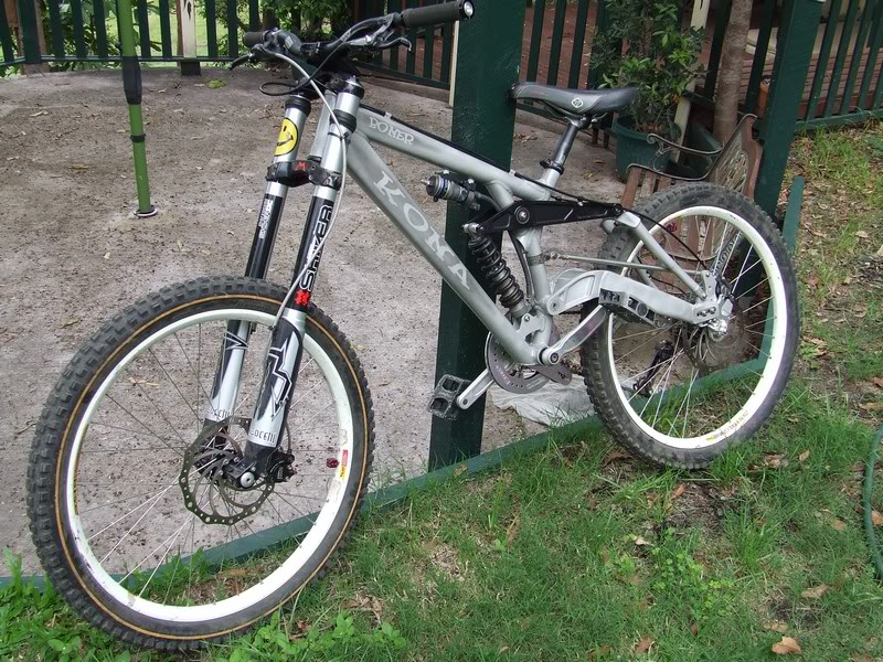

Off topic, But when isn't this thread.... Pics of said downhill Mountain Bikes!!!
Hi Mic.
My downhill bike is a 2003 Kona Stab Primo. I've painted it a couple of times, but the last (current) paint job is a funny one. I sandblasted the frame and rear swing arm, hand cut some stickers for the stencil for the new logos, dusted some black over the stencils to give some shading, then 2 pac cleared it. I like the finish. I also made a floating rear caliper set up. Made a big difference.
I also renamed it. It's now the Kona Boner : ) I'm such a child....
