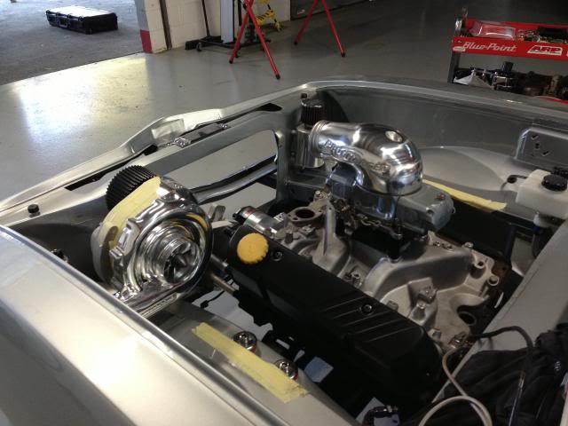

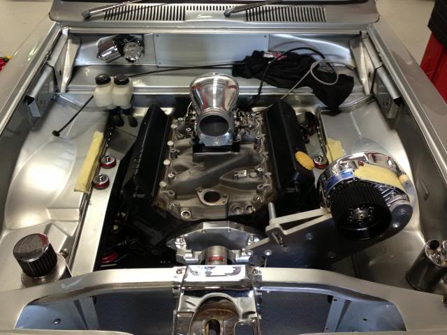

so this is where im at at the moment trial fitting the blower on my spare engine that will eventually be built for my hatch
just having a few clearance issues with bracket will sort that out and that can be finished
the crank is not far off being finished pistons are done block is 4 bolted and grout filled and we are still deciding on cam so progressing slowly IMG_2861_zps56834605.jpg

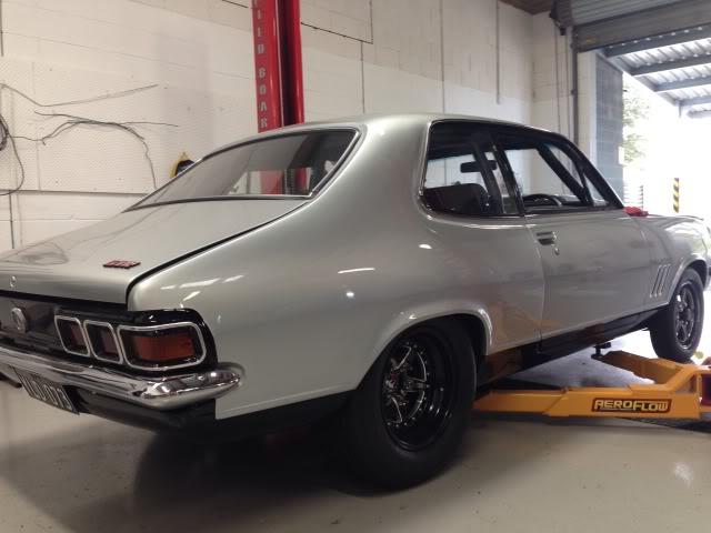

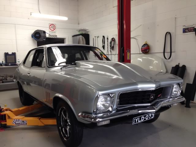

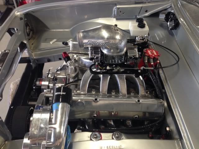

Hey guys been a while since my last update ! So I'm now on the home run getting this thing back on the road we had a bit of a drama with the bracket for the blower the first one was rubbish and didn't fit under the bonnet so we had a custom billet one made it fits perfect and is a work of art only problem now is we have had to run it non inter cooled there's just no way of getting the thermos between the motor and radiator .
The engine made 780hp on 10 psi @ 6000rpm so we will see how it goes at that later down the track we can add more boost
