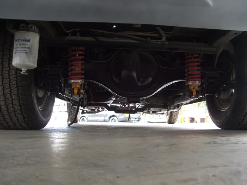

Hey guys bit of a update on the LJ rear end almost complete just brake lines to do then off to a few rust repairs and new paint finally getting somewhere !

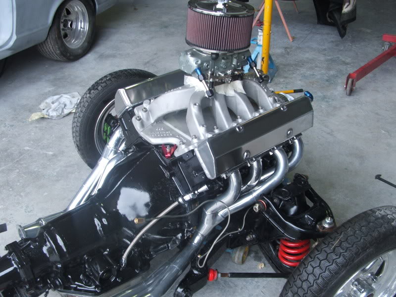

As i had issues with the old motor it was ditched and have a brand new motor to put in over the easter weekend heres what we have built
VT roller block
Harrop crank 355
Scat H beams
SRP forgies
Camtech custom grind solid roller
VN heads ported by super flow
YT platnum rockers
Match ported single plane torque power
750 demon
Complete MSD ignition
Still running the T350 4000 convertor
New 9'' housing tig welded
Moser 31 spline axles
Full spool 4.11
Mcdonald bros trailing arms
Spax coilovers
While the motor was out it was then decided to fix up the rest of the car properly
first i had it mini tubbed im now running 15x9 275/50/15 rears while i got the diff built i had it changed to disc rear end now has outlaw calipers VN disc got rid of the brake booster now using a willwood pedal box looks much neater

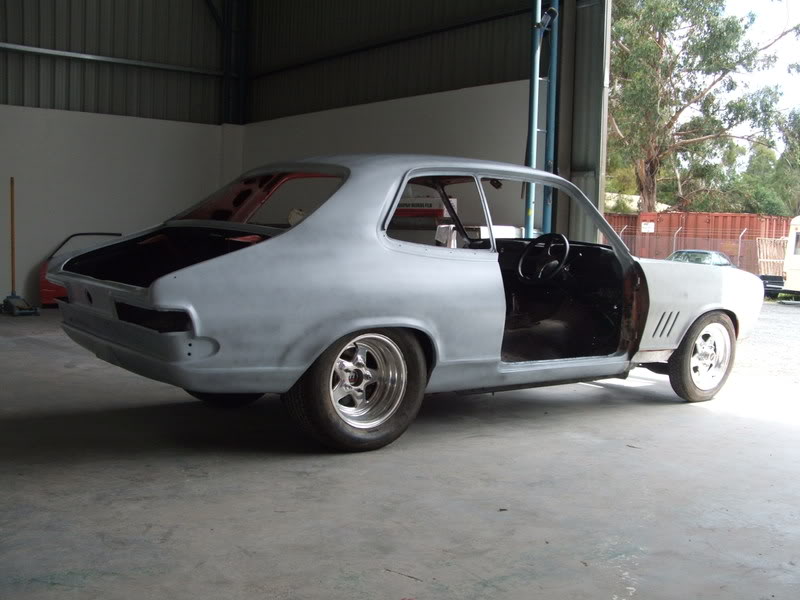

Then the car was sent of to panel and paint for a quick tidy up ! had a few rust issues to be fixed and i want a clean engine bay so all holes have been plated/welded we then decided to stretch the rear guards to fit the bigger tyres and to have it as low as possible so we have added 3'' to the wheel arch with all the panel work done the car is now in hi fill the engine bay was painted last friday and after a very long think about colours i have decided to go silver(toyota aurion) with the XU1 black outs so soon as the motor and box is in the rest will be sprayed

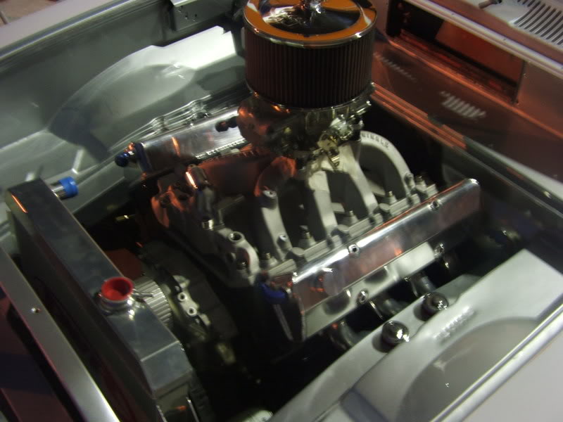

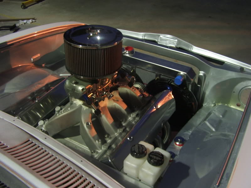

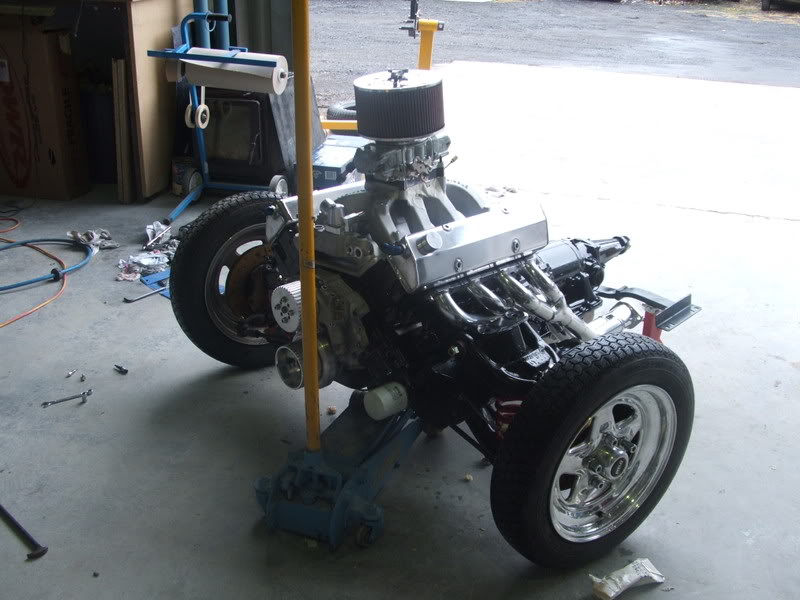

Ok time for a update new motor was finished last week so this weekend me and some mates had the joy of putting it in its new home all went in well cause the only thing in the car was the diff the front of the car is very light so 2 of us picked it up and and other mate rolled the front end complete with motor and box straight in easy as that ! so now its all back in now decided to have a andra approved cage put in which will be done this week then the paint work will be finished

Wow looks great! Fits in nice and tight too. I heard that you cant get the rails between the rocker covers. How much did the rails miss the rocker covers by wen you put it over the top?
