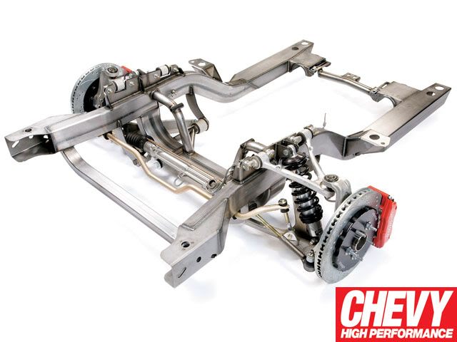

You've gotta love the aftermarket support for american cars, its amazing.
It is yummy
I would prefer NASCAR syle sway bars on it though
http://www.google.com.au/imgres?imgurl=http://image.circletrack.com/f/images/8996057%2Bw200/ctrp_0704_03z%2Bsoft_spring_setup%2B.jpg&imgrefurl=http://www.circletrack.com/techarticles/ctrp_0704_soft_spring_setups/index.html&usg=__Um7fS7bu_JmwPWOsMxXWQJyD6so=&h=150&w=200&sz=9&hl=en&start=14&zoom=1&itbs=1&tbnid=oXQyChN9gfsA-M:&tbnh=78&tbnw=104&prev=/search%3Fq%3Dnascar%2Bstyle%2Bsway%2Bbars%26hl%3Den%26sa%3DX%26rls%3Dcom.microsoft:en-US%26rlz%3D1I7GGLL_en%26biw%3D1004%26bih%3D610%26tbm%3Disch%26prmd%3Divns&ei=QYYKTrbZHO3RmAXjjeGTAQ
