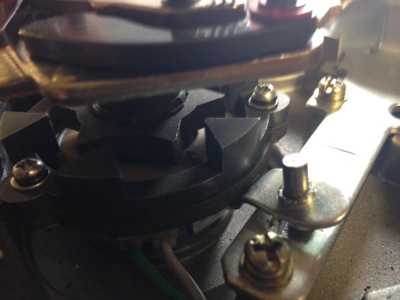

Hey Bomber, When the rotor and plug terminals line up the stator and reluctor points should also line up.
In the photo the rotor and plug terminals are aligned but as can be seen here the stator and reluctor are miles out. This happens when the dissy cap is turned 90 deg into the second locator (when the wires are above the vac advance not the wires coming out of the housing of the dissy)
#57 _Bomber Watson_
Posted 02 February 2015 - 05:05 PM
Why are you turning the dizzy cap 90 degrees to the second locator?
That would probably be ok on a V8, but with a six obviously its never going to work, you would only be able to turn it in 60 degree increments otherwise exactly what your picturing will happen.
After all, on a v8 you have one stator lug every 45 degrees, on a six you have one stator lug every 60 degrees....360/8= 45 360/6=60.
Is there any reason your not just using the dizzy cap where its supposed to go?
#58 _glennhailstone_
_glennhailstone_
Posted 02 February 2015 - 05:47 PM
Finally somebody who knows what I am saying, it doesn't make sense does it Bomber.
oldjohno said to put the wires above the vac advance not above where the wires come out of the dissy. But this puts the phasing out.
Anyway I tried both combinations and I had poor results with both cap set ups.
Yes the reason why I moved the cap was because it wasn't running properly with the cap in the correct position, so I tried to put it in the second locator, (which made no sense but I tried it anyway, and it did work, but still not running correctly. Sounds like its missing, coughing ect.)
Thats the nightmare Bomber, not the modifying the body to fit, thats easy.
Thats right, the pics in the first post show the cap fitted wrongly. The two notches in the body are a real trap. They're 90 deg apart so while it wouldn't make any difference with a V8 with a six it certainly does.
As OG says it doesn't matter where No 1 is but most people make the forwardmost terminal No 1 simply because it's easy to remember, plus it keeps the wiring fairly tidy.
