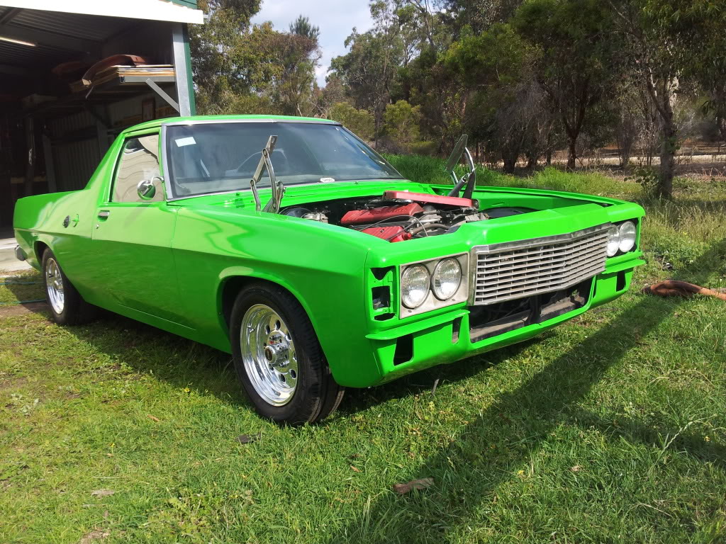

well, i know the torana has been avoided and left for months now, but i promise big things are coming for the ute in the post over the next few months and i am promising painted photos over the next few months

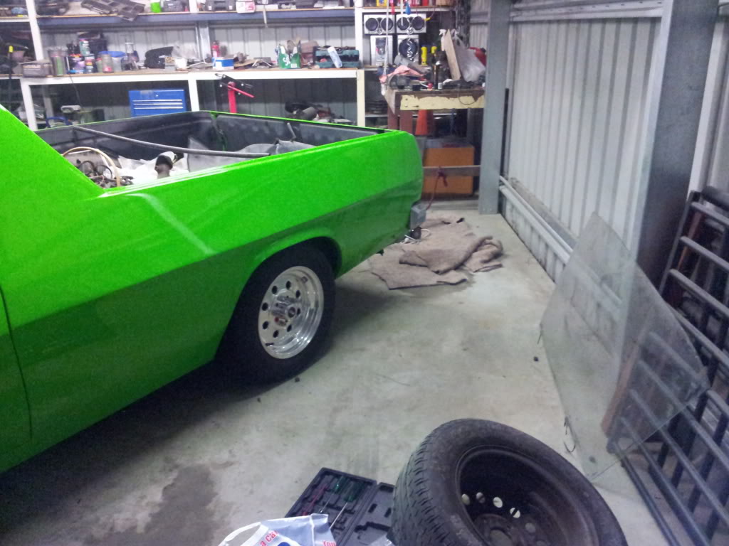

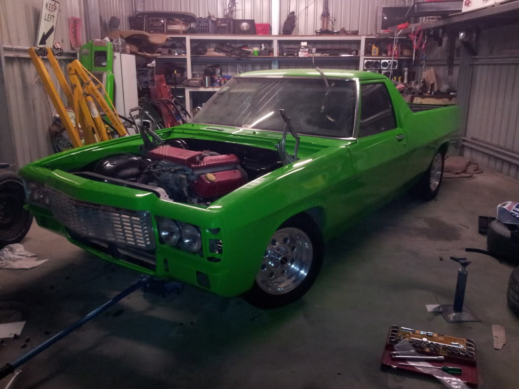

anyway the ute was smashed out today
got all the rubbers fitted up and aligned all the body, most of it is good except the front hand drivers guard which sticks out a little bit
im going to respray the light buckets silver with a black lip
new door seals, bailey channels and window clips
have to slam the door now lol

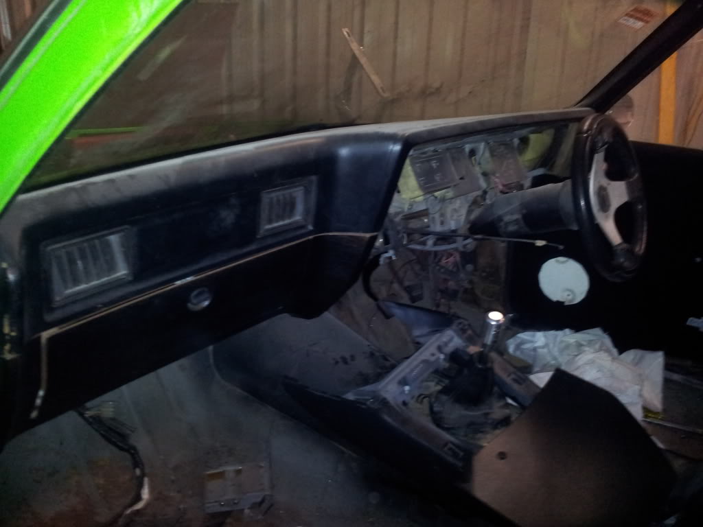

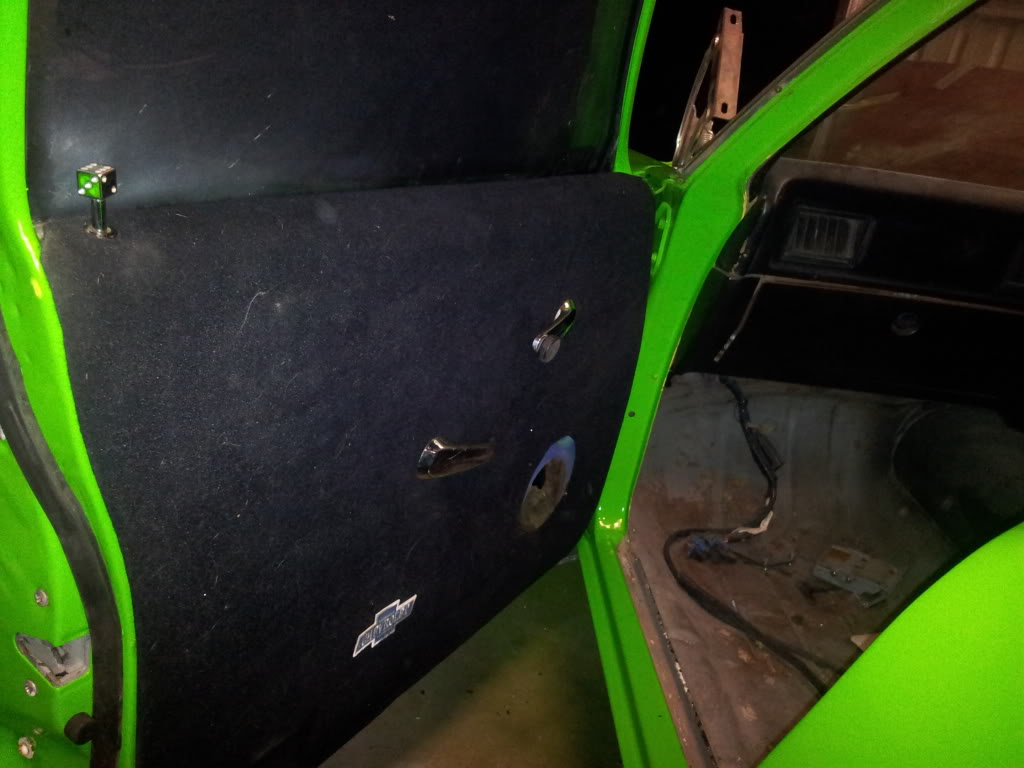

got the door trims fitted up, i know there is a chev badge on there but hey they look good though
hooked all the handles up and so on...
and also fitted some more stuff to the dash...
that VN commodore centre console is going to be modded fibreglassed and fitted later on, more on that alot later
and just coz these wheels are frOcking awesome :)

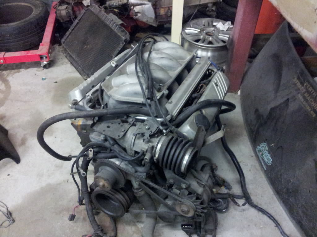

and i also dug out this for my uncles HZ ute.

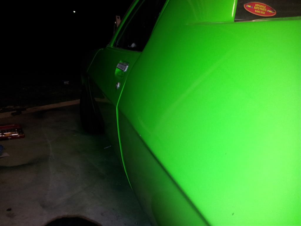

ya getting there Josh but can you get anymore adjustment out of the L/H door ?? its still abit out of wack :dontknow: other than that it coming together nice

thanks guys. nial8er i have a #@$^%& bearing or rubber in the door hinge so its making it drop i've ordered a new one so it will get replaced soon.

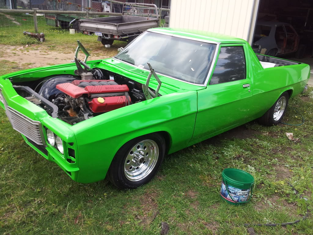

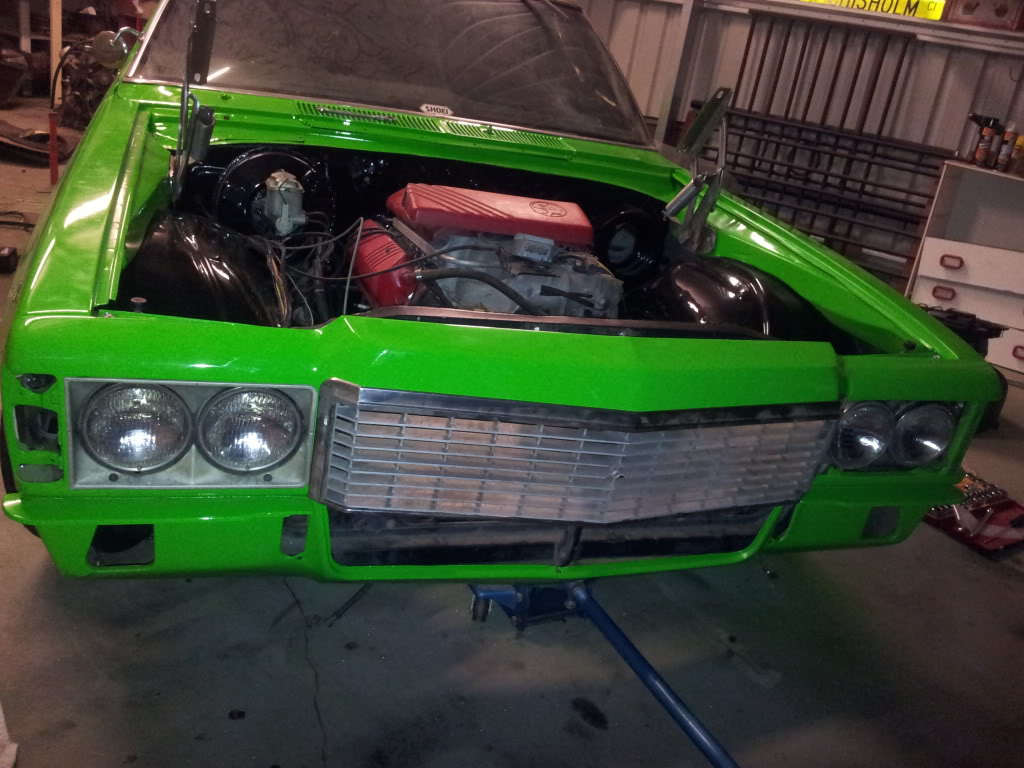

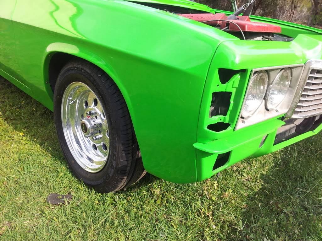

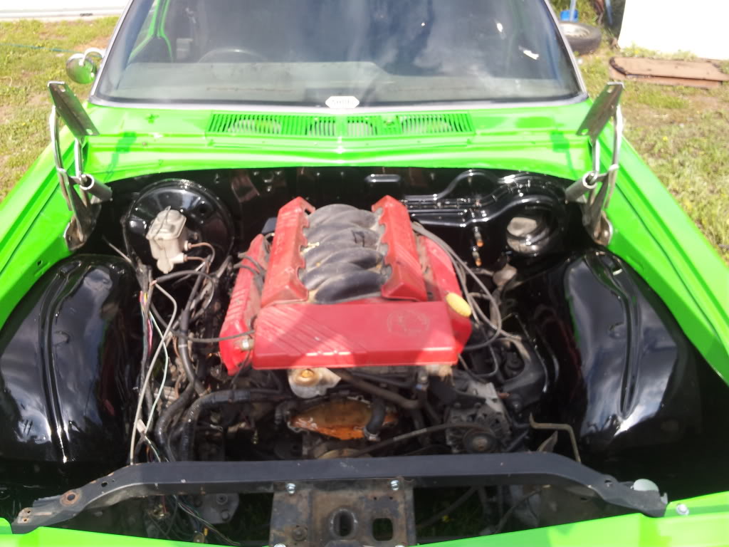

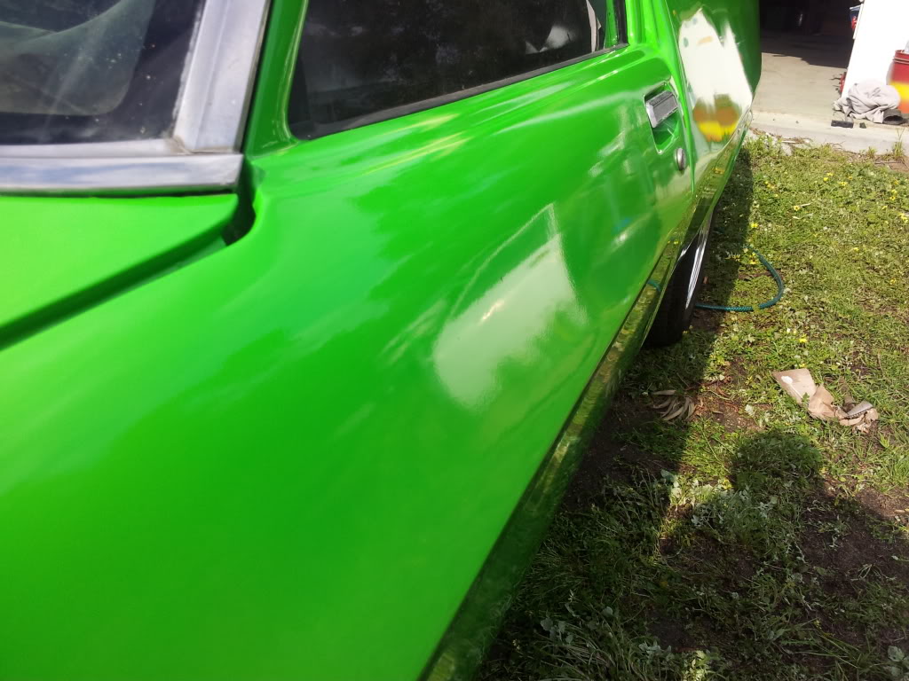

holy shite it got a bath after 14 months, still has overspray on the opposite side, so the whole car will cope a cut back and polish...
first time its seen sun in a while too...

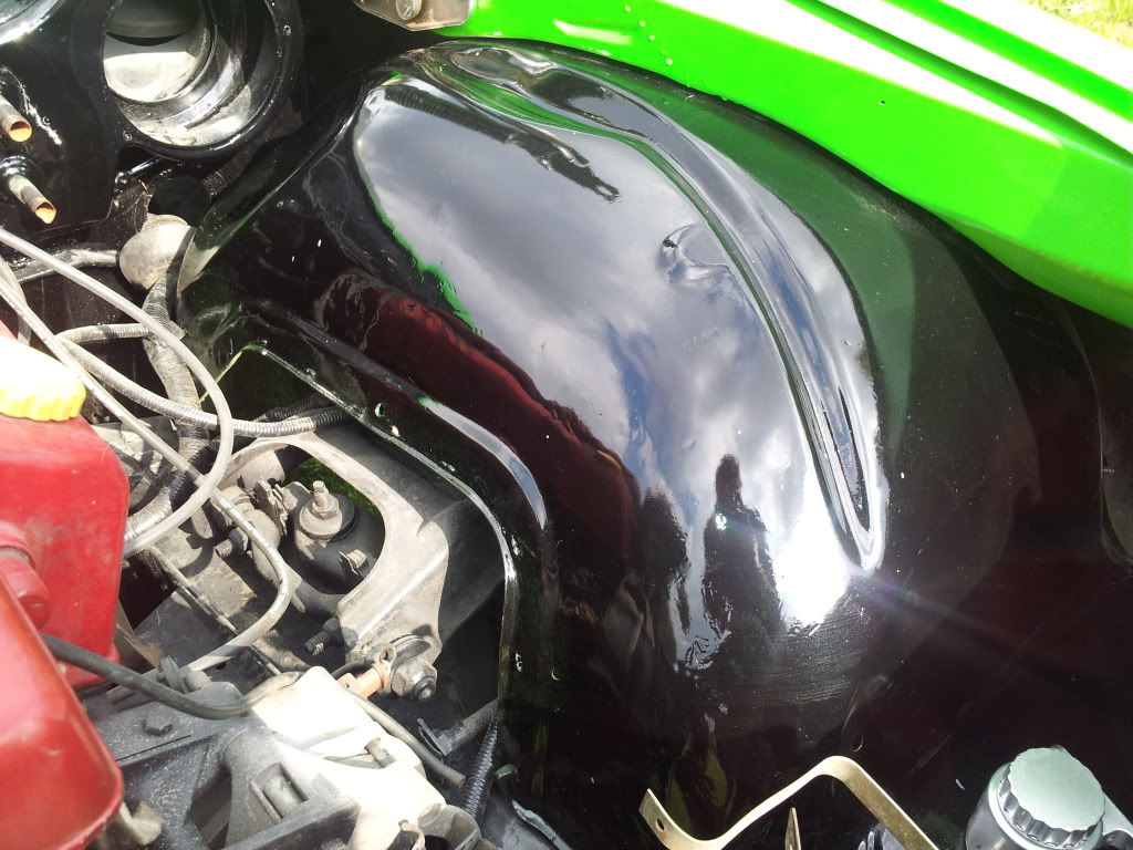

the bay looks good, just need to paint the covers and hide the wiring a little bit and she'll be nice
got a little bit of a surprise that'll sit on the manifold later on next year

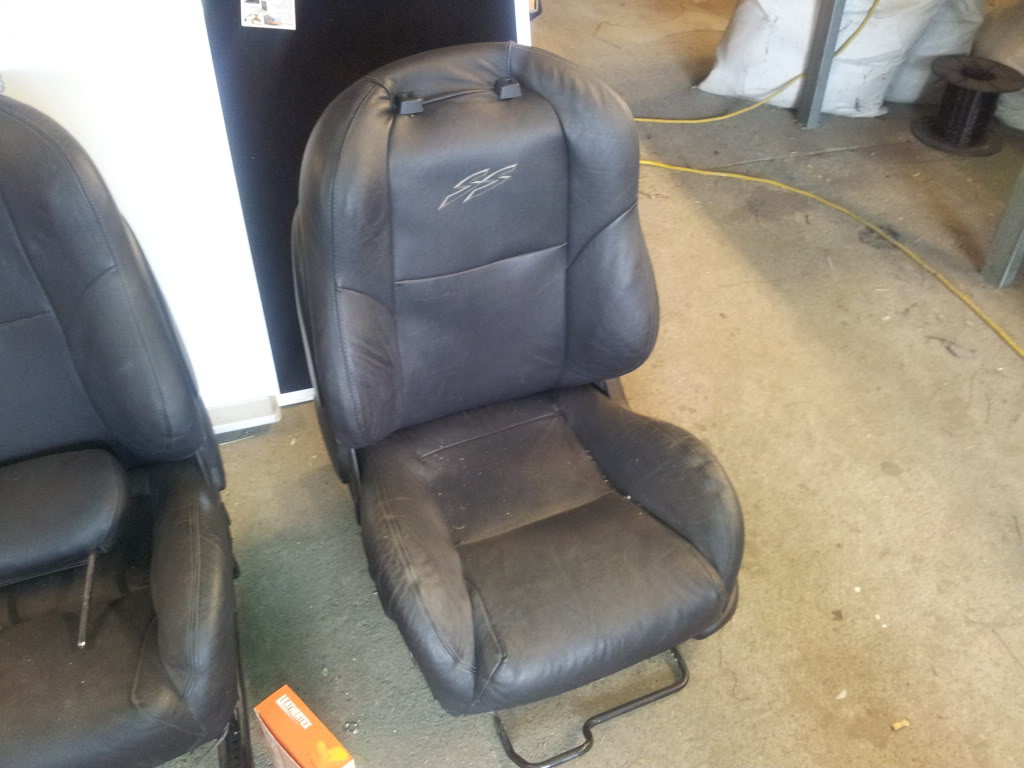

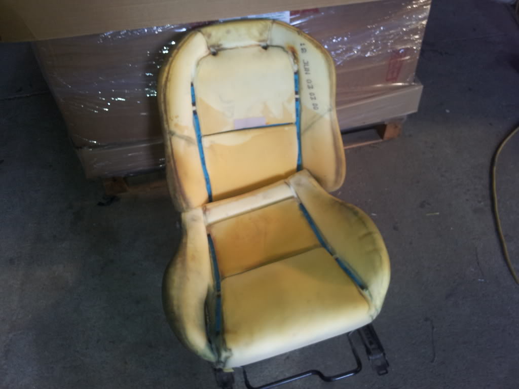

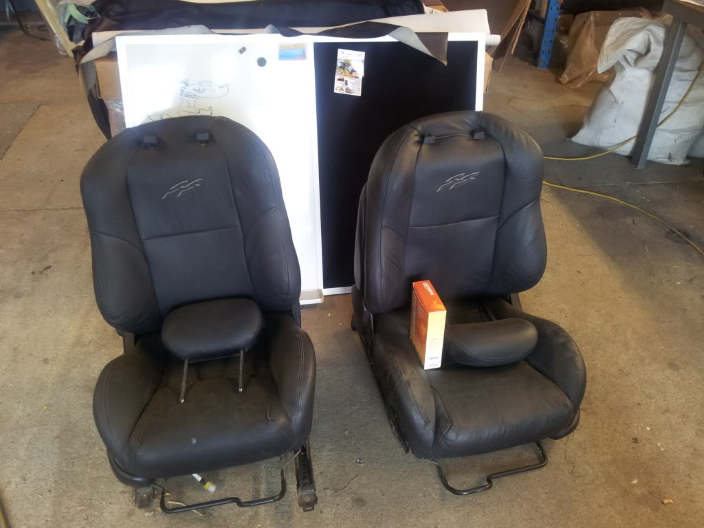

went to the trimmers too and he's progressed on the other seat

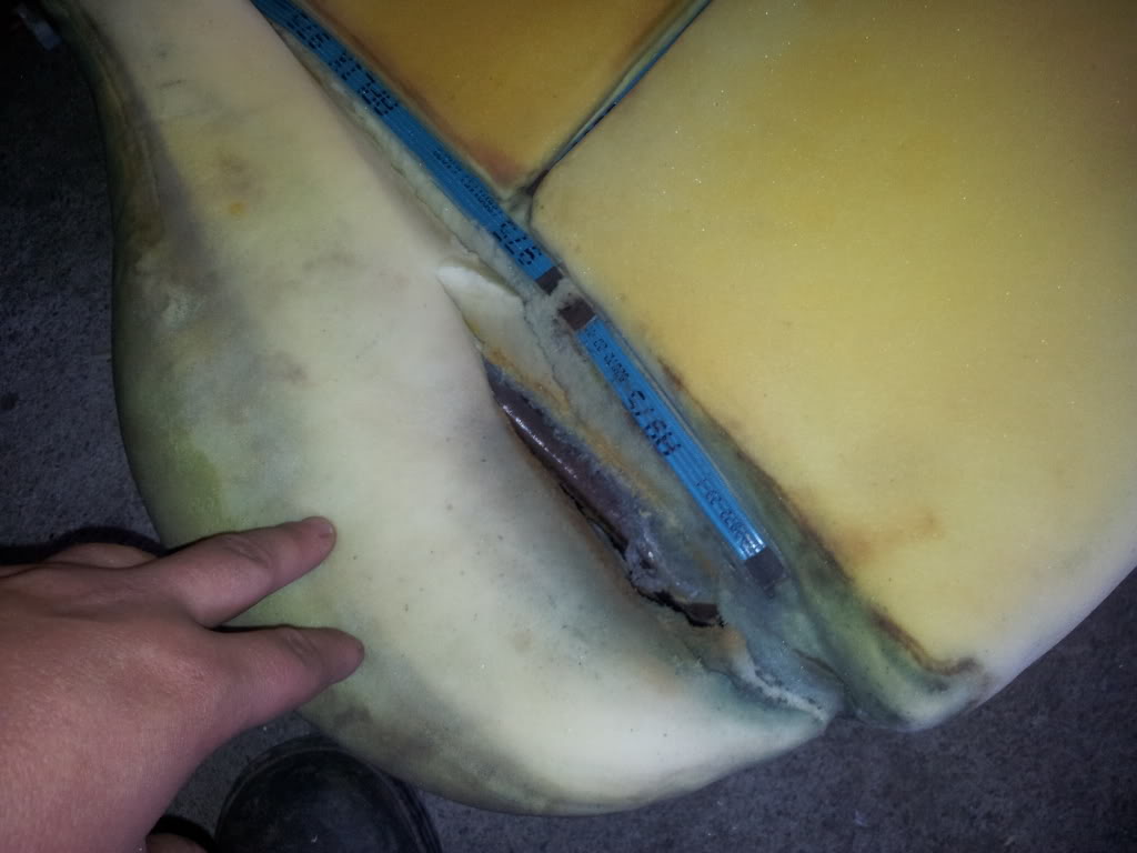

reason why the side's had collapsed just a bit of glue to fix it

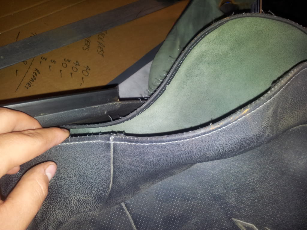

the tear in the side
he's also fixing the stitching and he's going to recondition the leather as it's gone all hard from sun, sweat so-on car will be on the tilt tray next friday to the trimmers to have the carpet and seats put back in

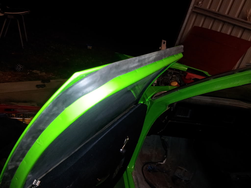

door seals are on the wrong way round mate. lip goes toward the door jam.
lookin sweeet
#414 _gen3torrie_
_gen3torrie_
Posted 09 October 2011 - 01:06 AM
thanks paul :)
could explain why that door takes a good slam to shut it...

just need to tidy up the donk now josh, think if you pissed the red rocker covers and fuel rail cover off and painted them the same colour green as the ute it will look great !!! keep cruising anlong your not to far away from the end now :D
#424 _gen3torrie_
_gen3torrie_
Posted 30 October 2011 - 12:31 PM
nial8er spot on! im actually doing that now... the rocker covers and stuff are being painted green, and i have a new timing cover and water pump so the front of the motor will be nice and clean and the block was painted black shortly before it putting it back in :)

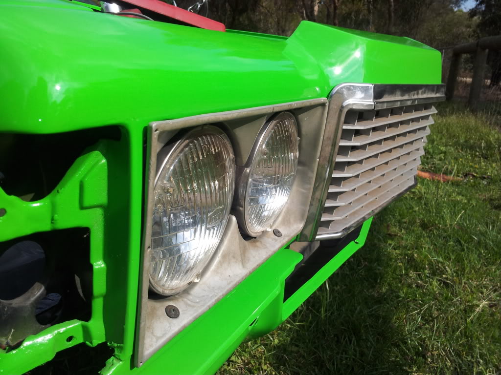

A hot tip to clean up those shitty looking headlight surrounds,scotchbrite them in warm soapy water and paint them with VHT chromepaint out of a rattle can.
It looks nothing at all like chrome,but looks very close to silver anodising.
Try it on an old shitter first to determine if you like the finish.
I did it out of desperation on some parts of mine,and was so pleasantly surprised by the result that I will use the method again.
