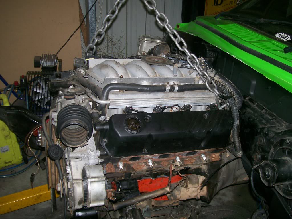

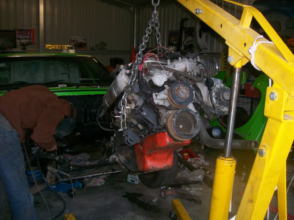

we started of with measurements dropped the motor in and tacked the mounts into place...

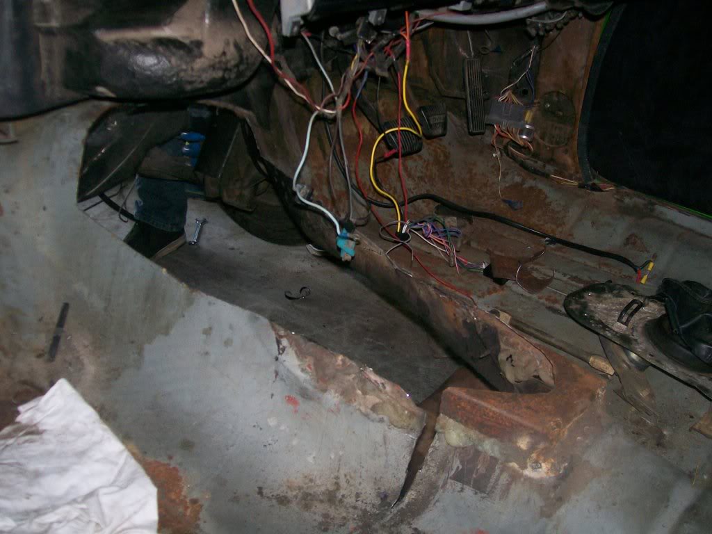

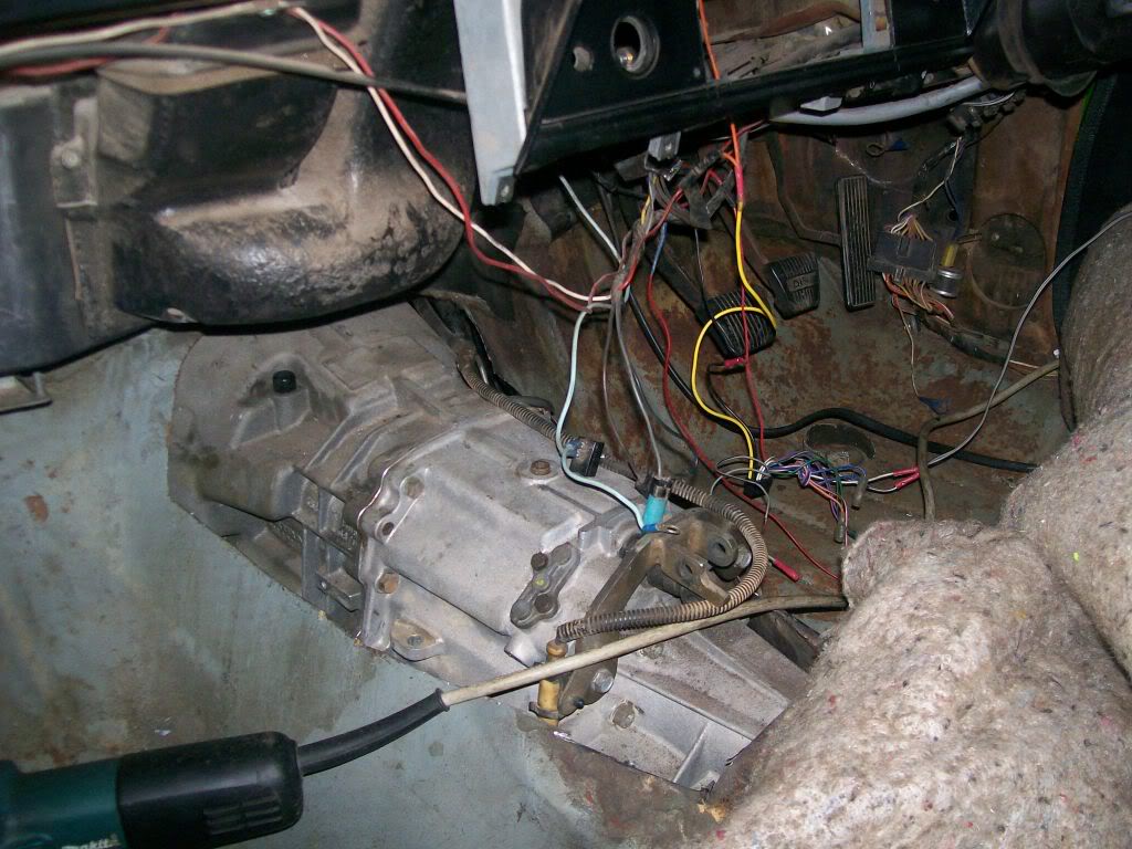

started off with the engine mounts as the previous owner welded in commodore V6 mounts instead of getting the CRS kit... dummy fitted it in marked out were we were gonna cut the tunnel and got the drill and tin snips out...
which gave us this hole...

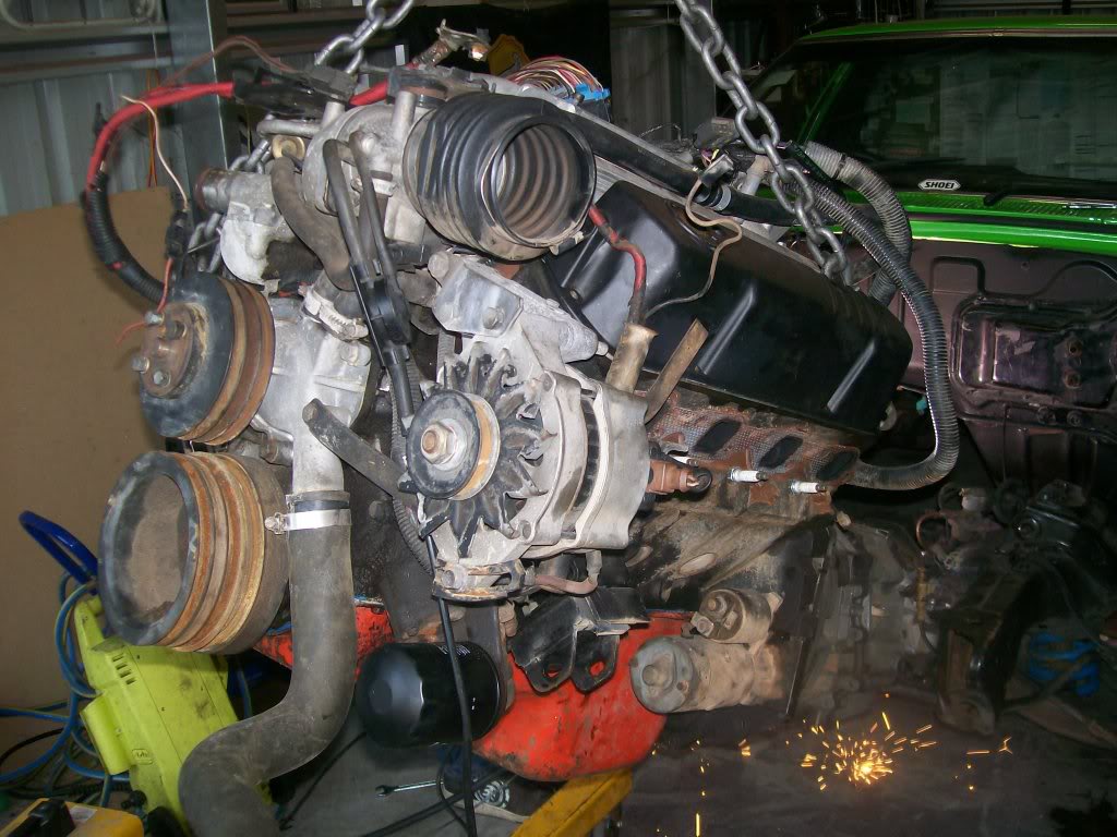

motor came back out to have the mounts welded back into place...

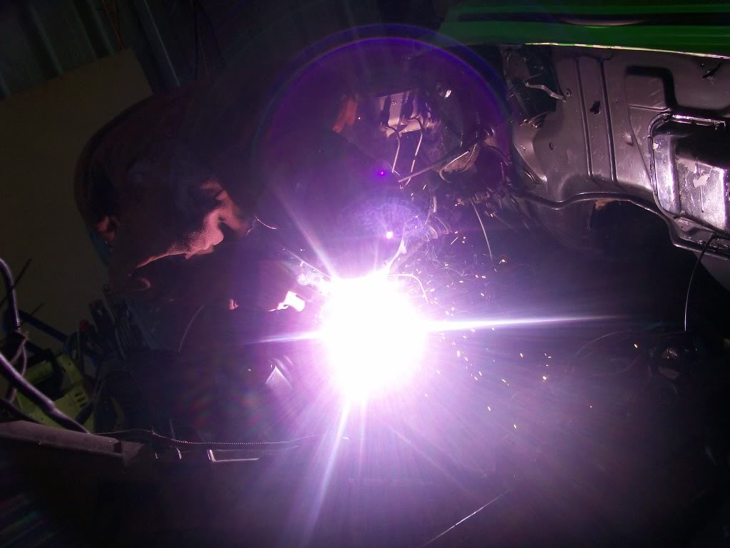

then my mate welding the mounts in...
thats the tunnel done for now... the sheetmetal is off at a fabrication place being rolled so it'll look like brand new...

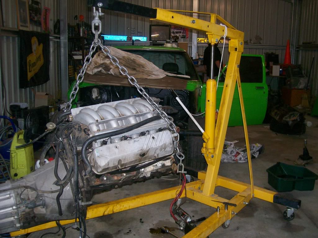

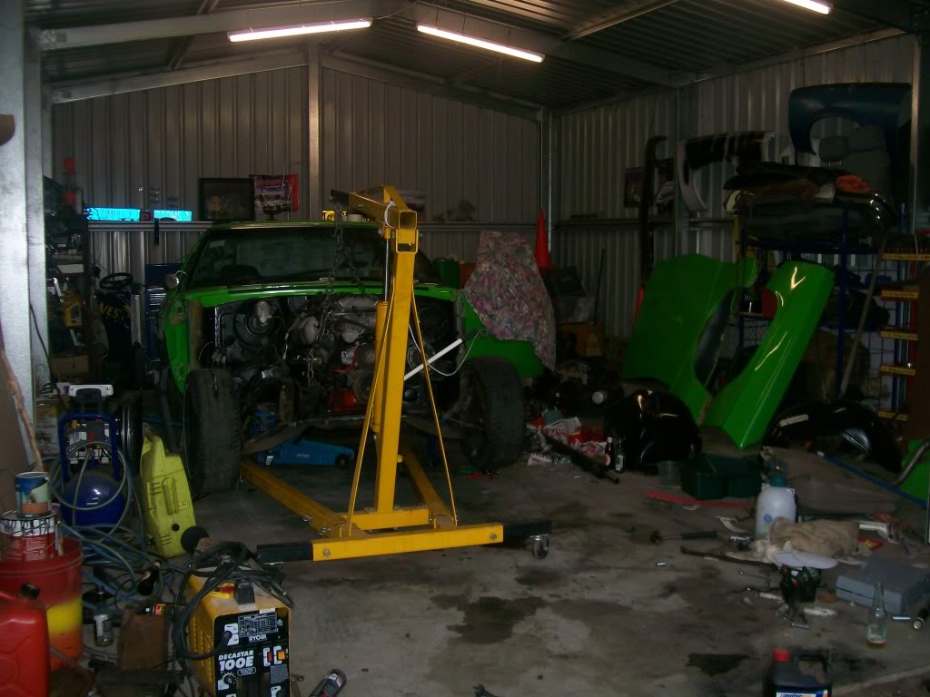

the motor and box went back in... ( i think in total space of 2 days we pulled the motor and box out about 10 friggin times)

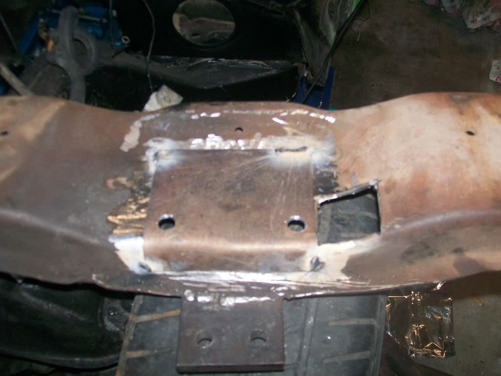

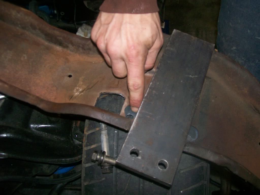

then the x-memba we started off with a piece of 2mm metal blanked it off marked out were the bolts came through and surprisingly it was very close to the standard holes so we drilled it out and it fit perfectly first time...
that square hole next to it is to allow the nut that holds the plate on the back of the gearbox to come through
the big plate with 2 holes underneath was for the old T5 but we ended up keeping it there for extra support...

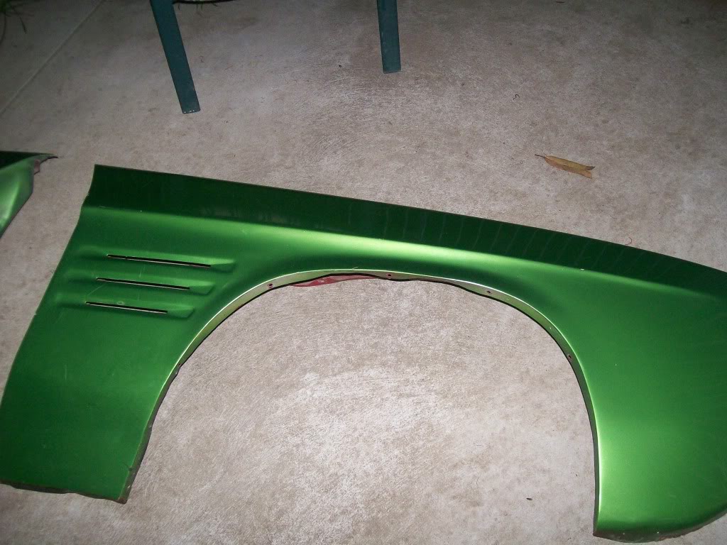

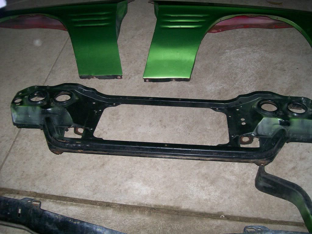

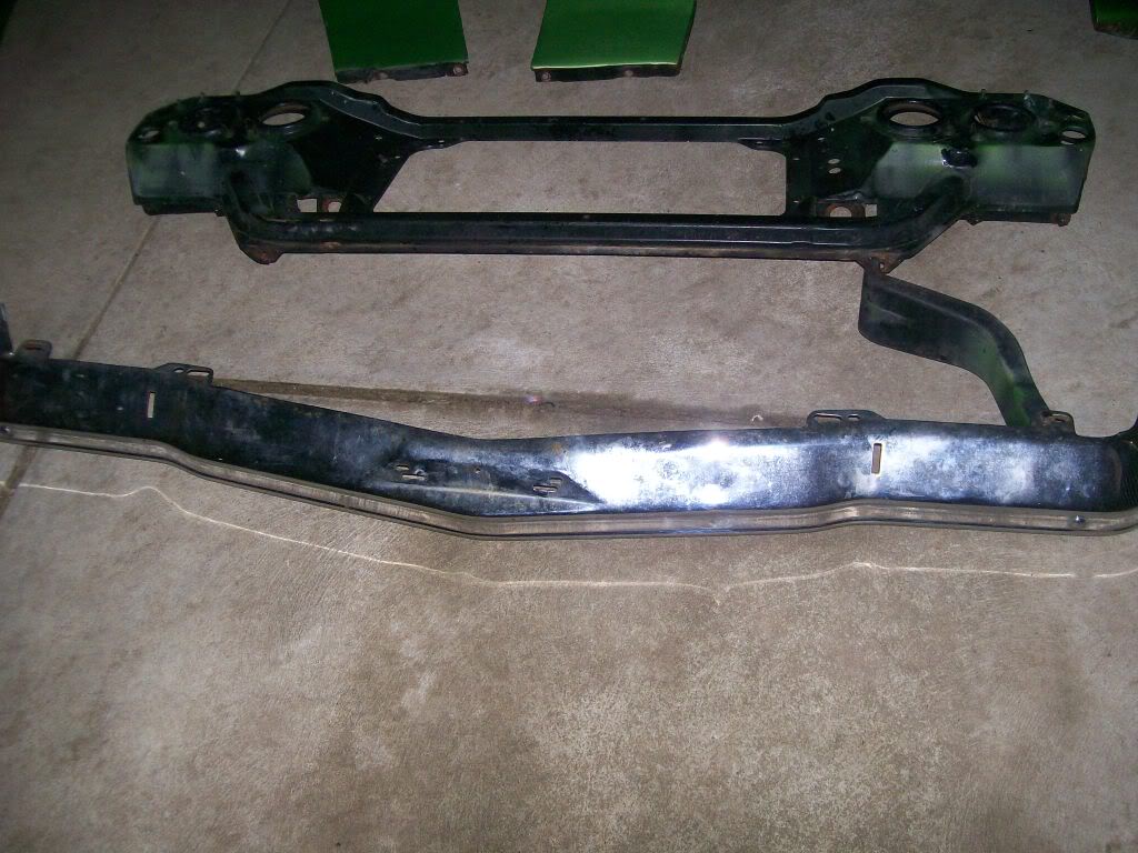

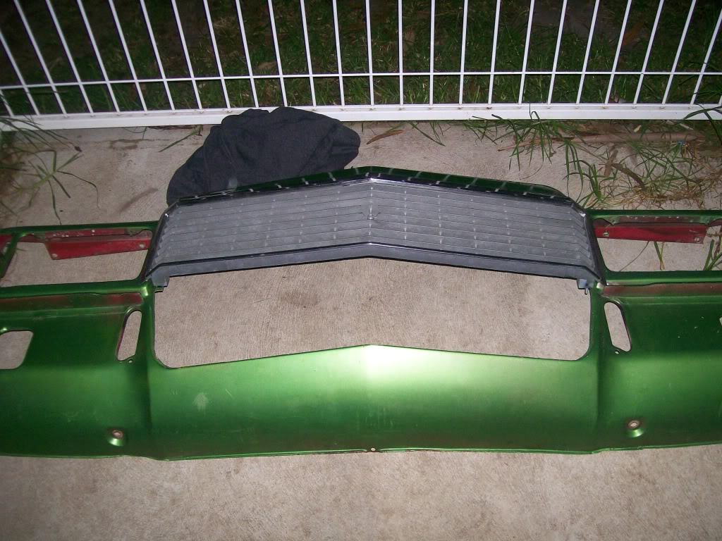

ohhh and i was trawling through the quokka and came across a cheap HJ premier front end with fluted guards... so that'll be on in the not so distant future...

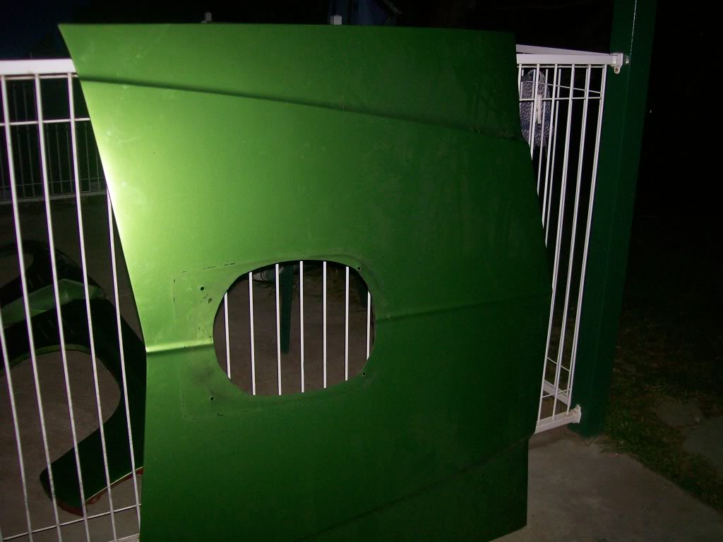

i just need to find a suitable scoop as there is a hole in the bonnet i was thinking of getting a torana reverse facing and modifying it...

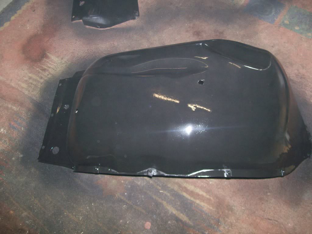

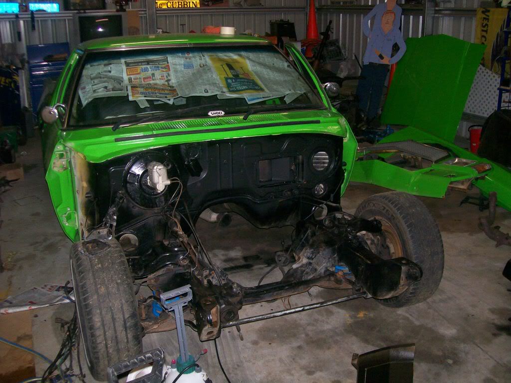

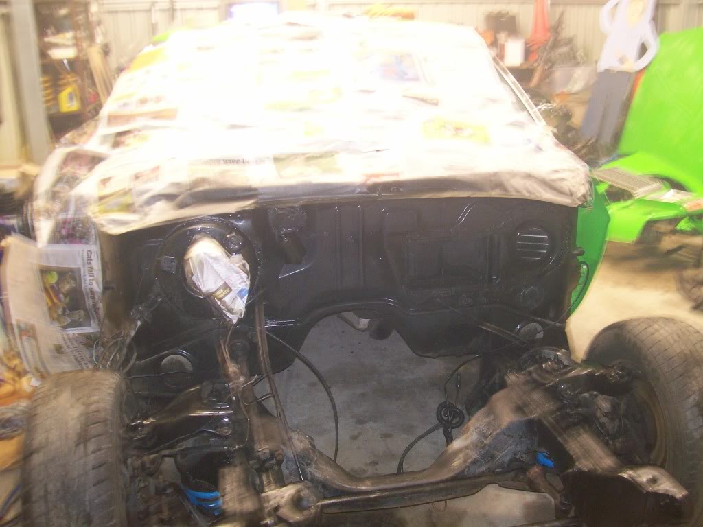

also while the engine was out we neatened up the bay a little bit
by painting the inner guards...
painting up the firewall..
half way done
finished
