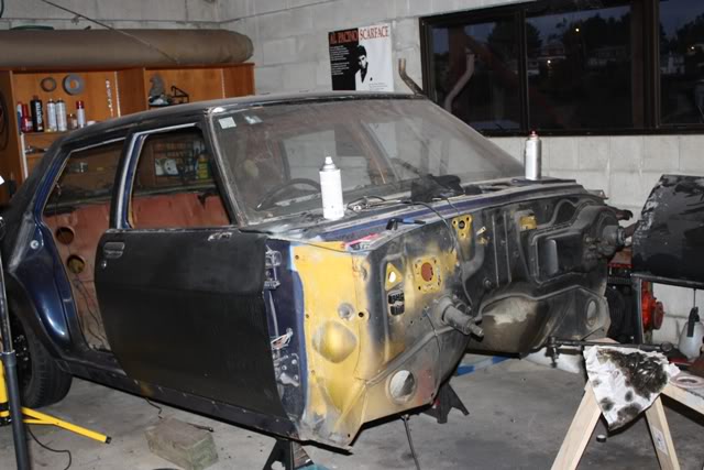

Now since I have some time on my hands again its going for the full rebuild, it's now in a million pieces, here's some of the mess...

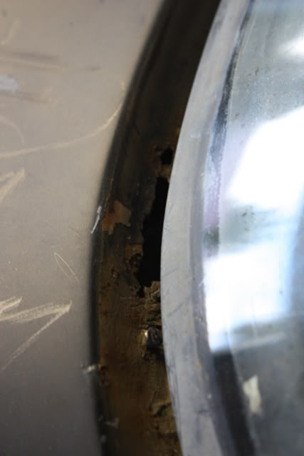

And some of the usual dodgy rust repairs...
So I've got a bit of work ahead for me yet, done a bit more than seen in the pics (need to take more). I'm also uploading vids to YouTube so you can also check it out here...

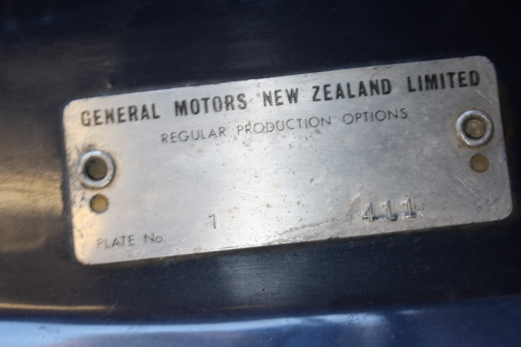

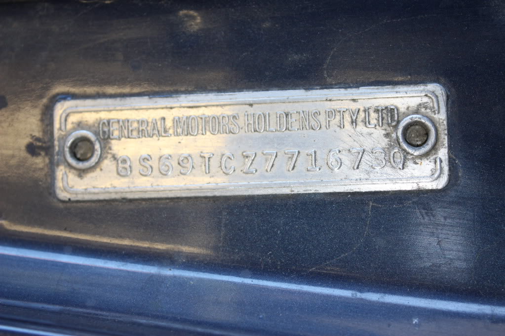

Cheers Bomber, I like it cause it's different (if I has a dollar for every kingswood I saw with a 350 chev....). Here are the tags I promised you...
This should translate to:
8 = GMH
S = Statesman Deville
69 = Sedan
T = 308 HC
C = 1973 build
Z7 = Code for built in NZ
71673 = Serial #
Q = HQ
This plate I think is where any extra features were optioned, however I haven't been able to find out what code '411' refers to, maybe someone out there can help.
There is no ADR plate but the holes where it would be affixed are drilled.
The 308 in the car isn't original (doesnt have the 11QT prefix) but is an HT prefix block from a '70 HG.

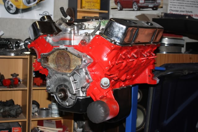

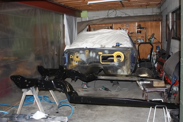

Thought I'd add a few update photos since those ones were a couple of weeks old, sorry bout the mess in the shed... :sucker:
308 (unknown bore size), flat tops, rebuild heads, mildish cam, 600 holley, elec. dizzy. Nothing like fresh paint...

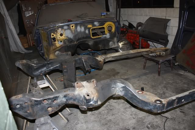

Subframe is off, will be filling holes in the firewall and repainting.
Might also upload a new vid to youtube tonight since I havn't in a while.

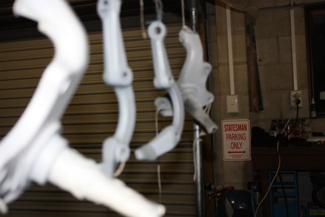

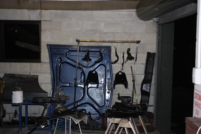

Got some more stuff done this week, mostly painting suspension parts...

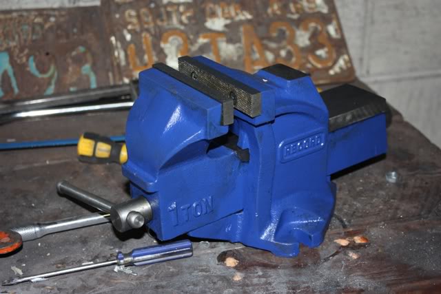

and practising my new favorite hobby

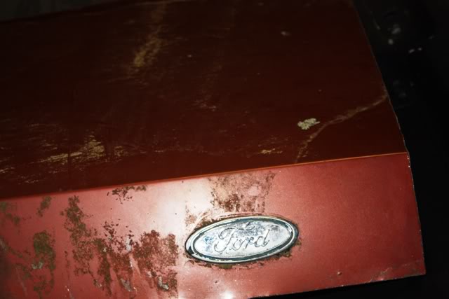

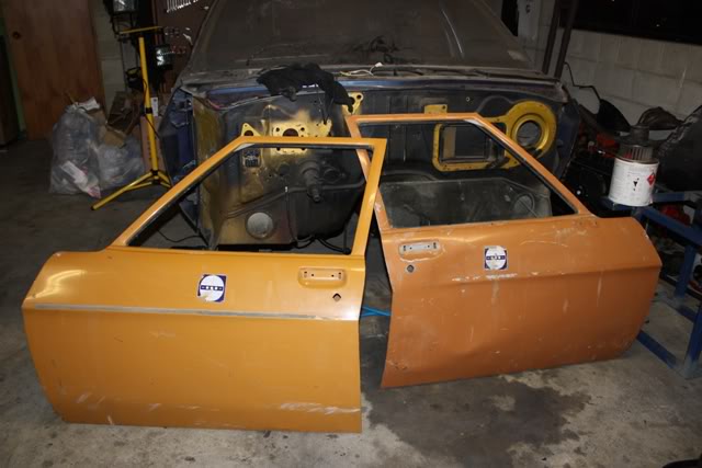

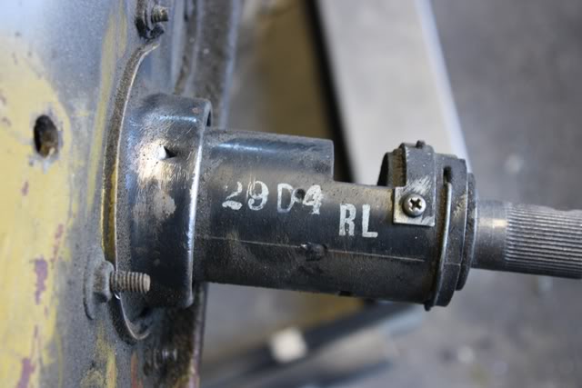

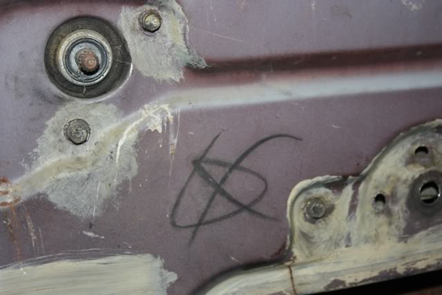

Bought some new doors in case I may need them, otherwise I'll panelbeat them new and resell
The fact that they have different overspray patterns makes me think
they're from two different factories. Cool to see these markings too.

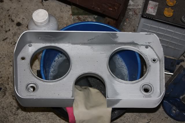

Cleaning up some plastic parts with my 'secret recipe', this is an HR dash for my collection

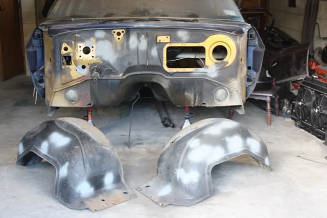

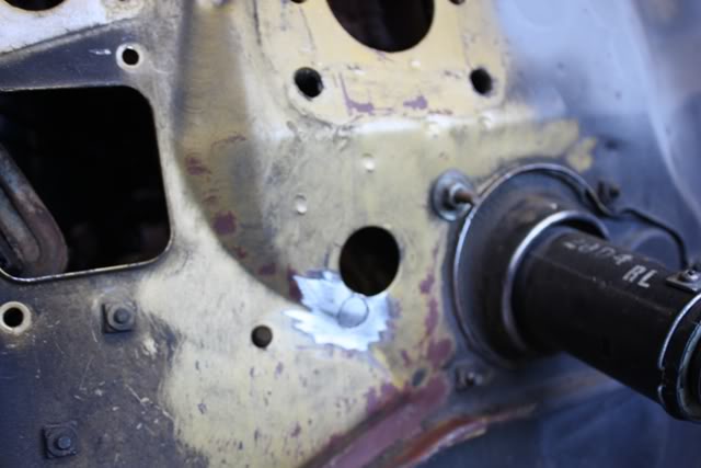

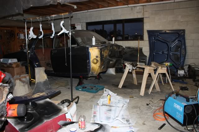

Been a while since the last update unfortunally (been away overseas) but finally got time to spend on the old girl. Went a got some sheetmetal to start filling in the holes in the firewall (going for the smooth look)

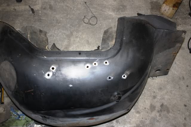

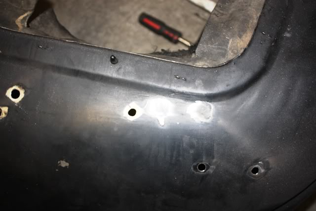

Inner fenders alot have alot of additional holes, a LPG system was fitted in the past and the appeared to have mounted the mixer here (plus more holes).

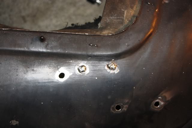

Filled with weld....
Thats better...
Here's what I'm cutting up for steel, they have their uses afterall...

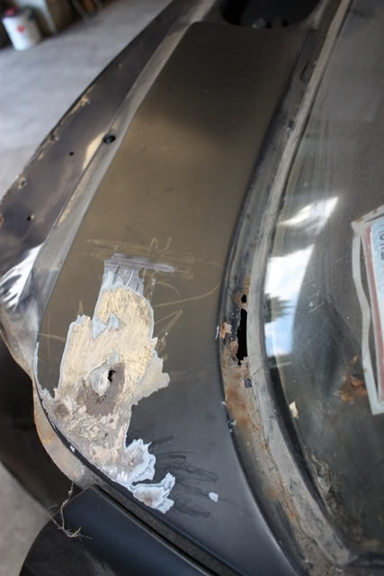

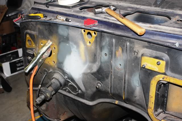

Filling in a few more holes today, there seemed to be alot, both factory holes (for optional A/C I think) and alot of others which people have drilled over the years...
Still got a few signs of originality...
And a few nice surprises, so there's where the water was coming in....

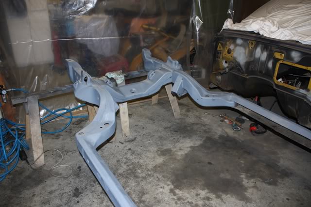

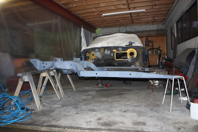

Got a bit more done this weekend, the subframe was a little grubby
Cleaned it up and hit it with some primer

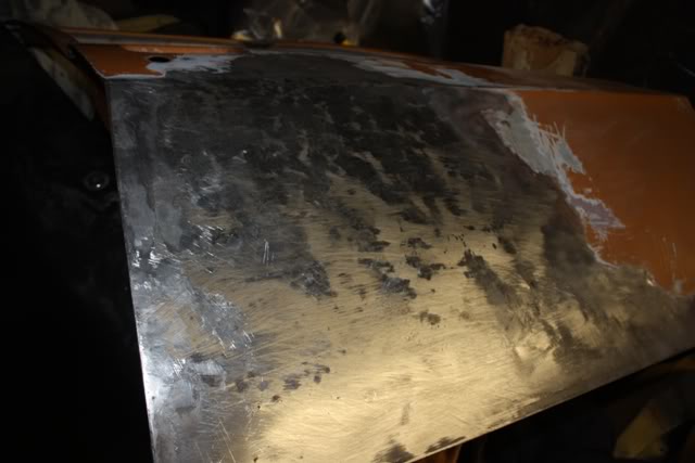

Been laying some paint this week, starting to look a little better
Also been practising some panel beating (havent really done any before). Bought a couple of doors a wee while back and they've got some pretty nasty dents in them. Prob just sell them after I've fixed up coz the next project probably wont be another Q.
