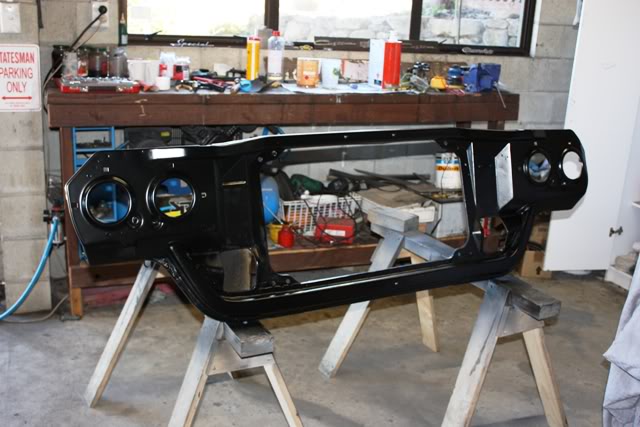

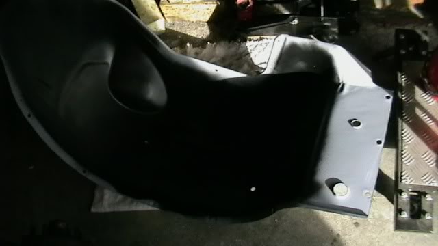

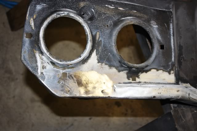

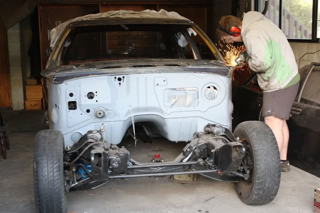

Getting a bit more paint in some important places this week
The black etch is useful as you can see where things need to be filled a little bit more. Was hoping to have it in filler primer today but I dropped my gun and busted the tip off it. Its a no-name brand from Mitre10 so it looks like I'm going to have to get a whole new one, bugger.

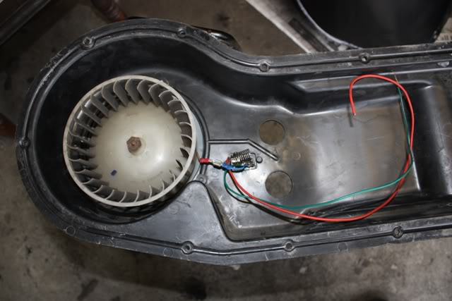

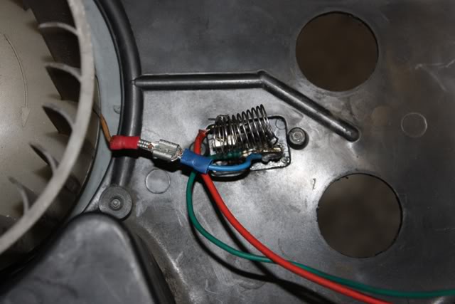

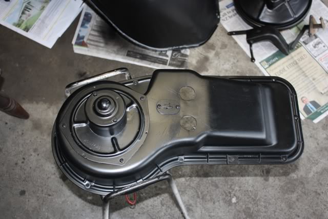

After seeing the post on hiding the wiring for the heater I attempted something similar...
The HQ unit is a little different in that it has this little resistor coil thingie which a plug goes into. So i cut the fins off the plug and soldered some wires in the back so I can still wire the thing up.
Looking a my posts I don't seem to have gotten far for such a long period of time even though I'm trying. Keep telling myself that once I get the front back together its all downhill from there...:Headbang2:lets hope so

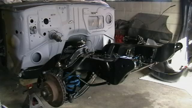

It's been a productive weekend, sold some parts online and got more for them than I thought so went and bought a few new toys for the shed including a new spray gun kit. It was on order so imagine my surprise when I got it on fri. This also arrived...
Scored it for $60 online which is a hell of alot better than the $400 I was quoted from a wreckers for a S/H unit. By the looks of it someones given it a good clean but I'll give it a once over, for a start it has too much end float in the shaft.

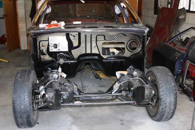

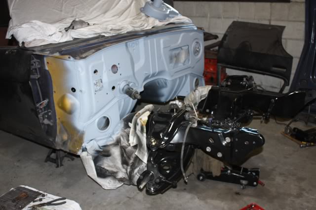

So got the firewall in filler primer, then a mate of mine came round to help refit the subframe

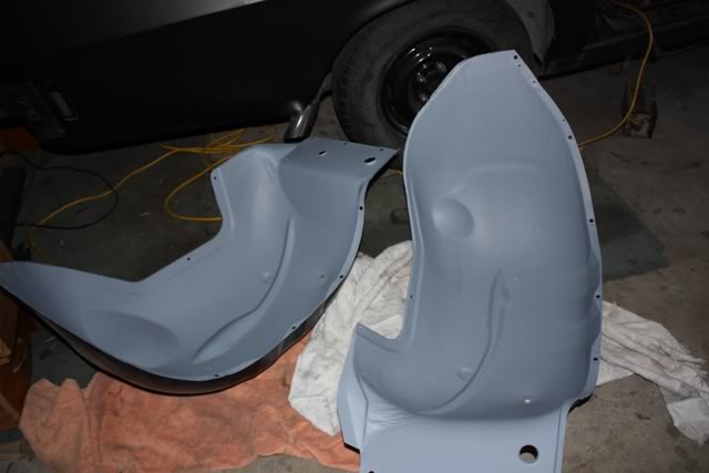

Also got the inner guards in primer and them sprayed a coat of chip guard
So it's been a pretty productive weekend, hope to have the firewall in top coat by the end of next week and the engine put back in.

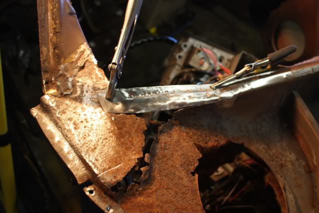

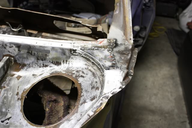

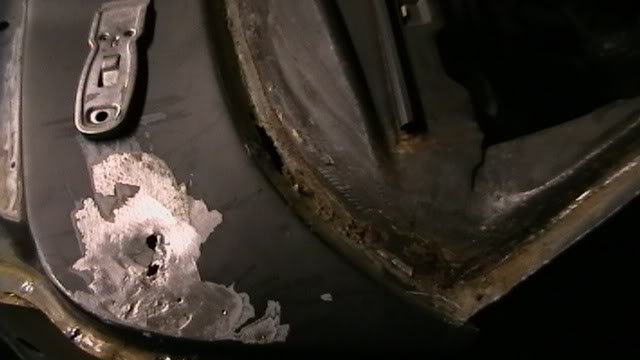

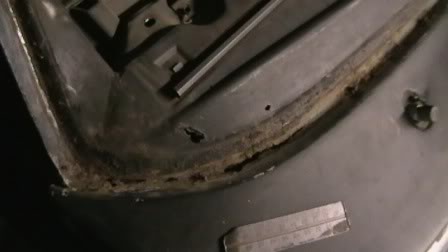

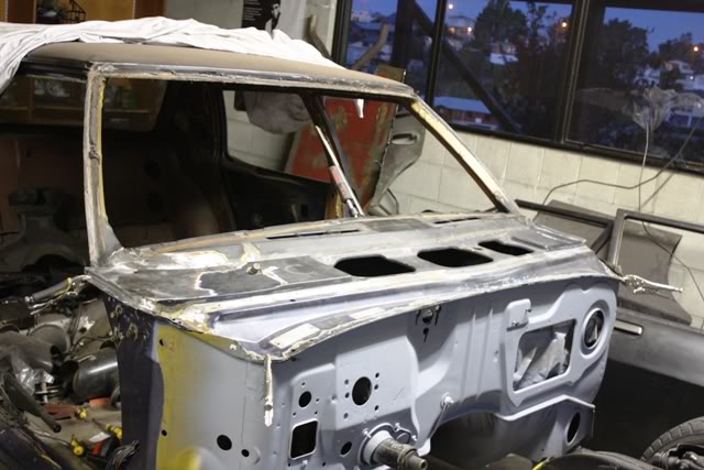

It's been two steps forwards and one backwards this week, was able to take the windscreen out without breaking it (f***kn miricle). The edge of the cowl panel (scuttles) in this thing are rooted (as usual in an HQ) and i've been wondering whether it was worth to unpick the lot.

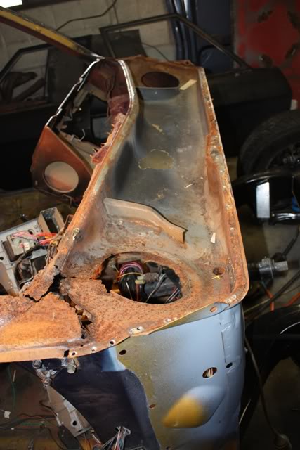

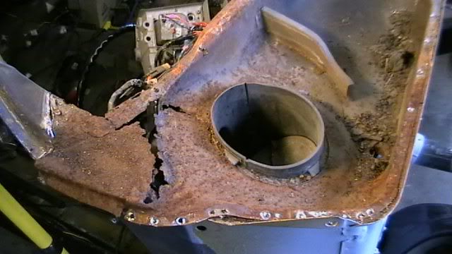

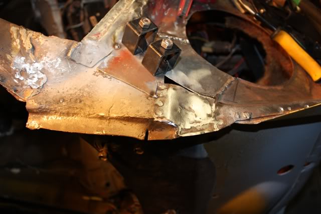

Decided to bite the bullet and unpick the spot welds (prick of a job) and found this loverly surprise.
I'm happy with the fact that there is only a tiny bit in the bottom of the pillar but less than pleased with the fact that someone has attempted to use 'no more gaps' in an attempt to plug the holes... Oh well, its not the worse I've seen but this should keep me busy for a week or two...

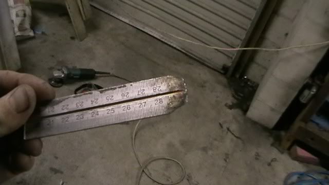

Oh and here's a quick tip if you need a chisel to break the spot welds (after drilling of course)

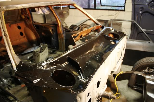

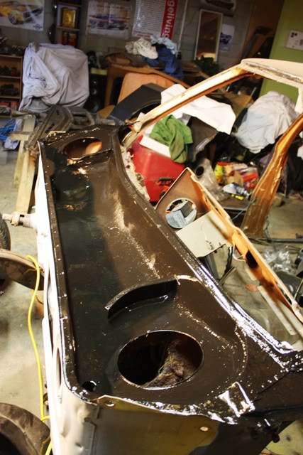

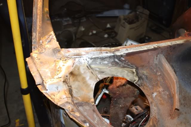

Time to have a crack at my rust issue....
Covered it in rust convertor and will layer in in POR15 tomorrow. Had to cut away some more than I thought I would into the lower part of the firewall (not shown) but reasonably happy with how it came out. Not too worred about the weld finishes since its not really a cosmetic area.

Geeze I hope not! Haha not too sure, there will be a few previous repairs that I will be cutting out and doing properly but other than that I have no idea what awaits me... and what a treat it will be :Headbang2:

Doing the scuttles at the moment, will post that up in the next day or two. And not to bore you with too much details, here is the other side.

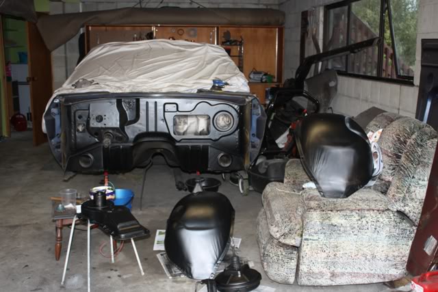

Painted all of the plenum with POR15, no rusting any more...

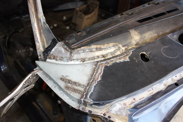

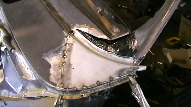

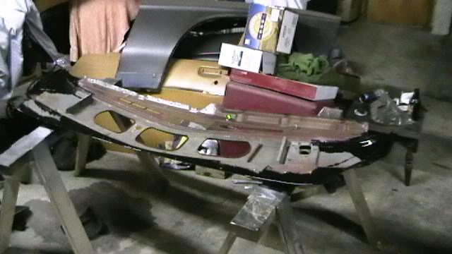

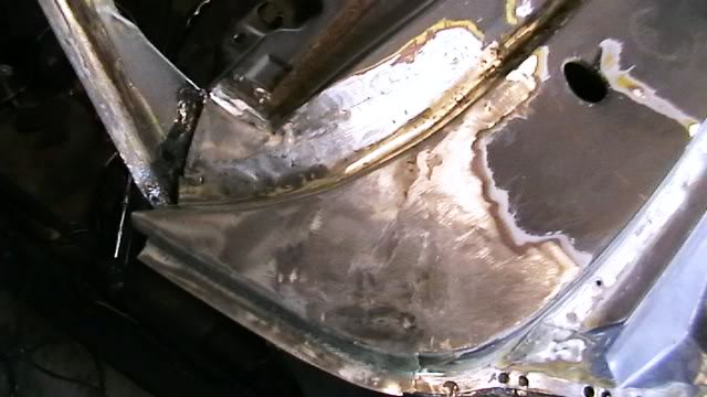

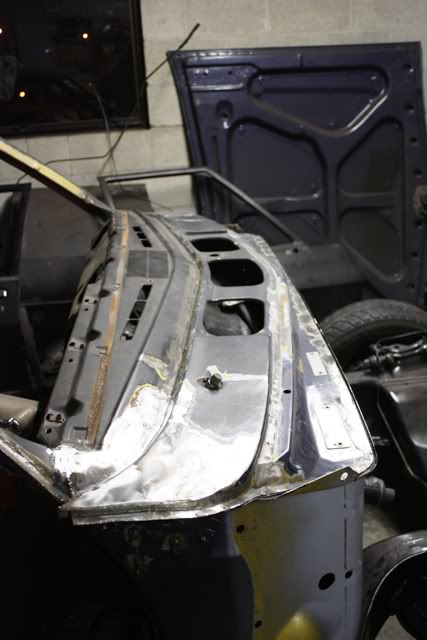

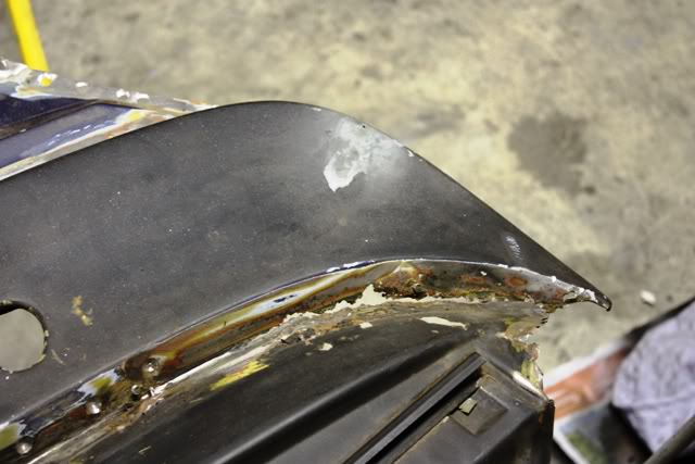

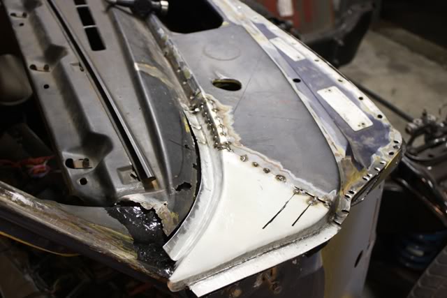

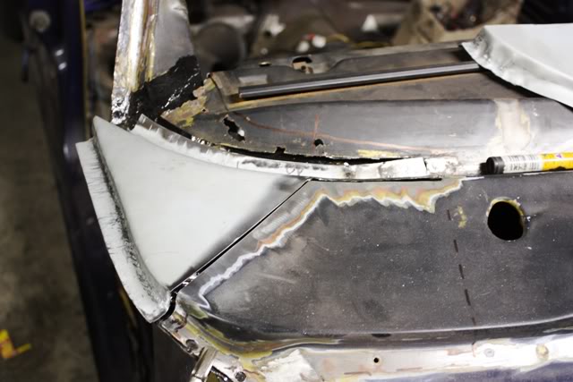

Finally got the scuttles done, what a hassle that was.
These things they sell on TradeMe shouldn't really be called rust repair panels, they're more like "metal with shapes", every profile on them are wrong. I appreciate that you will need to give them a 'massage' to fit, but this was unreal. Will try the rares part next time I think.
You can see the bend is way too shallow here. The curve is also wrong
So here's what we were starting with
You can see I had to make an extra bit for the top, the panel was also too wide so I had to make a few cuts with the grinder to push it back into shape
Came up ok I guess
The other side was a little bit easier
No more rusty rusty, just a coat of POR15 to finish it off
Will just need a slight bit of filler (might even get away with the high fill) to fix the bits where I have slightly undercut with the welds. Slowly getting my technique down...

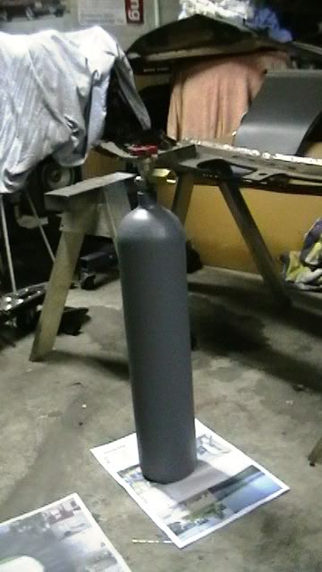

Also just ran out of gas so will go get it filled tomorrow, as I mentioned in another post I needed to give my bottle a paint job so it doesnt look like a fire extinguisher.
I'm thinking (since it is mine) I should pimp it up, thinking some flames or pinstriping would be appropriate, suggestions are welcome... :nudie:

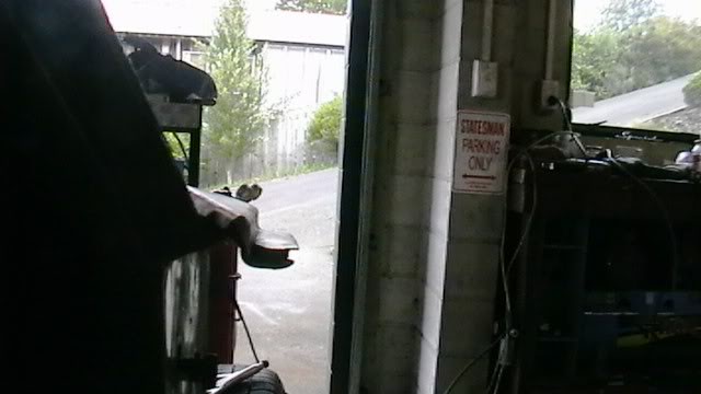

Yea it is a hell of a steep driveway, you can see why I need to get it driving before taking it to the painters; no way would a flat bed make it down here. The holden gets up with just touching the exhaust but my daily is too low to get down so I made some wee 'ramps' for the top so I can get it down and work on it. The view we have outways the steepness of the section.

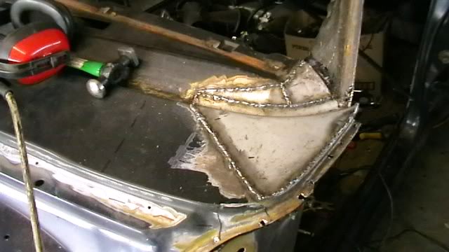

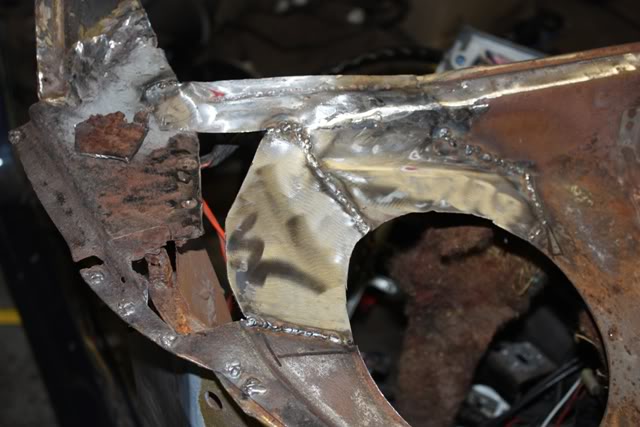

Well I finally got the plenum back where it is suppose to be, all clamped up and ready to go...
I was half way through doing the plug welds (pain in the arse) when I heard sirens, looked outside to see a pillar of black smoke, then looked down the road to witness this...
I think the poor guys have lost the lot. However I have never seen so many cars go down our road, every man and his dog were out for a gander. I just felt sick for those peoples house. After a few photos I got back to it...
And all finished up...
Reasonably happy with it, least it isnt full of rot anymore.

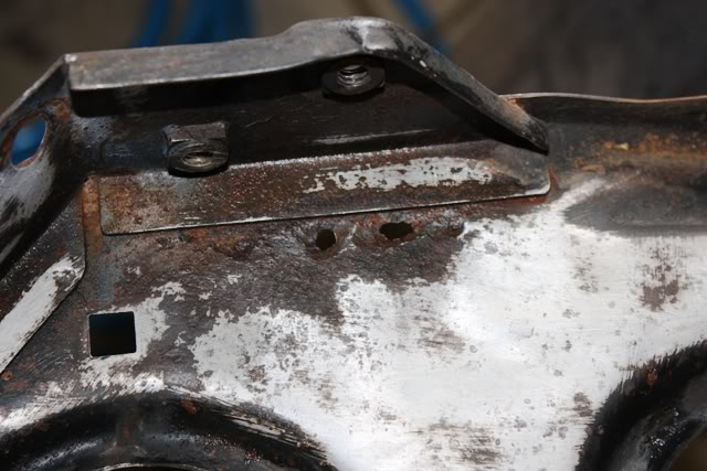

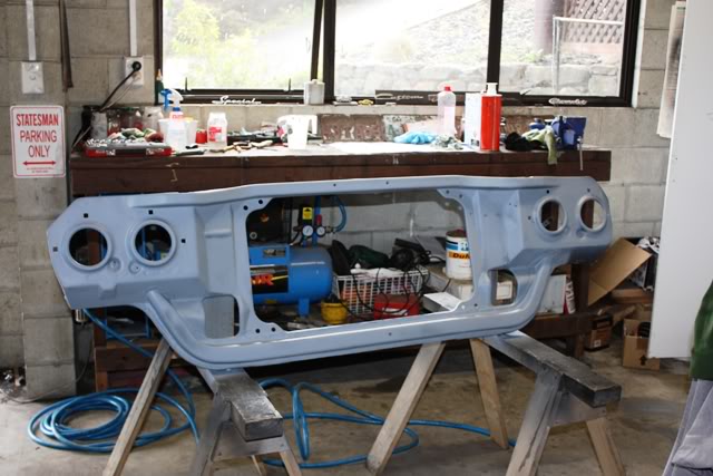

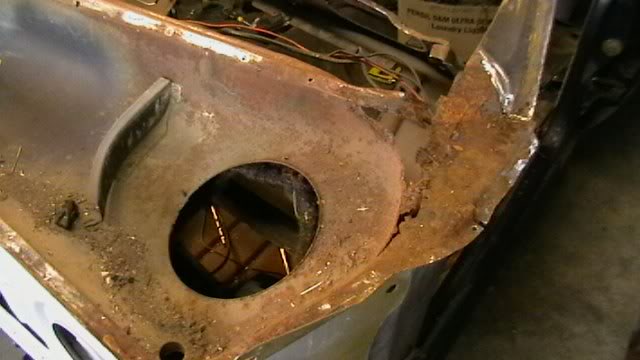

Just a few quick jobs today. Found a bit of rust in the radiator support panel that hadn't been sorted when I had it fixed....
But now its all good
Sprayed it all in primer, will get it (and the firewall) in top coat when I get back from oz.

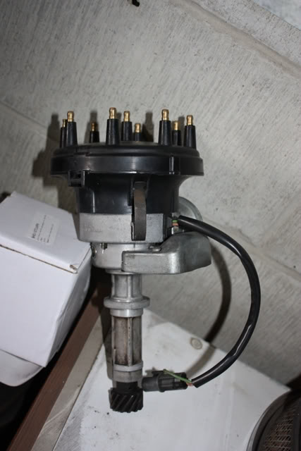

Rebuilt the electronic dizzy I bought too, some one had pulled it apart and cleaned it but neglected to grease on reassembly, also fixed the excess endfloat it had.

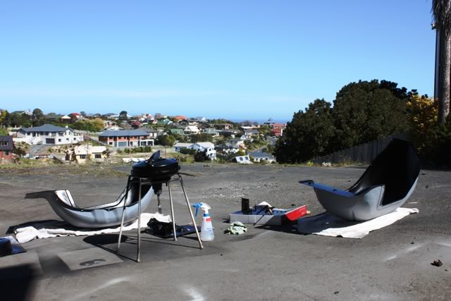

Well I got flew back home early this morning and was a bit shattered so I flagged work for the day and did some stuff round home. Including getting a little bit of painting done...
It was a sunny afternoon in Dunedin so it was one of the few times where it was suitable to lay some more paint
