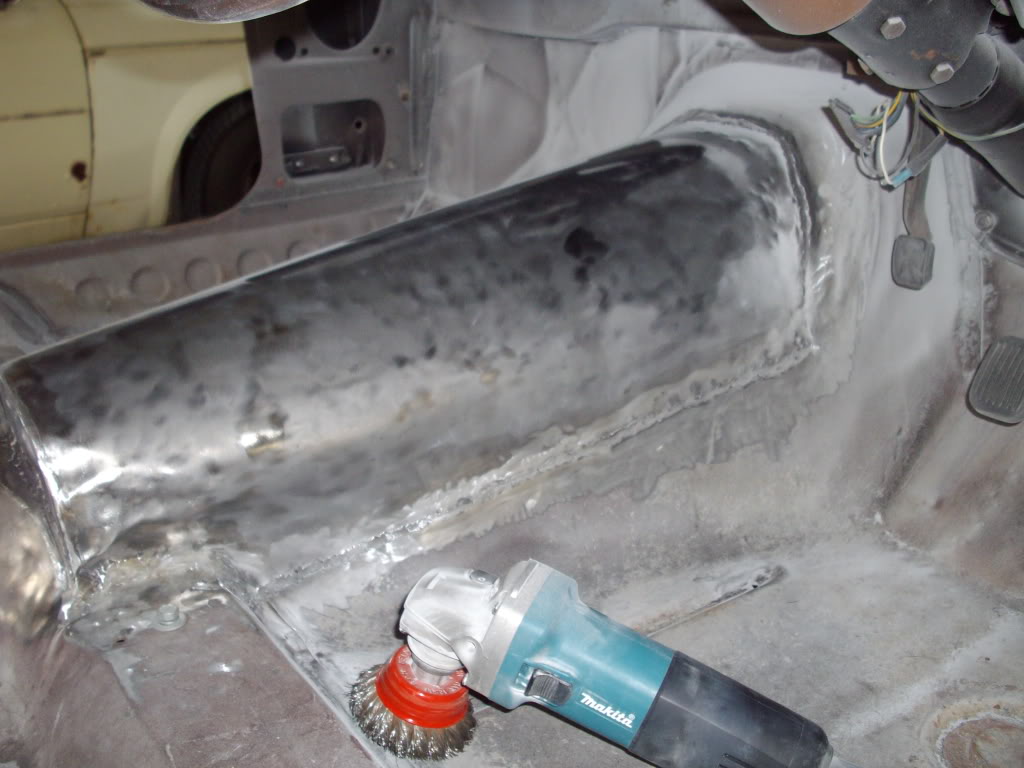

its the same as what you have on your grinder on the 1st page. if you use them lightly they dont cause much heat at all and the little bits of wire that break off and stick on your legs / arms / face dont hurt its just a figment of your imagination :P
"they frOking sting when they hit ya and worse when you have to pull one out"
#256 _nial8r_
_nial8r_
Posted 13 June 2012 - 08:58 AM
heres mine here,,

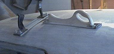

After the first block back, the high and low spots became much more apparent. There weren't that many though mond you, but the few that were visible, WERE VISIBLE!
You may want to get yourself a long board, I had a similar problem on a hatch quarter, blocked it with a shorty like your cork one three times with no joy then it hit me, the short block was following the profile of the low spots, switched to a long board and they flattened out first time on hi fill, no bog required.

Long board eh? I might hit ePay up now and see what is available. Good tip that. Been meaning to update from my single cork block for a while.
