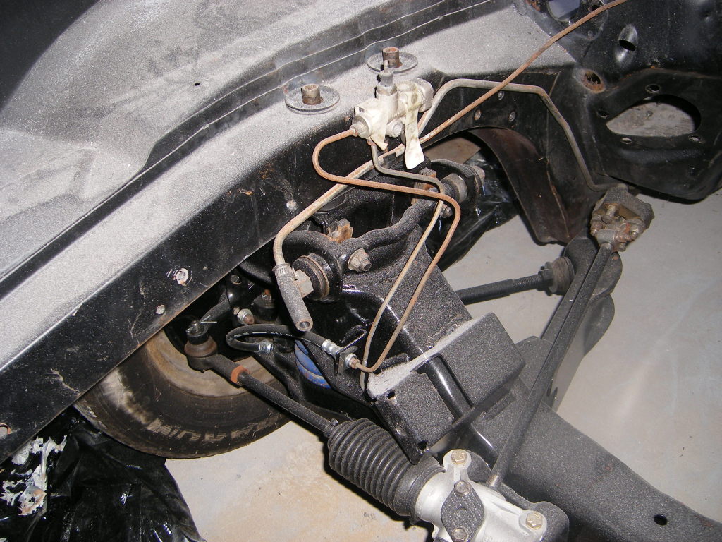

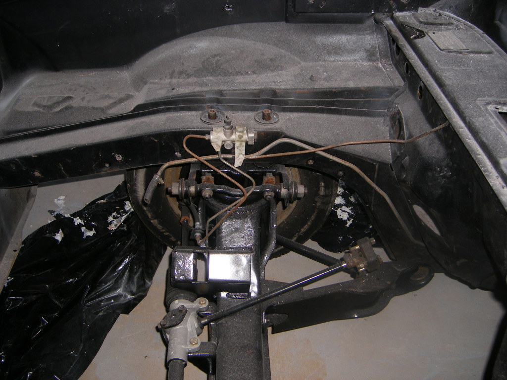

I need a photo of the front of someones car showing the brake line and where it goes off the two side rubber flexible hoses - so If someone can post great !

#263 S pack
Posted 16 October 2012 - 05:53 PM
Grant, not the best pic but hope it helps, was a bit hard trying to crawl in under the front when the front bumper is 1/2" off touching the end wall of the garage.
Next time I might even think to turn the steering to full lock, LOL.
Pic is drivers front wheel.

roger Dave thanks.
I cannot find the actual brake line , routing diagram from the hard steel lines OFF the flexible hose to the proportioning valve. John K gave me some but there are three that come out;
1) to the rear
2) to the left front
3) to the right front
just need the detail after it leaves the valve and goes down through the cross member around the engine mount
checked all the books and cannot find
#265 S pack
Posted 19 October 2012 - 09:02 PM
roger Dave thanks.
1) to the rear
Grant
I'll see what I can dig up over the weekend.
Dave.

#268 _Agent 34_
_Agent 34_
Posted 22 October 2012 - 04:30 PM
Simon,
hit the jackpot - just what I needed thanks heaps for this one.
