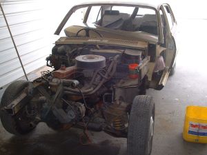

Well it's been a bit over 6 weeks, the major works started on the body of the GTR and the mascare of the donor car in a self less donation in order for the better car to live again. It's a bit like Kerry Packers Helicopter pilot giving up his kidney so the Big Man could fire up again for another few years !
The main thing that has happened is that we found all this rust, " what a suprise " , I have to say that if and when this gtr car gets sold there will be plenty of proof that the body has been fully sorted and that there is no major matters that need to be undertaken.
The good thing is that the donor car has all the right bits to undertake the replacement parts.
so here are some pics

Well its amazing what a hard life these little cars got, they were thrashed to an inch of their life, smashed into anything, repaired, thrashed again, smashed again.
The car has been telling a storey and this story is at least two separate front end smashes passanger side and also driver side, well at least they were consistent. Anyway the passenger side was a beauty, they must have hit something that hard that the bumper stop on the main cross member has been bent upwards, this would also explain the work done to the inner guard and re spot welds of the chassis rails.
Now for the record, in it's cabin is oversprayed green, the inner door is green, the other inner door white ( replacement) , the internal heater box is green, the parcel shelf is green, the hood linning is green . The car matches up, but at some stage has had a repair to the passenger chassis rail, there evidence of new welding to these areas which is not consistent. Our view is that it's had a major hit to this side and this has caused some big damage to the inner guard and also the front end.
If i ever sell it i just want it to be on the record here that it matches and work has been done to the car to this area. We are for the record replacing the front OF the stamped guard under the battery tray as the headlight surround is rusted beyond repair and i want to do this right.
anyway here is the evidence that it taken a big hit
