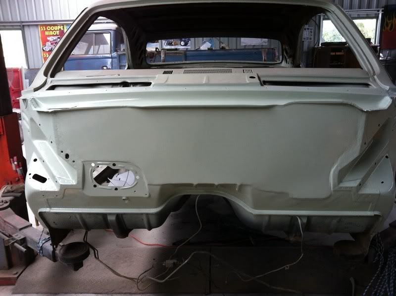

Actually, I've decided it's mine now : )

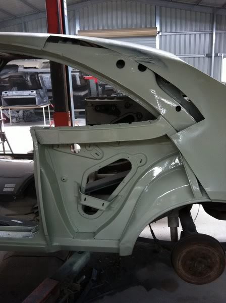

I welded the new inner piece on at the rear.
Just to prove how much I love HK monaros, I gave myself a massive case of wankers cramp! Hurt too!

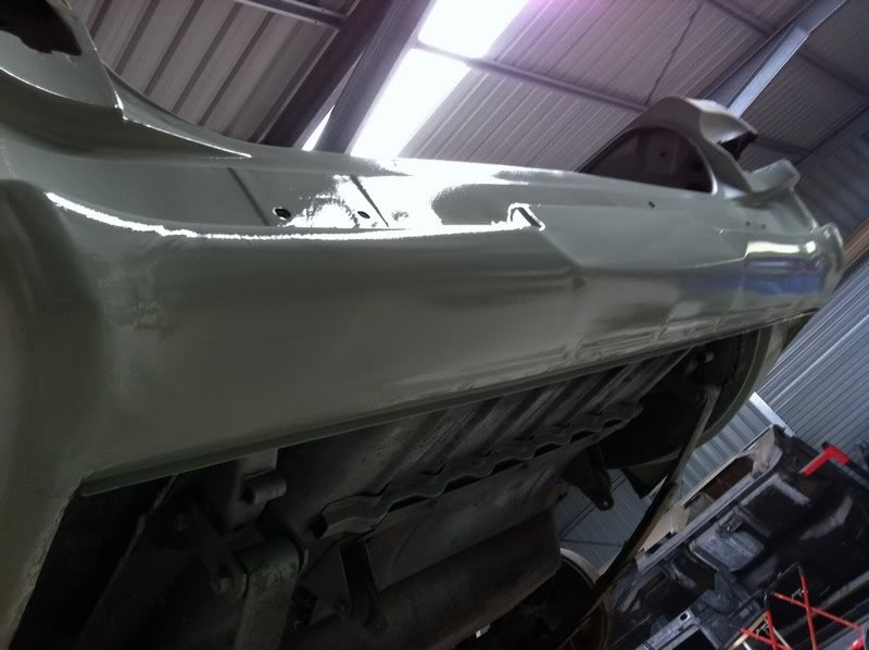

#330
Posted 07 July 2011 - 09:26 AM
#331
Posted 08 July 2011 - 09:53 AM
#332
_dirtbag_
Posted 08 July 2011 - 12:28 PM

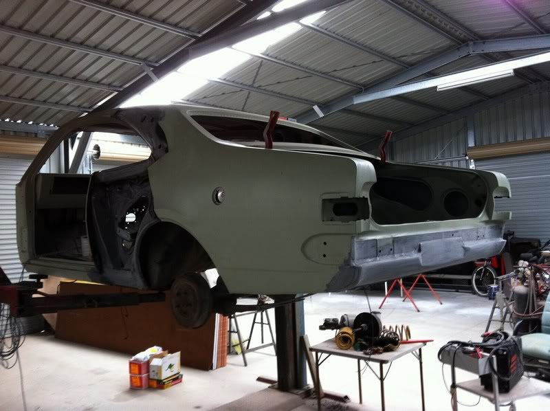

Here's what it looked like yesterday.
It's swell : )

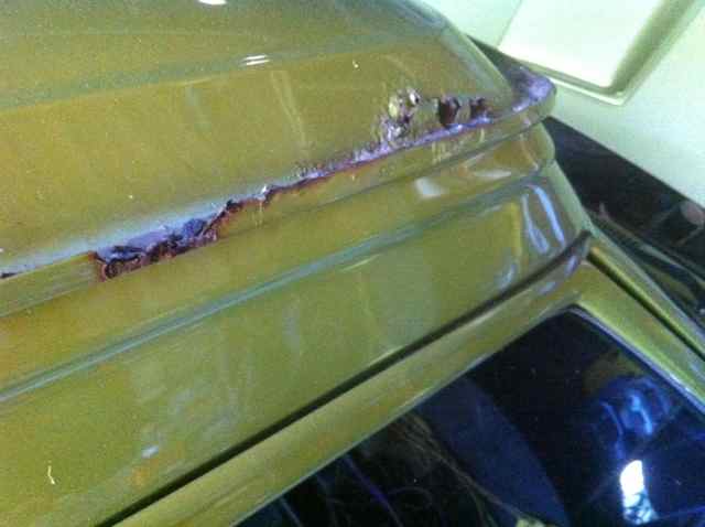

Posted 09 July 2011 - 02:46 PM
I've broken my collar bone so I've got time to look at these things....

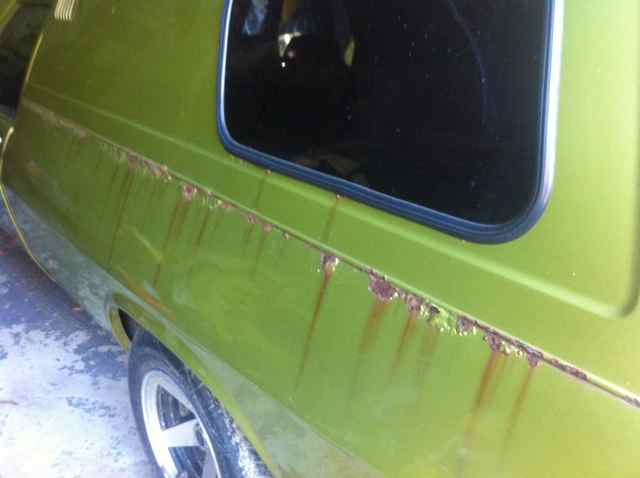

Question : have you ever folded up the section where a panelvan roof meets the ute tray sides (if u know what I mean...), how bout gutters? Ever folded em or just graft?
Here's some photos of my dilemma.
Love ur choice of work'n music. Bit partial to the heavier end of the spectrum myself.
Cheers, Metal up your arse \m/
#337
_dirtbag_
Posted 09 July 2011 - 02:57 PM
As for your rust issues, folding up the new pieces isn't a problem. For roof gutters that are really stuffed it's usually easier to cut the gutters off, fix the rust then make and weld on new gutters over the top.
Where the van roof sits on top of the ute quarters was just a giant stuff up on holdens part. If I ever get another van and it has rust there, I'd cut the whole lot out and make a new strip that goes from the panel under the windows to the top of the quarter and be rid of that seam altogether. But that's just me : )
Good luck with it. Post pics!

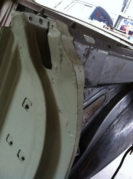

Posted 14 July 2011 - 06:05 PM

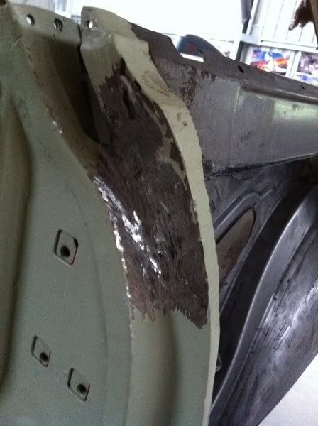

I rust converted the inner panel.
I drilled a row of holes along the lower edge so I can plug weld it to the new inner piece I fitted.
I then lined it up and got some tacks on it.
All the plug welding done.
Then lots of welding along the top and sides and it's all done.
Of course it copped some rust converter : )

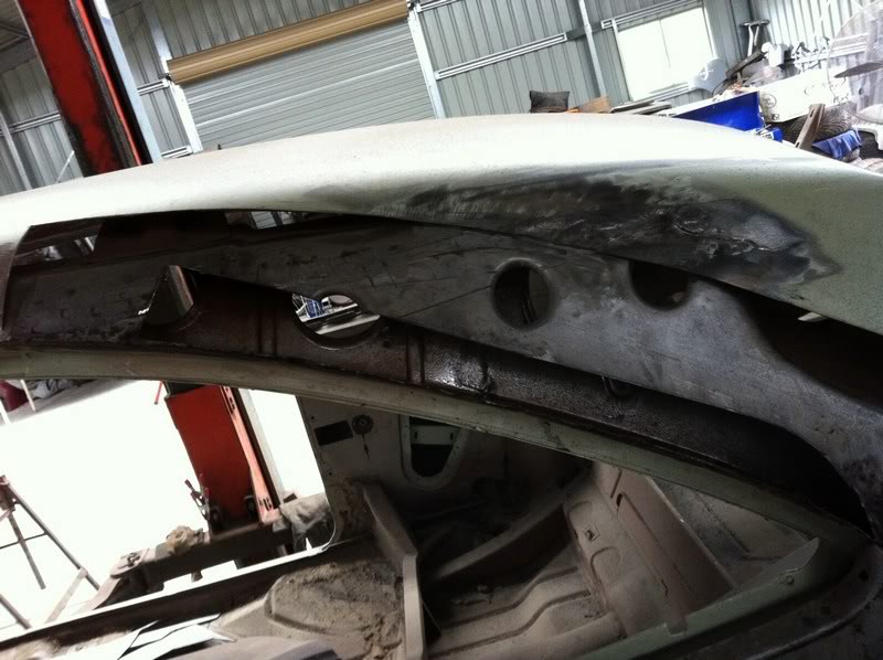

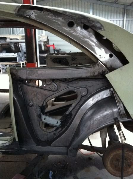

Next job was chopping the passengers side off.
There's some goodies in here : )
How nice is this double overlap? : )
Here's a couple of perfect panels : )
There's a little bit of rust around the side window, but no worse than the other side.
I also cut the inner lip off that makes the outer skin rust.
That's all I did on this one today.
