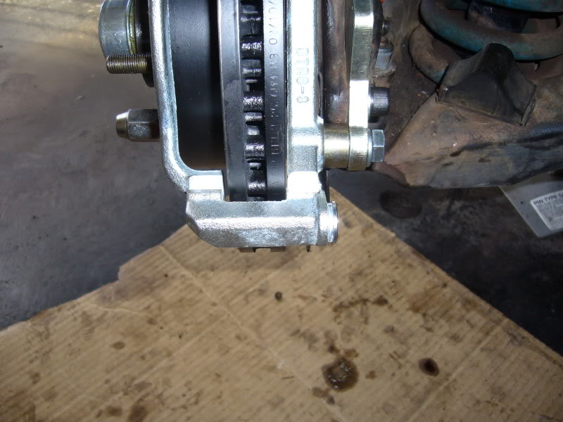

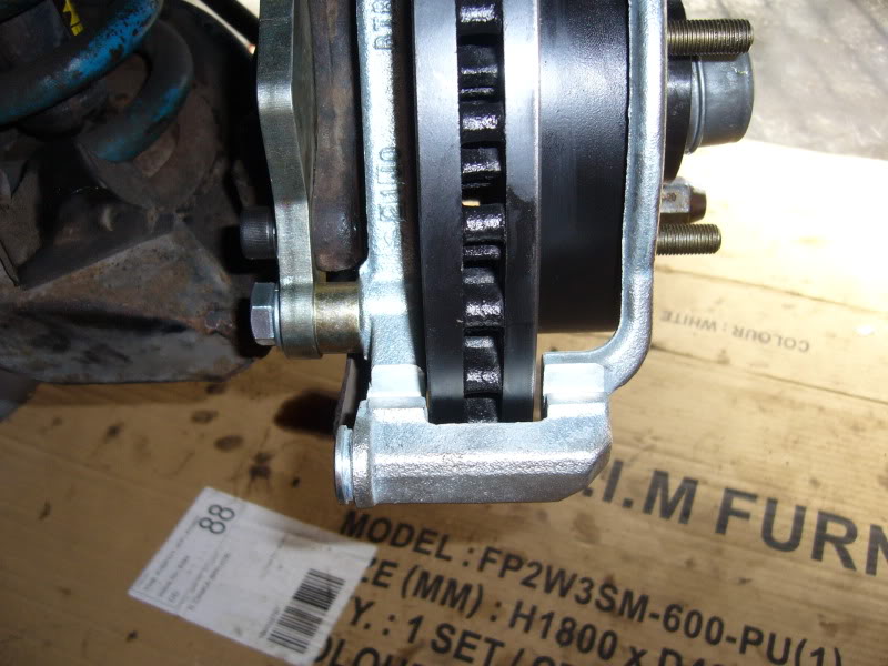

_76S.L.R_
Posted 01 April 2011 - 09:48 PM

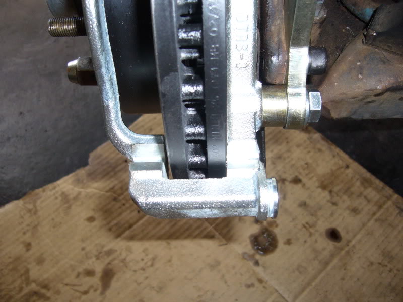

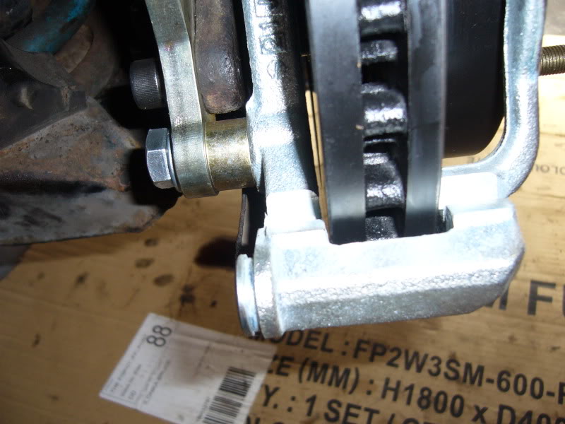

Heres some pics of how close the Rotors were to Caliper brackets.......Hoppers sent out new spacers and some shims straight away = now sits where it should,though the smaller SPACERS sent had no cut outs on them to clear the top edge of the Stub Axles so I had to grind a little off so the spacers would fit, only the Top Spacers were problematic though ,bottom ones dont need the cut outs. The first set of spacers I was given had the cut out on them,second set were just fully cylindrical
LEFT SIDE
RIGHT SIDE
Edited by 76S.L.R, 01 April 2011 - 09:52 PM.

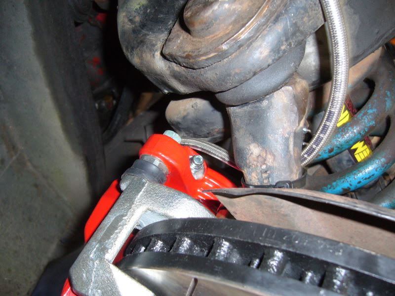

#64 _76S.L.R_
_76S.L.R_
Posted 25 April 2011 - 11:32 PM

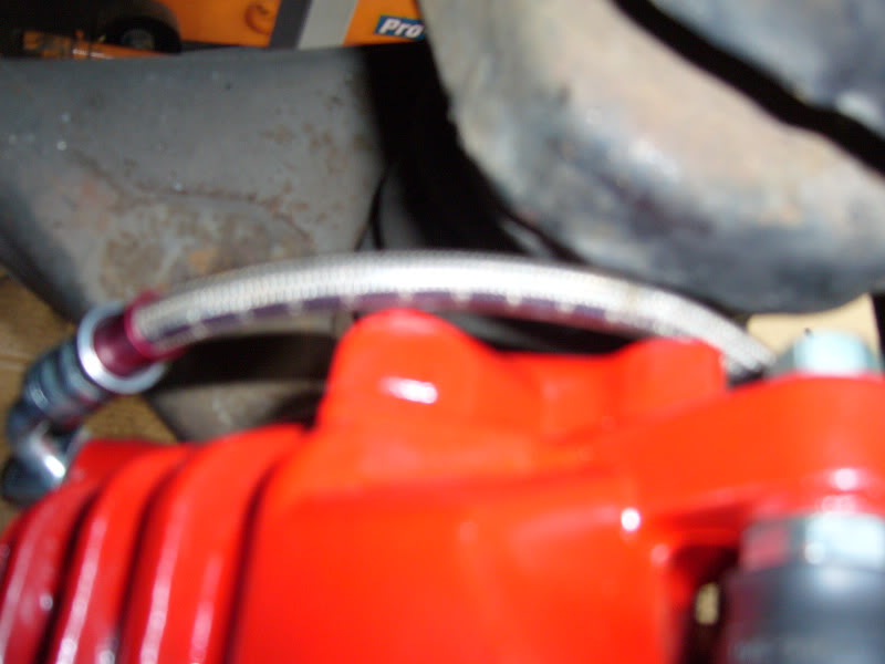

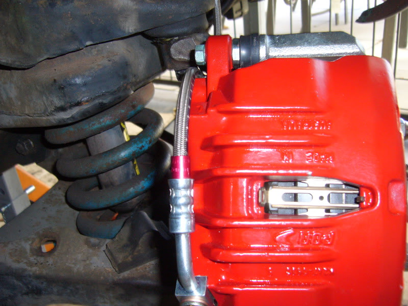

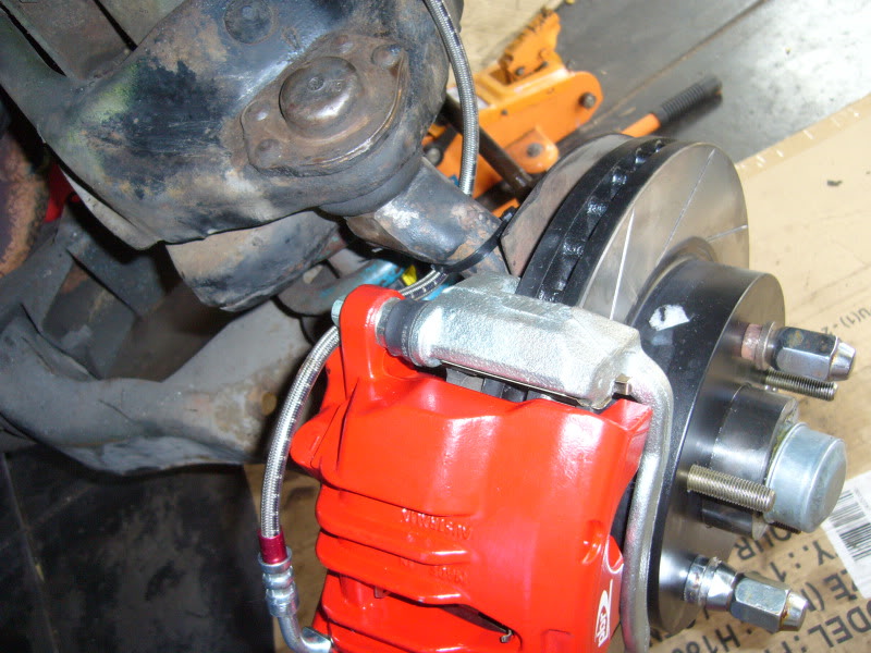

Next Question,whats to stop the brake line getting crushed between the caliper and that section where the top of your coil springs sit?,I mean if the brake line moves off of the caliper it will get squashed=
Sitting up in the caliper body like so its fine
but if it moves down,even though cable tied to stub axle it could still move to the outside of caliper like so and get squashed!
more pics
The only thing I can think of is to install another cable tie on the brake line to just under where the nut for the "caliper slides" are to stop the cable falling off the caliper body?,though ive never seen this mentioned anywhere or have I routed the hoses wrong??....
Edited by 76S.L.R, 25 April 2011 - 11:40 PM.
#65 dattoman
Posted 25 April 2011 - 11:39 PM
Put it up over the top of the balljoint
#66 _76S.L.R_
_76S.L.R_
Posted 25 April 2011 - 11:45 PM
I was going to but then looked at my Hoppers Instructions and on here http://www.hoppers.c...ranabrakes.pdf( step 13) both saying to run it under the stub like I have done?....
#67 dattoman
Posted 26 April 2011 - 12:55 AM
Was just a suggestion
Put them where they fit best
#68 _LS1 Hatch_
_LS1 Hatch_
Posted 26 April 2011 - 01:19 AM
On your hose....I had a similar issues when I made my brake setup...
I ended up just making some little metal clips to hold the hose near the ball joint bolt. Seemed to do the job well. As well, before bolting it in for the last time, I dipped the end of it (that goes around the hose) in some rubber coating to help it from rubbing through the hose at all...
#69 StephenSLR
StephenSLR
  • 6,717 posts
  • Name:Stephen
  • Car:1976 LX SL/R
  • Joined: 12-November 05
Posted 26 April 2011 - 07:24 AM
I was going to but then looked at my Hoppers Instructions and on here http://www.hoppers.c...oranabrakes.pdf (step 13) both saying to run it under the stub like I have done?....
Step 13 does say, the brake hose has to be secured at the top of the stub axle but the pic for some reason shows it underneath.
s
Edited by StephenSLR, 26 April 2011 - 07:25 AM.
#70 76lxhatch
Posted 26 April 2011 - 08:20 AM
Definitely under the ball joint but as high up as you can get it - I initially had mine wrapped in another piece of hose so I could tie it hard against the nut and cotter pin without damaging it. LS1 Hatch's solution looks OK as long as it allows the ball joint to be properly tightened.
I've since re-routed the hard lines and the caliper hose connects at the rear of the wheel well using a bracket on the side of the chassis rail.

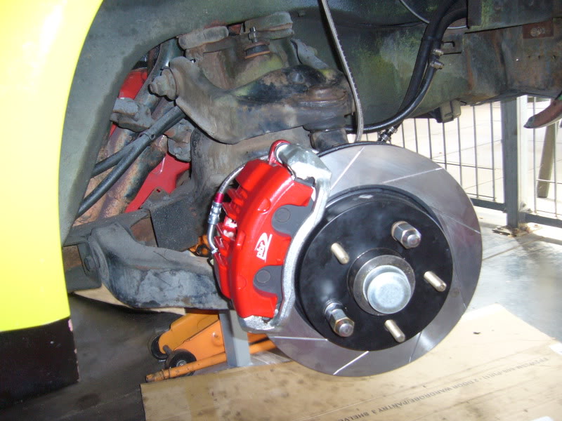

#71 _LS1 Hatch_
_LS1 Hatch_
Posted 26 April 2011 - 09:52 AM
Yes, they are tightened up properly and the cotter pins are in as well. (pictures as I was making it up and nothing was tight at the time)
Mine is with Brembo 4 piston calipers, home made brackets and 360mm Mercedes rotors.
