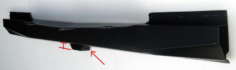

Can some one please advise the length of the dip in the middle lower part of the rad support panel? Basically how far down towards the ground does it hang from the horizontal section of the panel? If you can under stand what Im on about.....!!!!!

Posted 20 April 2012 - 09:04 AM
With a straight edge sitting on top of the support the gap in the middle is 20mm, this is on my rusty original support.

#72 hanra
Posted 20 April 2012 - 10:10 AM
This is what I was on about for those that think Im nutty...

Posted 20 April 2012 - 10:32 AM
Not quite what I measured. I measured the vertical green line.

#74 hanra
Posted 20 April 2012 - 11:55 AM
Ahhhhh... ooo lucky I put that pic up then!!
Can you give a measurement for the lower one that I indicated? How far down does it hang?

Posted 20 April 2012 - 03:49 PM
The original is a different shape but from the bottom of the support to where the nose cone bolts on is 15mm, and if you measure from the top it's 70mm
