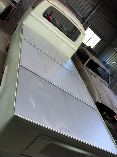

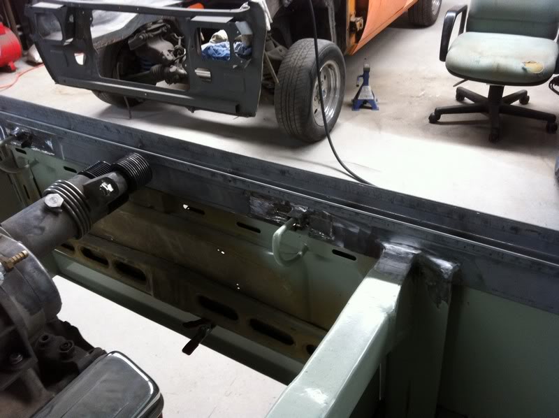

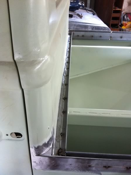

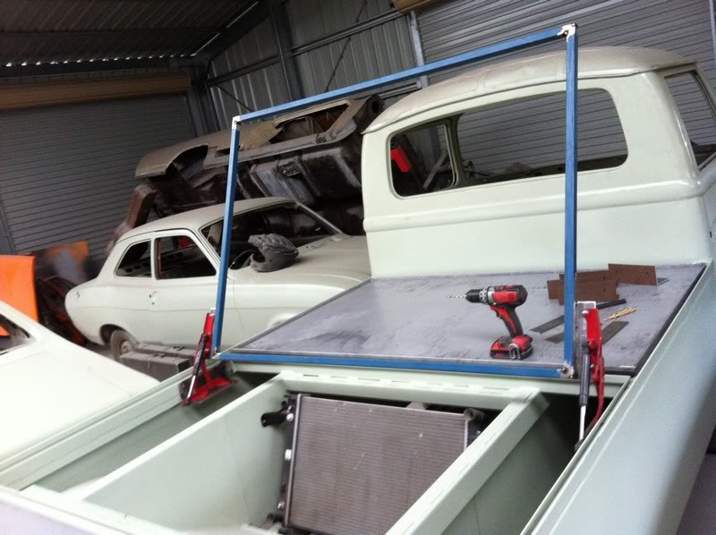

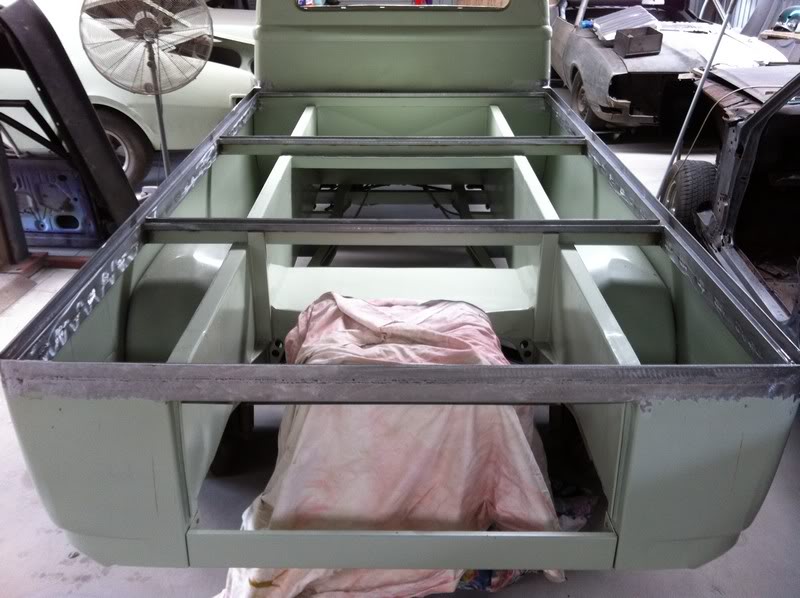

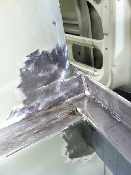

Well next thing I did was to box the little corner at the base of the cab on the drivers side.

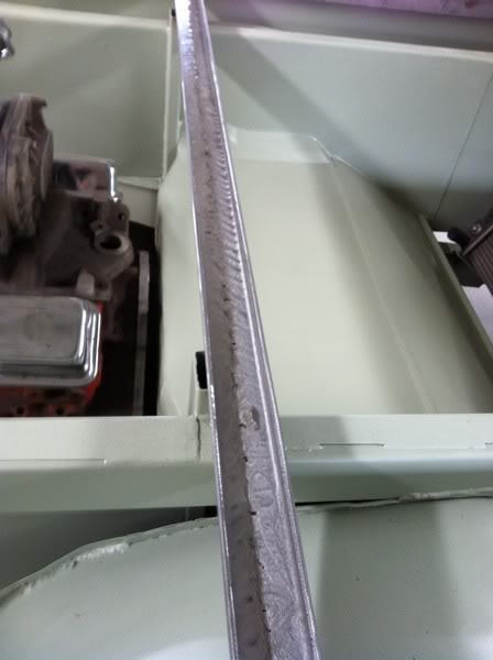

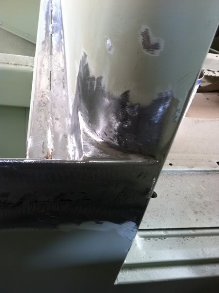

I then welded up the recesses I made in the rear piece to clear the hinge pins. I also cleaned up and welded the new piece to the top rails.

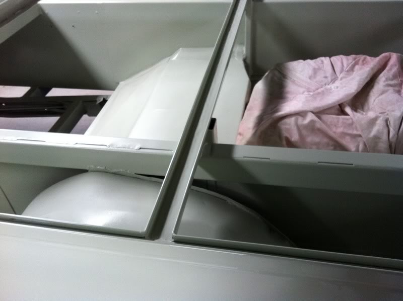

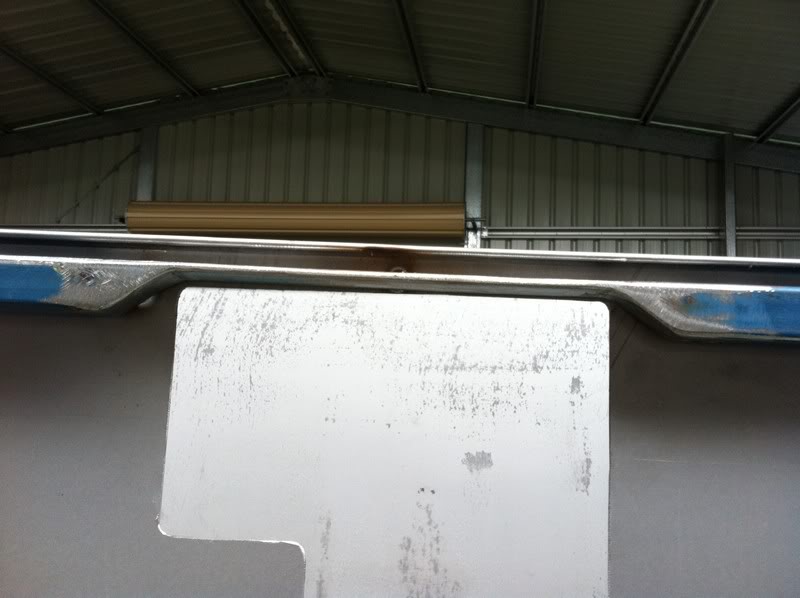

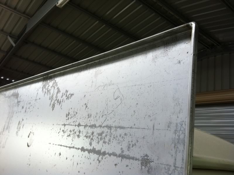

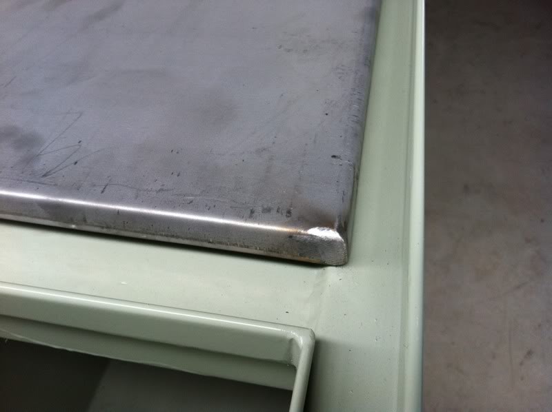

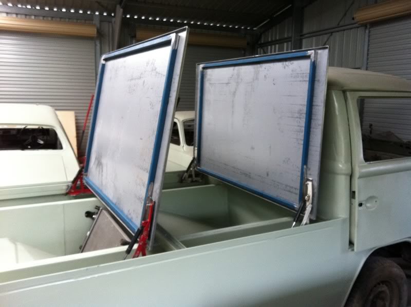

I also finished making all the lips for the 3 compartments.

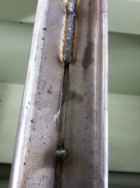

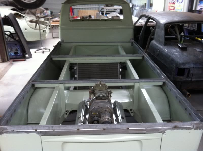

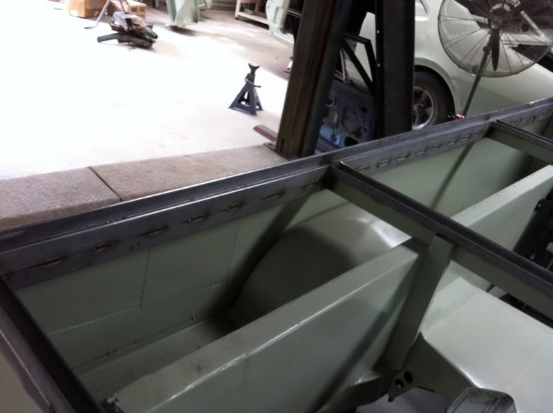

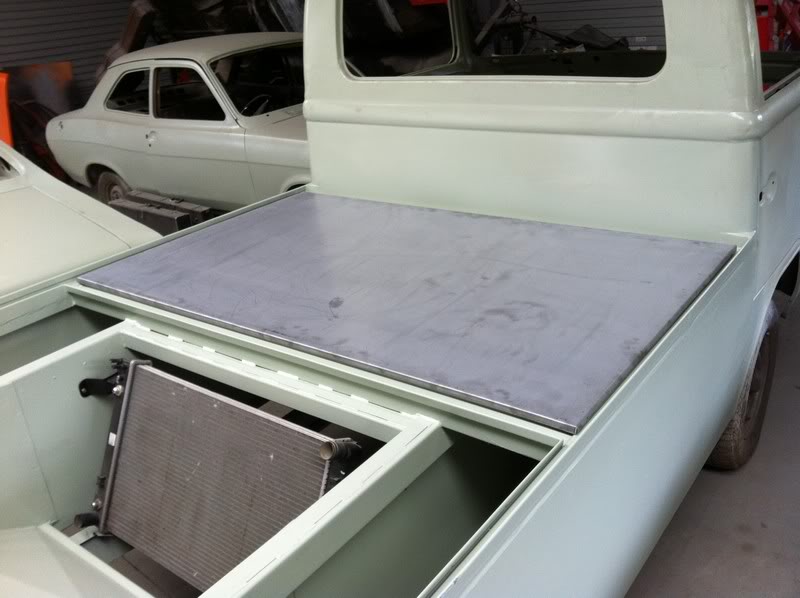

The two centre supports that run across the tray have a lip on each side. I left a gap in between them so when I weld them to the support I can weld them both at the same time.
So much welding! Each weld across the car is over 1500mm and there's 4 of them, and that's not including fully welding the lips around the outside of the tray!
Then of course comes the grinding. How fun hahaha!

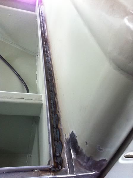

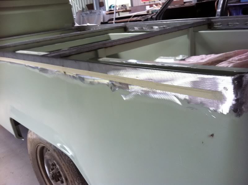

I then stitch welded the side lips on.

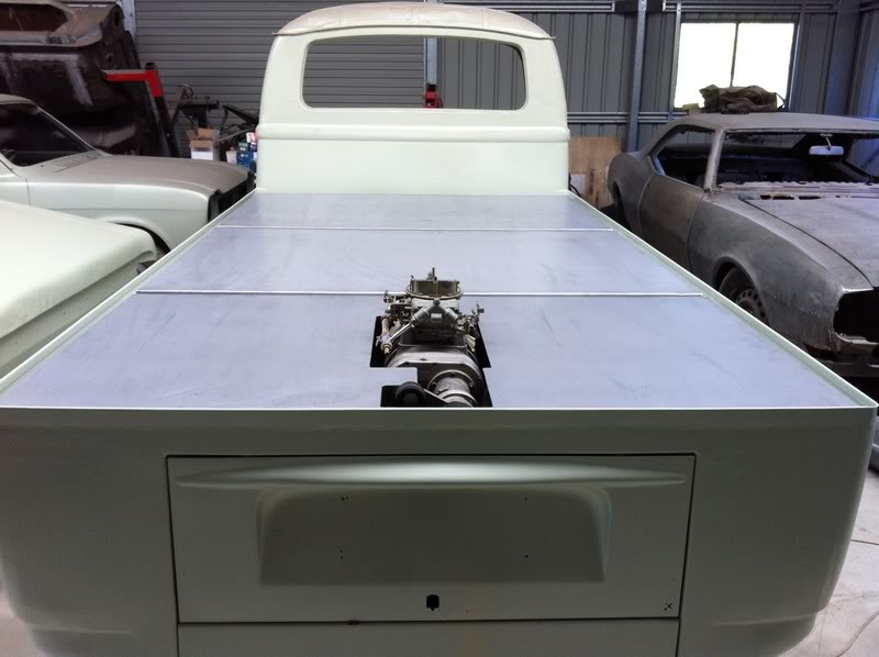

I then welded the rear piece along the outside, and prepped all the new metal for etch primer.

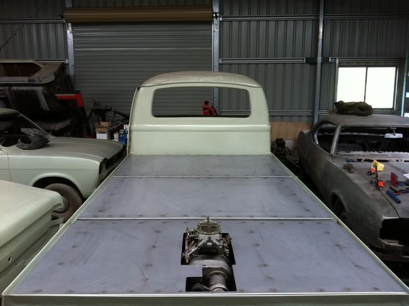

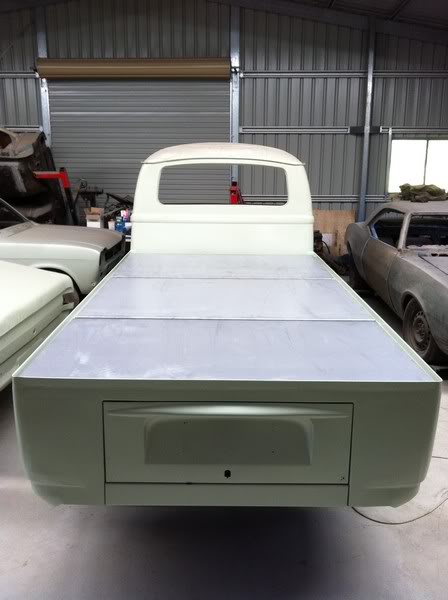

I wasn't in the mood for welding the sides up along the top of the quarters but I wanted to get some etch on it so I just taped up the join so I don't have to dig primer out later to weld.

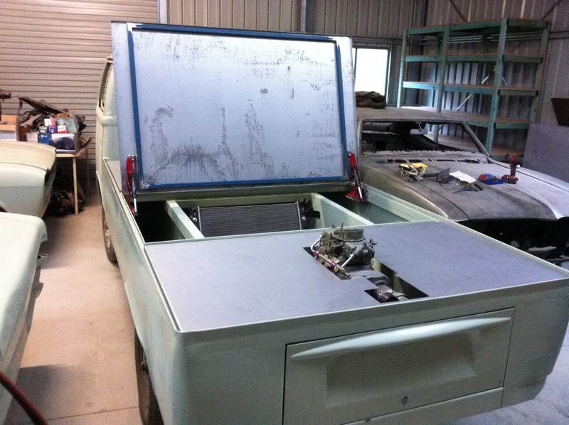

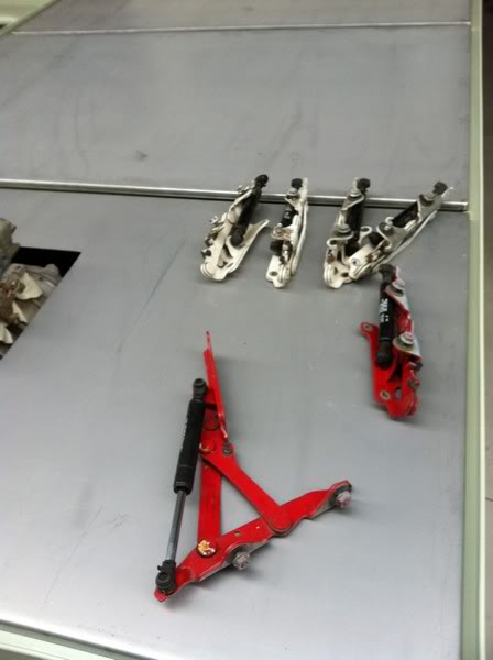

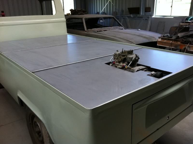

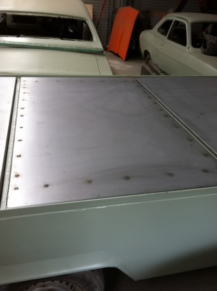

Well it's getting there but there's still a lot to do even just for this part. I still have to put the drain pipes in, but that'll be easy, and make the lids for the 3 compartments and figure out hinges and catches for them. Then I still have to weld down each side which I'm not looking forward to, mainly because I'm lazy : )
