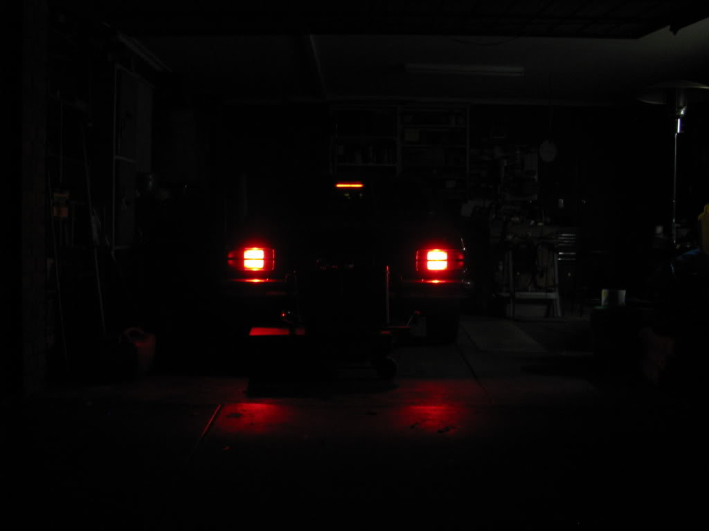

Hi guys & Gals
Before i saw this thread i purchased LED globes for the Hatch from http://ledshoponline.com/
As some would be aware i am absolutely paranoid about how bad the lighting is on the back of my car and worried about when (Not if & hence the high brake light) i will be tagged in the back due to the poor lighting.(I have seen some of the damage done in threads added here)
I am extremely happy with my purchase, the lighting is now brilliant, I checked the lighting prior to fitting the new globes and the L/H tail-light was virtually non-existent in daylight.
Now clear as,
Even colour and filled with "RED" light (My lens are quite badly faded & using LH diecast backing’s not white plastic) and the LED's are red for stop & tail and amber for the indicators.
I would suggest that everyone should invest in LED's, be it from Milco or other suppliers as it makes a big difference to how your pride and joy is seen on the road (I'm converted)
