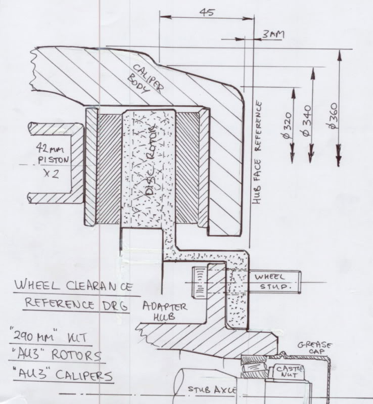

Thanks for the info mate!!,Heres a pic below of info Hoppers sent me on their 290mm kit's Dimensions, obviously bigger than HQ Calipers so will have less clearance in the wheel,how much less I dunno?. Anyone know how much all this differs in relation to overall size to HQ Brakes??

Just curious, isn't it only the diameter that will affect the hoppers kit? ie: If a 15 inch rim clears the caliper, then offset has nothing to do with it?
Well yes and no, 15" Simmons wont fit Hopper Stoppers without spacers for some reason?,I read on the hoppers site that some Weld wheels might have fittment issues.
Was'nt sure what the back of the draglites were like,if the area where the Hub Bolts on is recessed then the hoppers kit has problems clearing the Calipers also if a wheel has a "SOFT LIP" then the inside diameter is reduced and again gives clearance issues with calipers..... though after seeing the pics provided of Draglites it looks to be fine?

I have measured the rim inner and at 320mm you hit the edge of the soft lip in the mounting face plane. The diagram you have given suggests the caliper edge is starting to curve just before this point + the 3mm space. It would be a pretty tight fit but probably OK by the look of things. I dont suppose hoppers make a kit with the hub mounting face an extra 5mm further out relative to the caliper? This would pretty much guarantee clearance.
Damn!, sounds like it will be really,really close then if it does fit at all?,I dunno if Hoppers make differing hub mounting face dimensions?.
So the Draglites a Soft Lip Wheel?,I read in my many hours of googling that Soft Lip Wheels Cause problems with the Hoppers kit due to the reduced inner Diameter,I really dont want to run Spacers as ive seen too many go wrong on various forums!...

Damn Im pissed off=.... the Draglites WONT fit!!!, heres the situation
I went to Chris Mills today with the dimension sheet of the Hoppers kit and took a tape measure= the overall distance I need for the brakes to clear inside the back of the wheel running the smaller 290mm Hopper Stopper kit is 360mm ( 14") but the lowest end of the rear of the 15" Draglites is measuring in at only 315mm because of the lip design on the wheel!. Higher up on the wheel it measures in at 365mm but the lower end wont clear without spacers,which I wont do.
The narrower end of the calipers needs only 320mm clearance but it angles up getting thicker as it progresses and this is where the reduced ID section is in the back of the Draglites so it will foul on the Calipers there.
I also measured the inside of 15" Convo Pro and even those wont clear the Hopper Stopper Kit!!!,the rear ID on those comes in at 340mm,if I had known all this previously I wouldnt have bought that hoppers kit,worst thing is I have no idea what wheels I am going to be able to buy that will clear those brakes?!.

Just an update,I found out today that the Centrline CONVO ET also dont fit the 290mm hoppers kit( wheels wells are 355mm).
http://www.vpw.com.au/productgroup.asp?CatID=15&SubCatID=1136&priorCatID=1136&PrdGrpID=4720
Neither do RIDDLER 685 with a wheels well dia of 350mm
http://www.vpw.com.au/productgroup.asp?CatID=15&SubCatID=1133&priorCatID=1133&PrdGrpID=5441
Those Convo Pro ET would have been awesome! but I need 360mm clearance so no go( maybe I need to get the grinder on the calipers LOL!)
