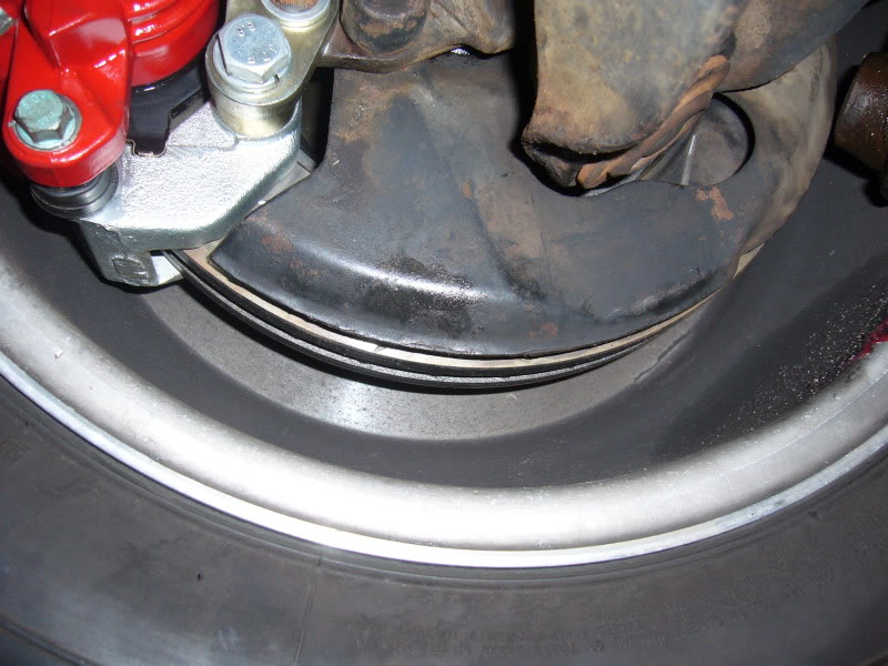

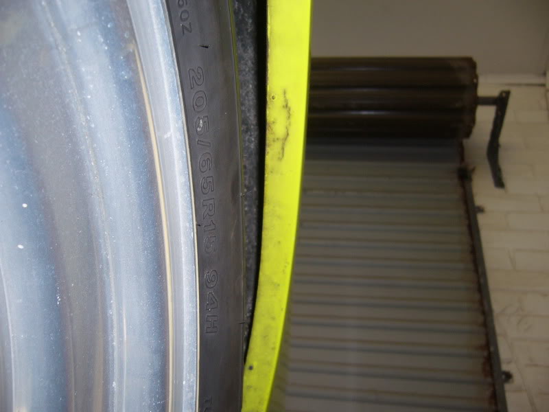

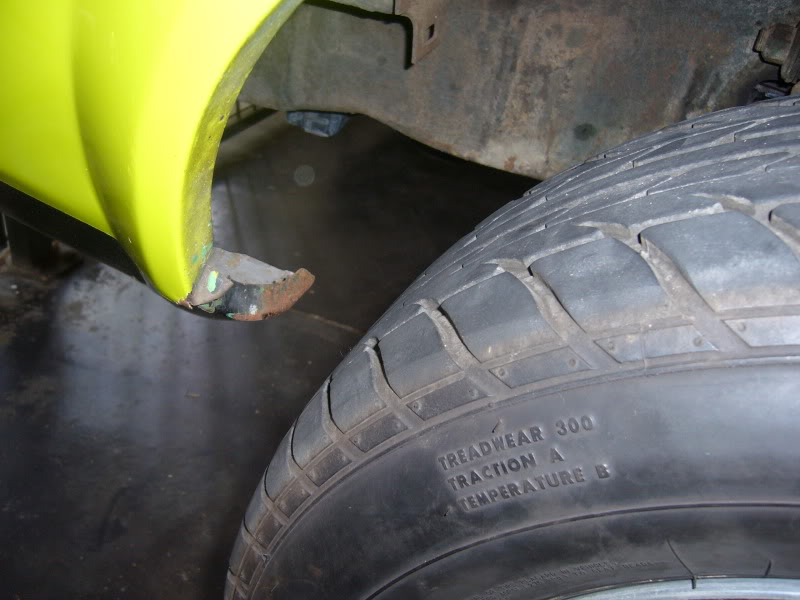

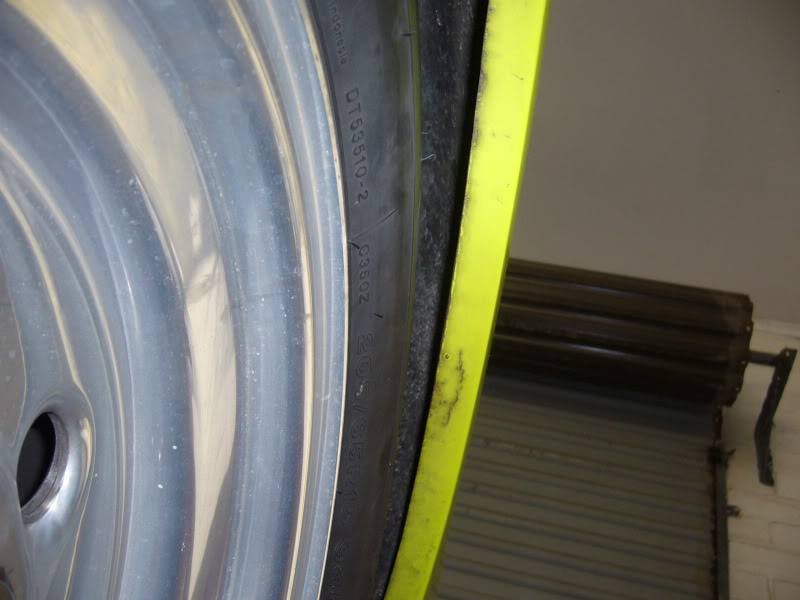

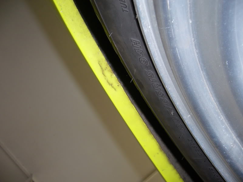

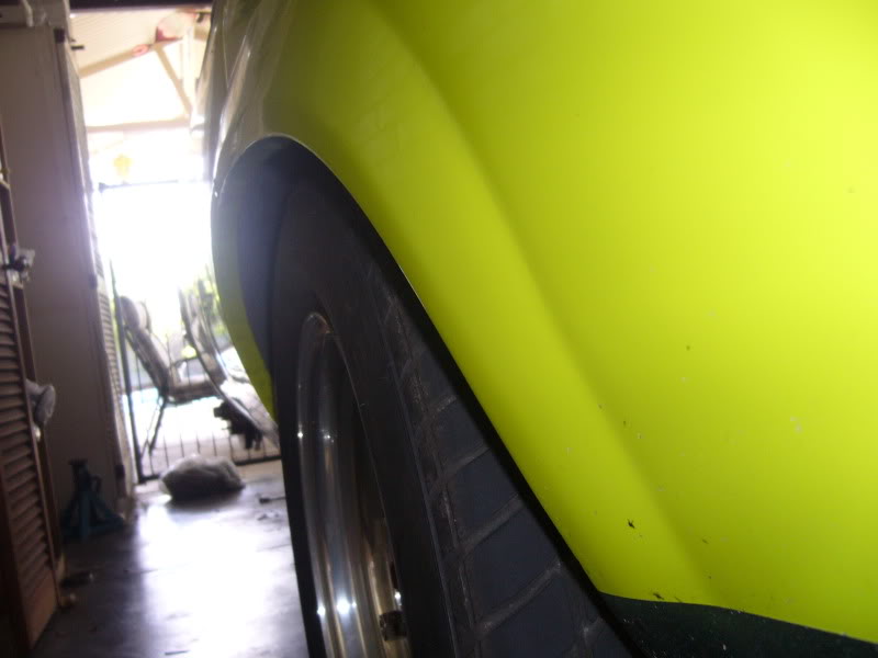

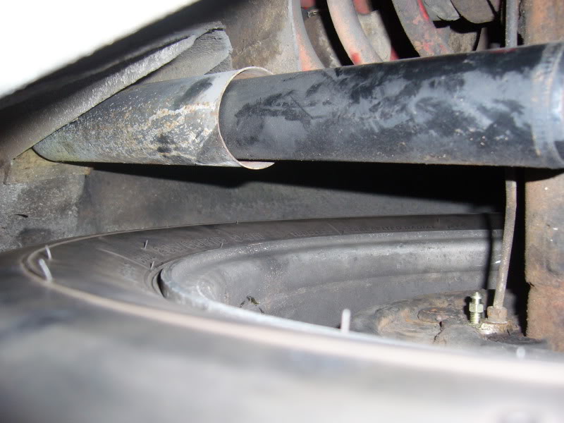

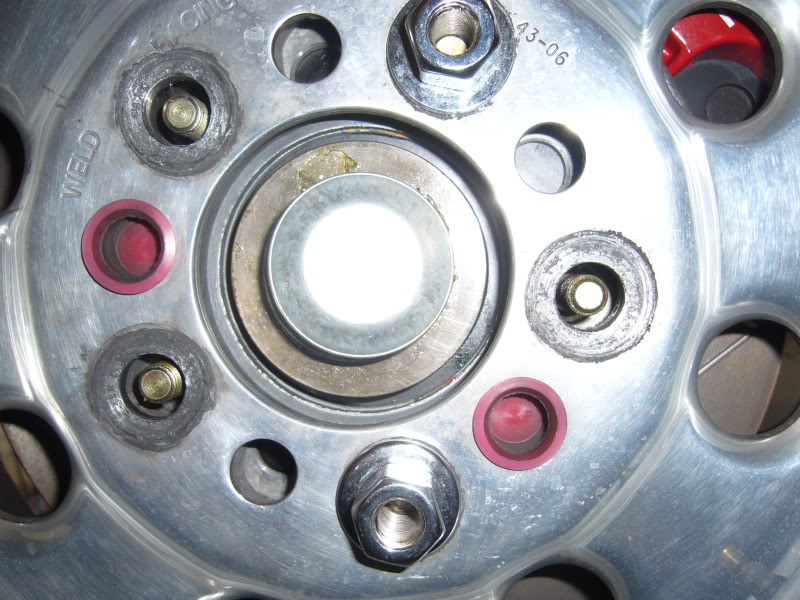

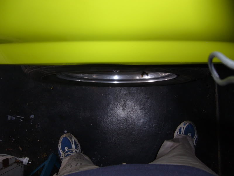

Heres pics I took yesterday guys, just realised the Tyre was 65 series not 60( 205/65/15, 4.5" backspace)
I dunno why but in my pics it looks like the rear will clear the guards,maybe the angle I took them on?,it definately looked to me yesterday that if the car was lowered down on these wheels the guards would rip into the tyres( rear only).
Brake clearance
Front wheel

REAR WHEEL Fittment
Also I will need some Wheel Centering rings as can be seen here on the fronts with the hoppers kit

It will - not particularly nice looking though and a tyre place may or may not do it for you. The ones I've seen I would be satisfied that it is safe (may depend on the tyre, they're not all the same despite supposedly universal sizing), but usually not much point when it would be so much better on a 7" wheel.
Looking at those pics I can see that the rear tyres would definitely catch on the guard lip, but if they are rolled properly you'll gain a lot. I would still be aiming for a 225 on the 8" wheel with 5.5" backspace. Unfortunately for you everything is so close that you really need to try it to get a definitive answer (and this was always going to be the case unless you go significantly narrower), but I would be optimistic based on what's been said in the dozens of threads about wheel fitment on here - perhaps spend a bit of time dragging back through them to see if anyone had the exact combination you are looking at?
Turns out the brakes weren't a big deal after all, isn't building a car fun...?

Fun?, not for me LOL! the top of the tyre looked to clear but where it bulges out on the sidewall would definately foul on the lip,im hoping to get the 5.5" backspace 8" with 215/60 on the rear after I get the guards rolled but I just dont know if it will clear?,if it does it will be close.

Rolling the rear guards does not achieve a great deal. If you look inside the rear guard you will see that the wheel well steps out just above the lip.
I made the mistake of rolling the lip on my rear gaurds. If I was to do it again I would just trim 5 mm off the lip.
