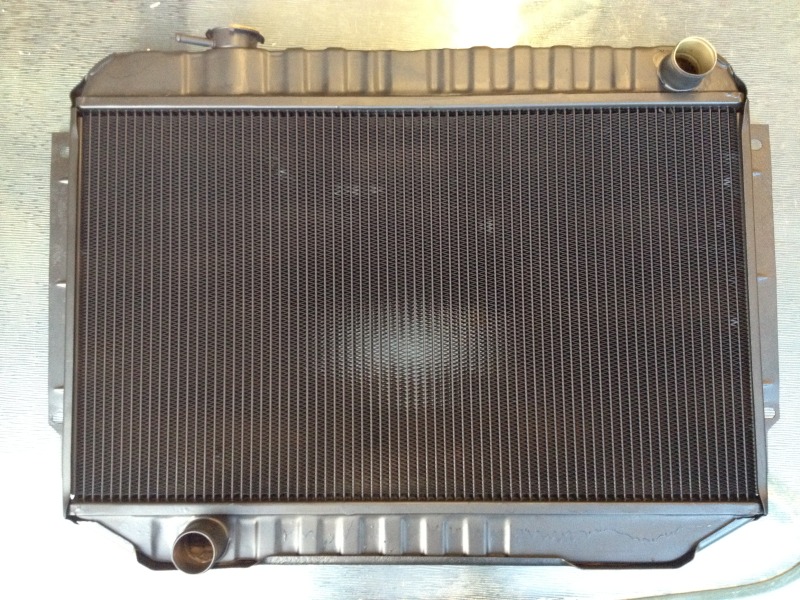

Posted 10 September 2012 - 10:17 PM
Tailshaft new uni's fitted and balanced. Was $266 to balance and fit supplied uni's.
Tried to fit the tailshaft but the diff shop have fitted the incorrect yoke to my diff.... so that needs to all come out again to get that fixed.... f*ck me....
Also the radiator is right to go. New tanks and core and correct mounting bands. $566 plus $50 for the bands..... Expensive 2 core radiator...

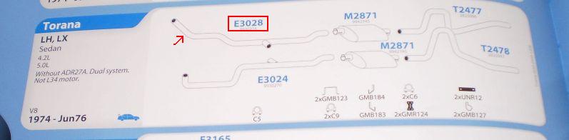

#716 _lx77slr5k_
_lx77slr5k_
Posted 12 September 2012 - 03:44 PM
Hey mate great job on this build just caught the ass end of this issue what you missing from the exhaust drivers side e/p? I am an exhaust fitter although my shops in Sydney let me know what you need and ill see if i can help at all
#717 hanra
Posted 12 September 2012 - 04:10 PM
Hi Carl.
Long story short.
A company in Perth was going to supply me with a stock standard exhaust to suit LH Torana.
Engine pipes from exhaust manifolds to mufflers (2in diam)
Mufflers with 2in inlet and 1 5/8 outlet
Tailpipes 1 5/8 diam.
However they have advised me that they cant supply the Drivers side engine pipe from exhaust manifold to muffler......
I was intending to purchase everything else however. But Im trying to avoid having to take the car into an exhaust shop to have this one pipe custom made up..... It will be an expensive exercise as the car is not startable nor driveable.
#718 _mickss_
_mickss_
Posted 12 September 2012 - 04:35 PM
Brad
Did u try Jase @Tuff Muff?
#719 _lx77slr5k_
_lx77slr5k_
Posted 12 September 2012 - 04:39 PM
ok yeah ive spoken to my suppliers here and they have said the same thing i was hoping it was a single as surprising they still had them in stock which will be the picture above in the book you have there i have alot of old program cards ill have alook tonight hopefully its in there and i can make it up for you
