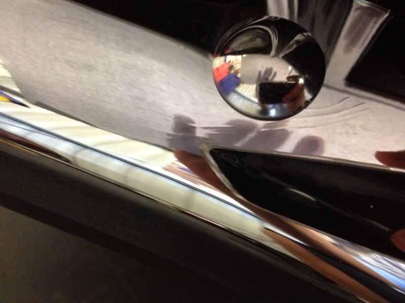

Anyone else ever had this type of issue? Its cracking around the upper mounting bolt. It was torqued up to spec. None of the other 11 bolts have given any problems. I will have to send the bumper back I would assume... $100 down $100 back... and what ever other costs are involved to repair.....

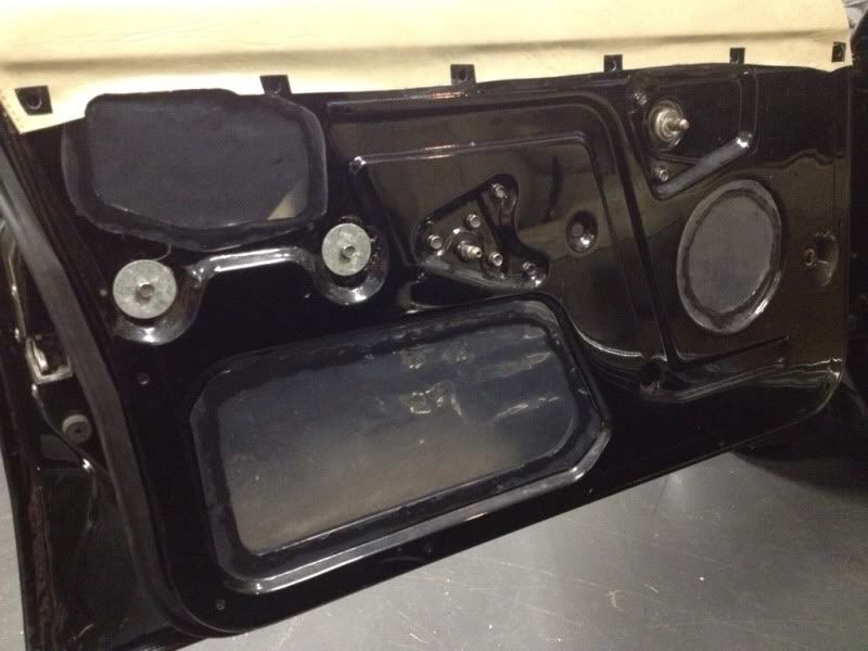

And plastic??? Sealing up my doors. So messy...
Great job thus far you have done, may I ask what sealer you used on the plastic?
#922 hanra
Posted 28 November 2012 - 10:46 AM
Cheers mate.
I used the same goop I used for the windscreen. It never actually dries. Its always sticky... Ill have to check the brand.
#923 TerrA LX
Posted 28 November 2012 - 11:04 AM
Mastic, no worries, thanx mate.

My $600 front bumper bar isnt looking to flash after being bolted up for almost a week.....
Spoken to the Electroplater, as expected, I was blamed for over tightening. I used an annually calibrated torque wrench and tightened the mount bolts up to 25ft/lb as per the GMH Workshop manual.
Apparently the plater always advises customers to only do these bolts up finger tight, then apply loctite to the threads to avoid this exact issue. I was never advised this verbally or via email, which he agreed with. So how am I supposed to know otherwise... I do things by the book.
In the end, he has agreed to cover the costs of re-plating, I will have to wear the costs of freight. It was $185 to get both bars here. Will be interesting to see what it costs to send one bar down/back.....
And of course he is flat strap over Xmas and expects a delay in getting the bar turned around. This sort of thing is pushing me over the edge.

#925 Mort
Mort
  • 2,760 posts
  • Name:Mort
  • Location:Moranbah, QLD.
  • Joined: 16-December 07
Posted 29 November 2012 - 05:40 PM
FFS Brad, are you Eva gunna get a break.
So what's the difference between the original chrome plating and the ones you just got, surly if he job was done properly it wouldn't have cracked.
Is there any ex- workers from GMH on here or anyone know someone that had anything to do with the bumpers back then to shed some light on te difference.
