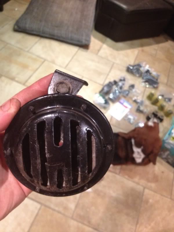

SLR High Note Horn all good to go! Still works to!!!
Can you confirm that your car didn't have a captive nut welded in for the high note horn Brad? My car doesn't have one. I am guessing that the horn you bought came with an Ajax bolt and nut?
Edited by Shiney005, 01 September 2023 - 04:23 PM.
#1362 hanra
Posted 01 September 2023 - 08:05 PM
Judging by this. I’m going to say there isn’t a captive nut. I can’t recall and it’s tricky to see with the radiator in the way.

Posted 04 September 2023 - 09:04 AM
No captive nut on my cars, nut and bolt as shown in the assembly manual. There are horns very similar to the Torana high tone which can be had for a fraction of the price. The principal difference is in the mounting tab but this is easily modified. For this one l cut off the mounting tab  and made up a mounting tab as per Torana and a quick mig weld later had a passable high tone horn.

Posted 04 September 2023 - 06:02 PM
I actually have a few of the high note horns in the shed Tim. I just thought that because the low note had the square nut welded to the radiator support panel the other may have it as well. It could have been a way to check for originality of higher spec models.

Posted 04 September 2023 - 06:13 PM
Can't help with LH models but I can confirm my LX hatch only has one captive nut (can't remember which side) and the other side is just a hole in the rad support as per the diagram above. Cheers Ron

Only one captive nut on the passenger side, drivers side is washer and nut.
