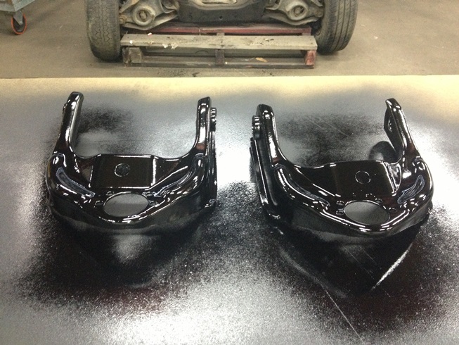

Got around to painting one side of the sub frame and control arms etc. Turned out ok I think.
Attached File  Sub Frame Paint 01.JPG   125.38K   8 downloads
Attached File  Sub Frame Paint 02.JPG   123.79K   7 downloads
Attached File  Sub Frame Paint 03.JPG   144.74K   10 downloads
Turn them over and paint the other side next...

#140 eyepeeler
eyepeeler
  • 1,963 posts
  • Joined: 16-August 08
Posted 15 May 2013 - 10:56 PM
Hey Welby, its the original one that was in the car when I bought it. The one I painted today came from forum member outer control. It came from a UC as you have probably figured out.

Posted 18 May 2013 - 02:16 PM
Have just finished painting the front end parts.
Now its a waiting game until the springs, shock, bushes etc arrive and I can start to put it all together.
Attached File  01.JPG   199.34K   11 downloads
Attached File  02.JPG   272.23K   10 downloads
Attached File  03.JPG   208.67K   11 downloads
