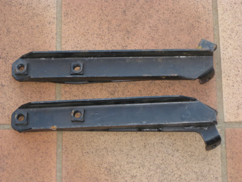

LJ 6 bangers with 10A on the compliance plate use the standard type splash guard and the two small inner front bumper bar brackets .
Cars with 10B on the compliance plate use the reinforced splash guard and have two reinforced inner front bumper bar brackets .

These are the ones with the front mounted rails ,

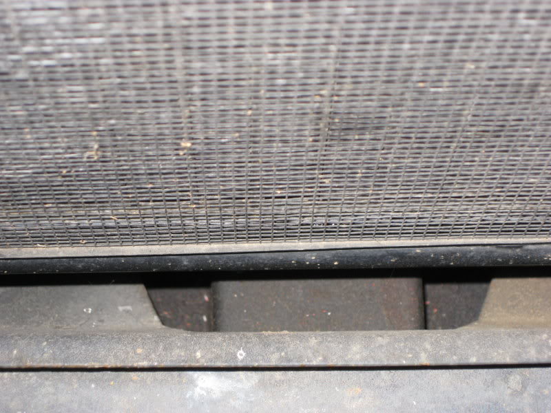

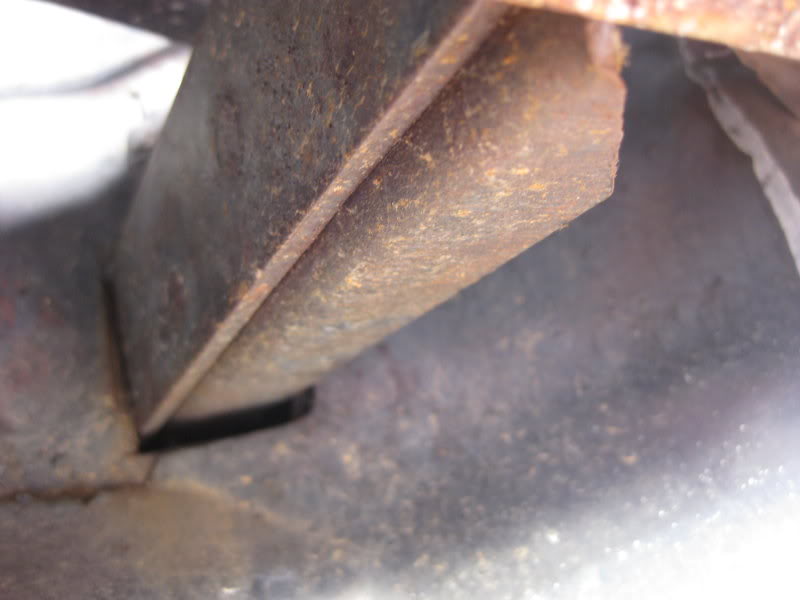

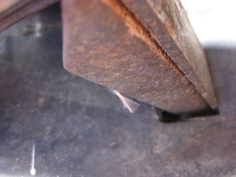

10B car identifiers
This is one of the reinforcing arms on the splash tray which fit into a corresponding cut out in the panel
Reinforced inner bumper bar brackets
Left and right inner bumper bar brackets in situ
It is inevitable that some 10A cars have the reinforced splash tray and brackets that were fitted after the car was crashed because they could not source the earlier parts.
