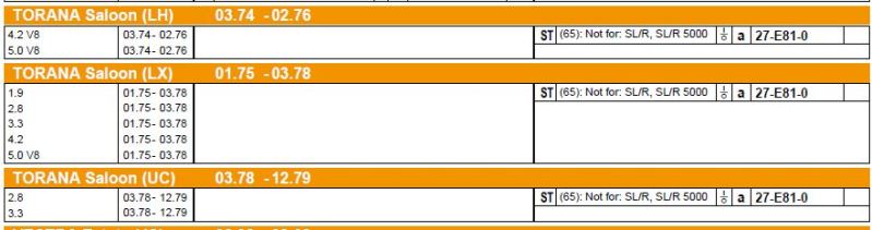

#36 hanra
Posted 28 October 2012 - 10:30 PM
Interesting extract from the BOGE catalouge. Not for SLR?
#37 hanra
Posted 28 October 2012 - 11:01 PM
Details from the body of the rear shocks.
E 617
Made is Mexico
292 / 10
