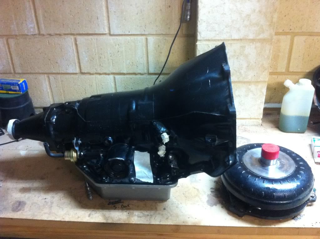

Quick update brought the trans, it’s a th350 apparently good for 700hp here’s a pic
needs a good tidy up to get it up to standard (take all the little burrs off and give it a clean smooth paint job)

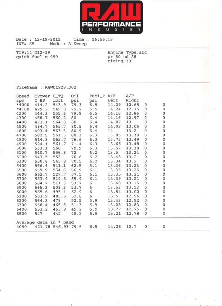

motor also came off the dyno yesterday here's the vid and read out
http://s1085.photobu...W434-101928.mp4
looks like it may be turning up a little later than expected due to christmas being here but should land in australia end jan early feb 'fingers crossed'

i would be asking why it still is using a vacum modulator on the gearbox. A t350 to take 700 hp requires a fair bit of tlc and you need to ask what has been done to it and what aftermarket parts have been used. A well built t350 is a good combo in a Torana over a powerglide which seems to be the common fitment with a small block chev.
#43 jonesy
jonesy
  • 637 posts
  • Car:hatch
  • Joined: 16-August 10
Posted 23 December 2011 - 02:00 AM
i dont know alot about gearbox internals but thats what the guy who owns town and country automatics told me he also said if i can break it he can replace it as his rep is on the line.
this is what it reads on the invoice,
stage two shift kit, TCI deep pan, 36 element direct clutch drum, red eagle racing clutches, dual feed top clutch, 20,000km warranty
any experts out there know what it should handle?
will it handle what i have got?

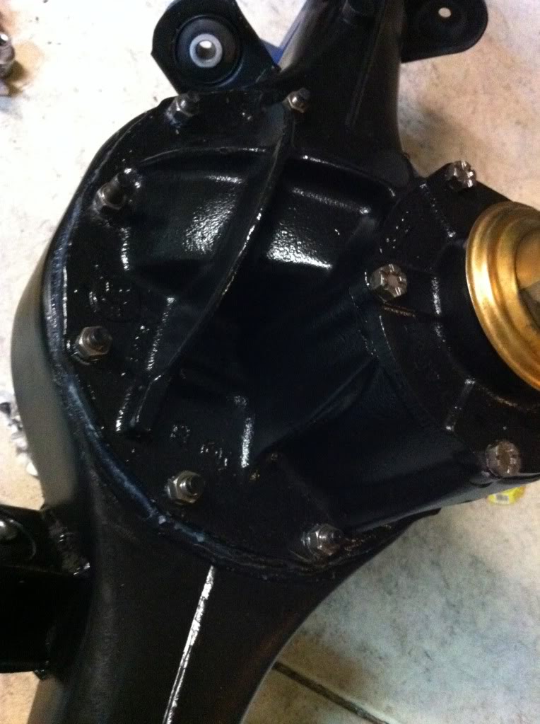

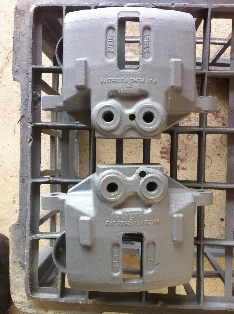

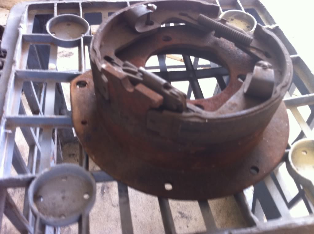

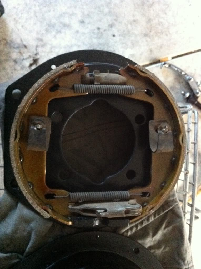

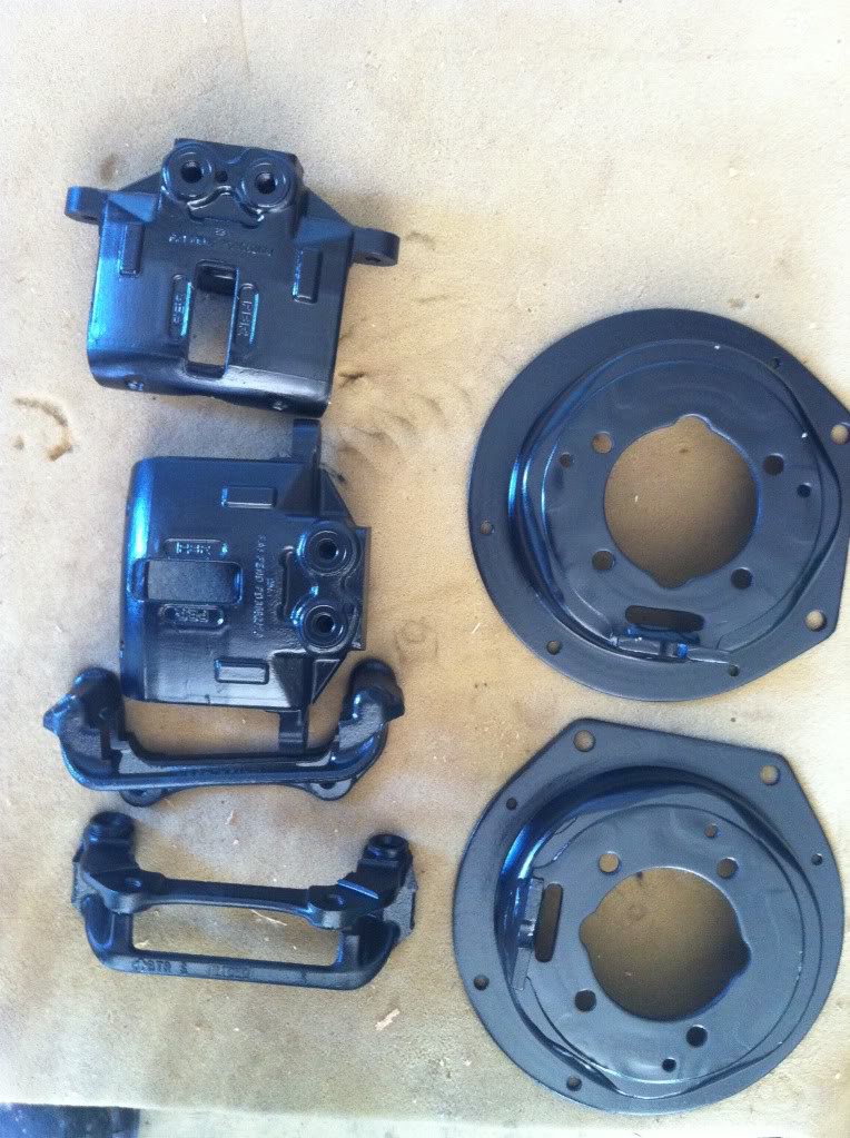

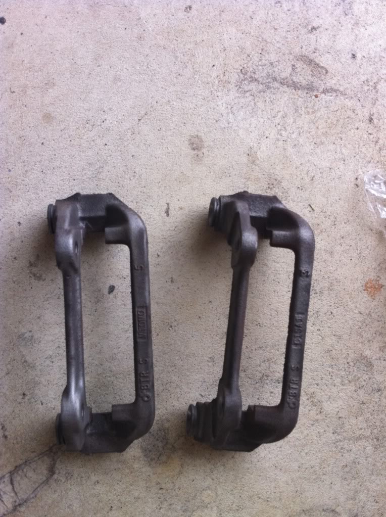

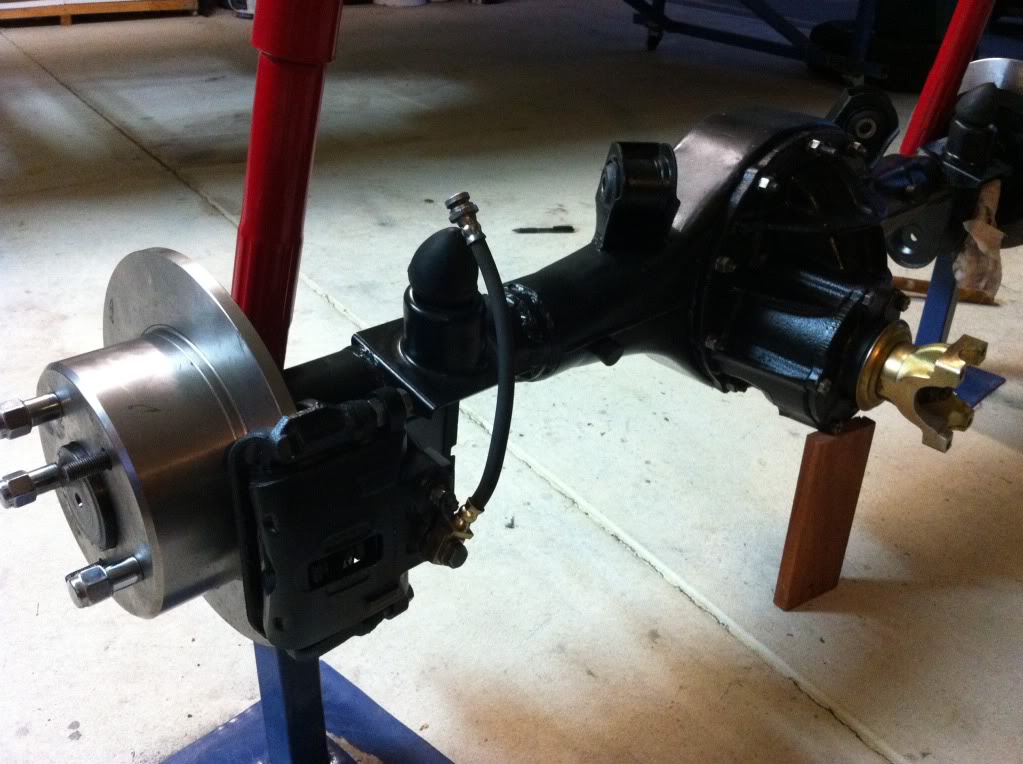

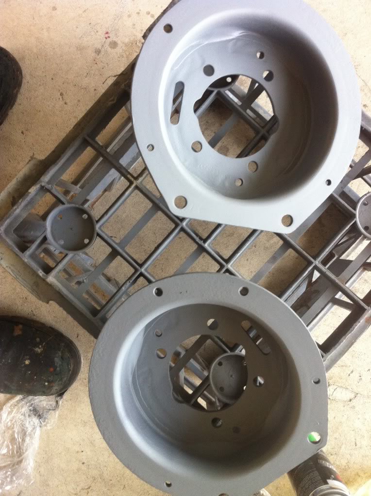

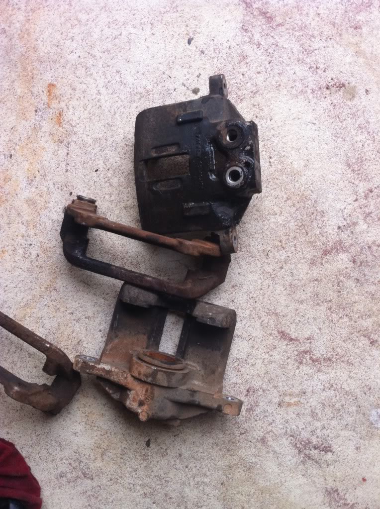

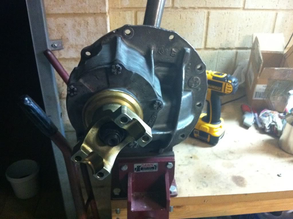

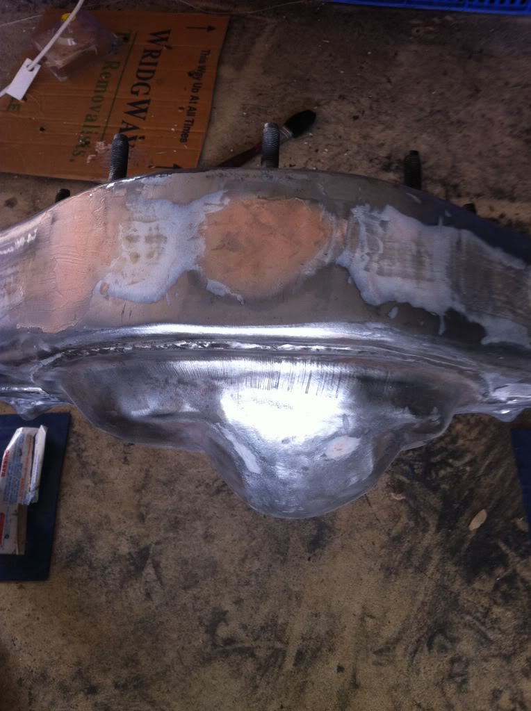

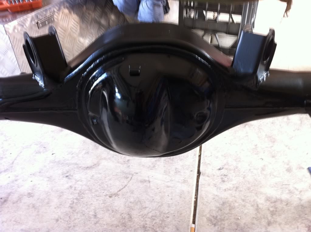

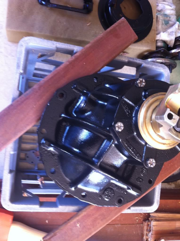

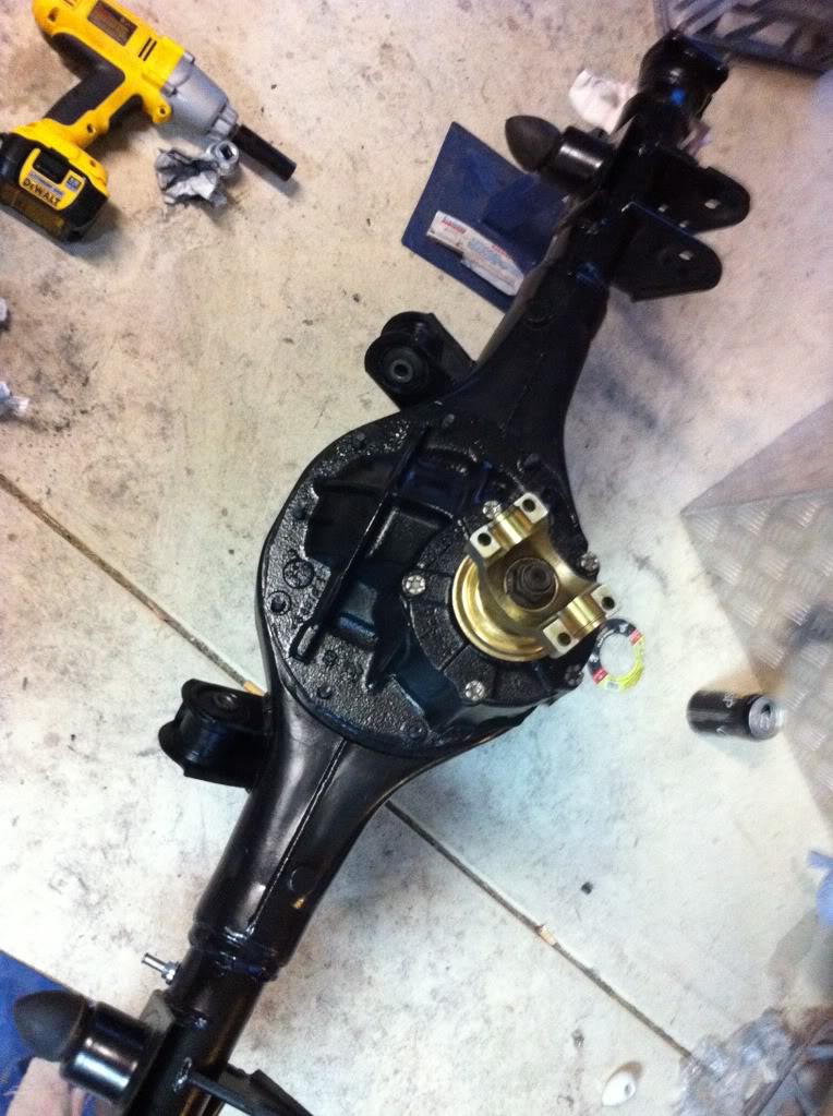

Posted 29 January 2012 - 02:57 PM

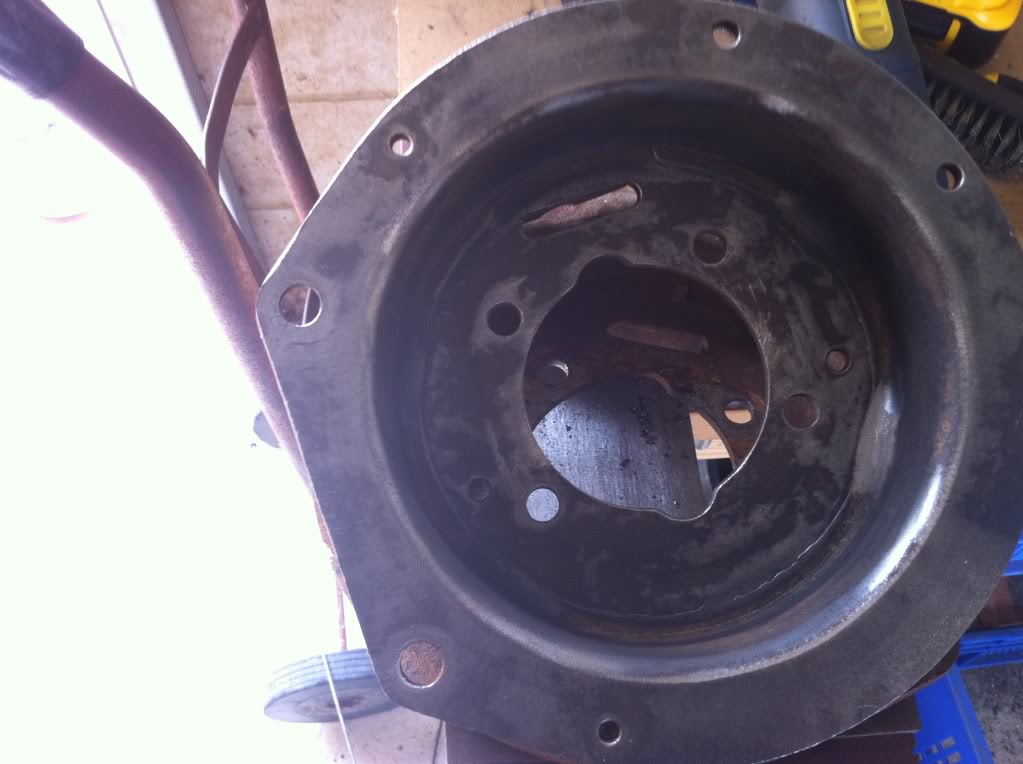

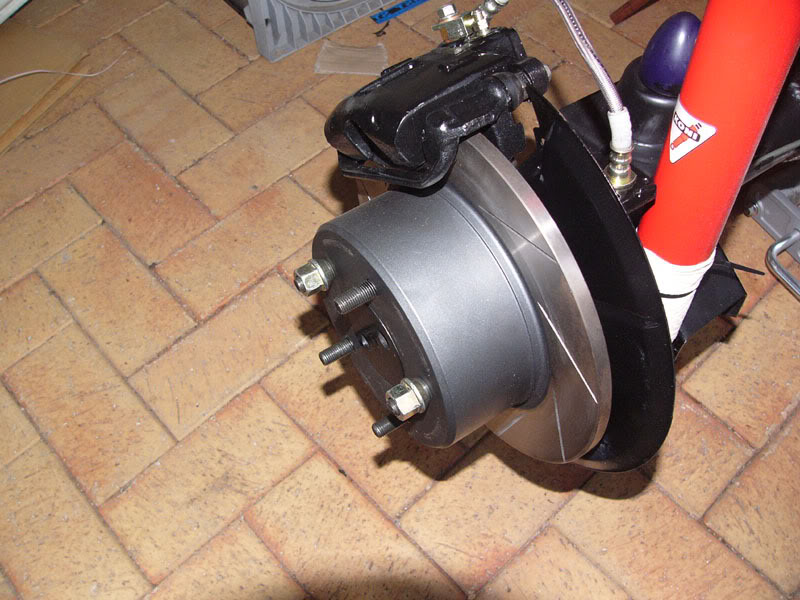

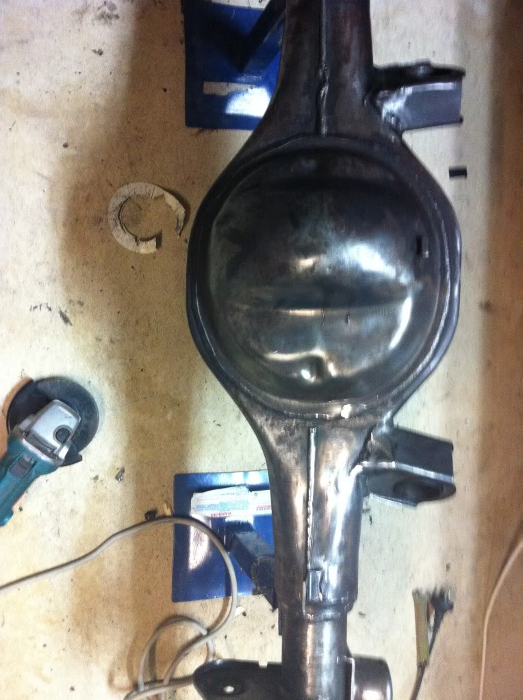

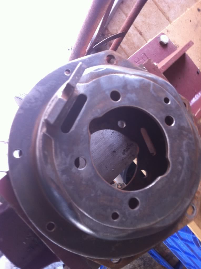

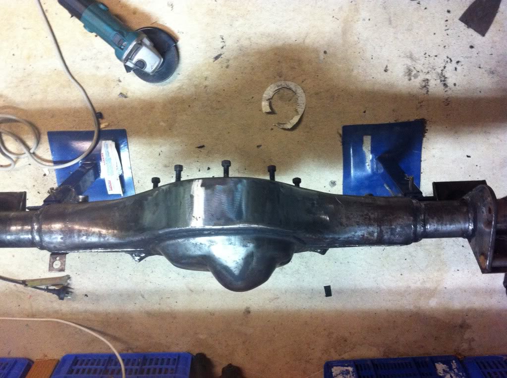

well after hunting around i have found a diff and i came at the right price and all that i was after.. it needed a bit of TLC but it has come up nice.
PS 1420mm from face to face.
housing paint strippedand sanded
little imperfections filled
i sand blasted and painted outside of centre and fitted with new over sized diff pinion yoke

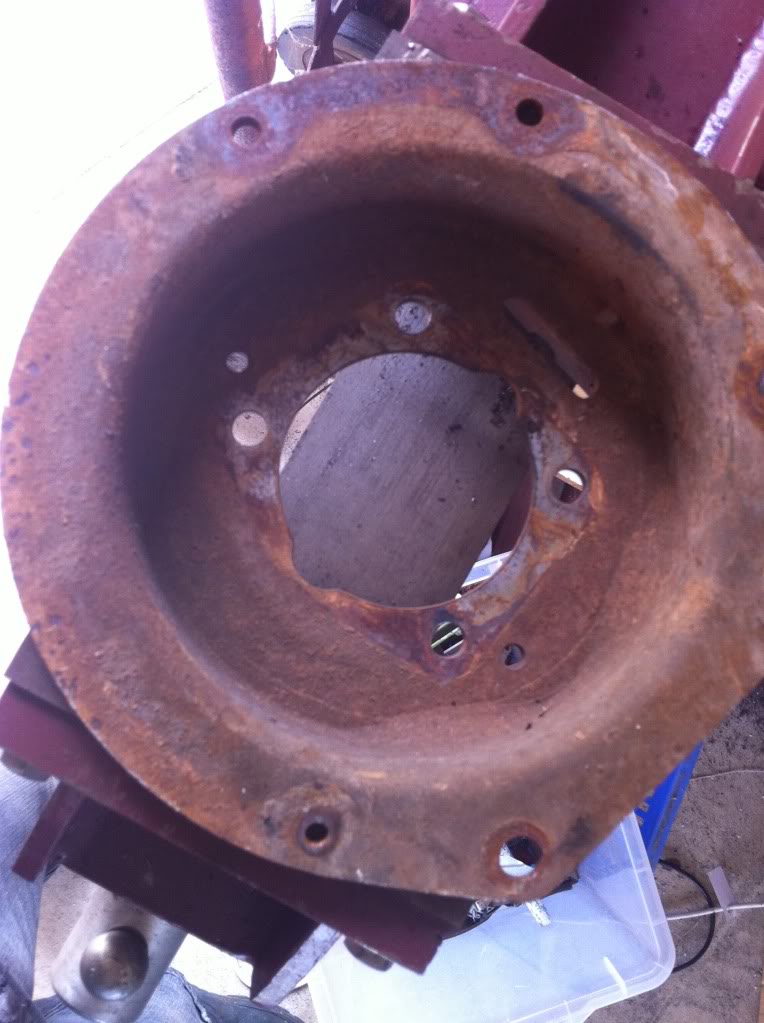

disk brake backing plates ready for sand blasting
after old shoes removed and blasted

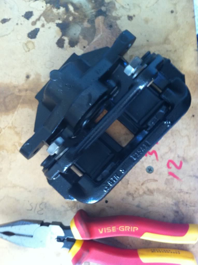

bit of primer

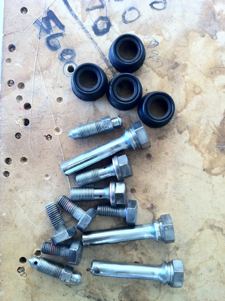

and the same with the calipers
bit of black
little clean up of bolts and rubbers
caliper going back together
backing plate has got new shoes
some paint on the housing

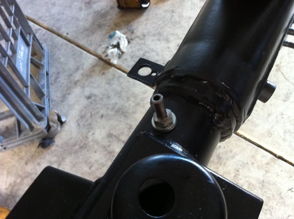

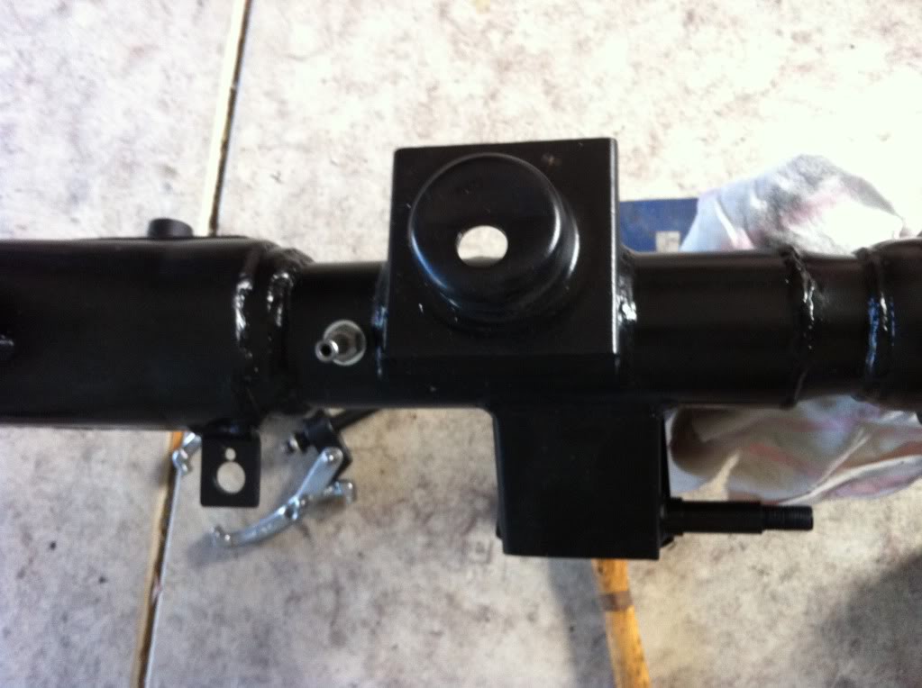

for some reason there was no breather on the housing so i put one on

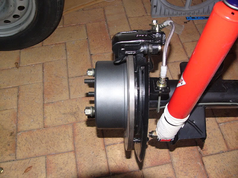

pressed the new trailing arm rubbers in and fitted the centre

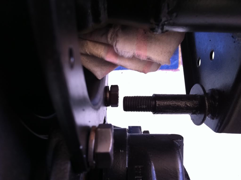

fitted calipers, backing plates facing forward as the clearance in the rear position was up to sh#t between the shock and caliper axles in and new rotors got them shaved on the inside to mactch the hq diameter
also heres a pic of the backing plates in the rear position
#46 ls2lxhatch
Posted 29 January 2012 - 03:07 PM
The only problem with mounting the callipers in the forward position is that the calliper gets in the way of the handbrake cable.
#47 jonesy
jonesy
  • 637 posts
  • Car:hatch
Posted 29 January 2012 - 03:15 PM
still need to get my hands on new backing plate dust covers and get the park brake sorted..
#48 jonesy
jonesy
  • 637 posts
  • Car:hatch
Posted 29 January 2012 - 03:17 PM
yer there is a couple of threads on this site about it and it looks like it can be done i just need to get to the wreckers to get some more parts
#49 ls2lxhatch
Posted 29 January 2012 - 05:19 PM
A few people have connected the handbrake cable with the callipers in the front position but personally I do not like the angle of the cable.
I had some backing plates modified to mount the calliper in roughly the 11 o'clock position. I am going to get some more made up in the next couple of weeks.
#50 _ass308_
_ass308_
Posted 30 January 2012 - 07:09 AM
hi jonsey
do u have a drain plug in the bottom of that dif ?.i couldnt tell from the pics.
