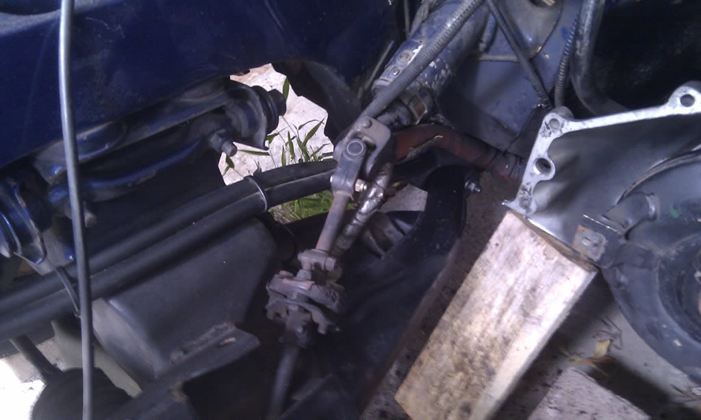

I don't have an "after" photo yet, but here's a crappy "before" pic...

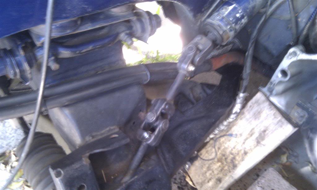

Ok did some googling and found this pic of a UC rack (which I assume has the same shaft as an LH/LX rack). I can now see the stepped down end you're talking about.
So just to clarify, that stepped down end has no flat recess in it for the cotter pin? The flat recess is on the large part of the shaft. Therefore making it impossible to fit correctly without cutting off the stepped down section?
I don't remember seeing this on mine, but I'm still keen to check it out.

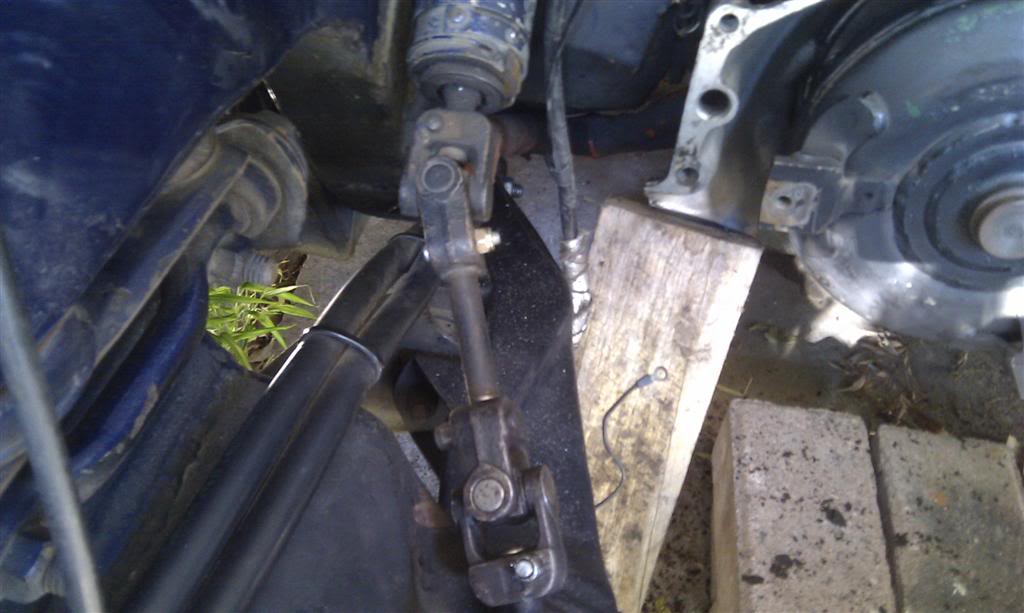

Apologies for the super average phone photos.... I gotta start taking the real camera outside again when I'm tinkering! Here's the double knuckle...

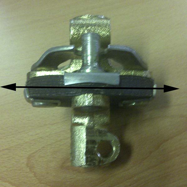

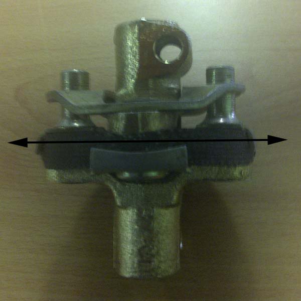

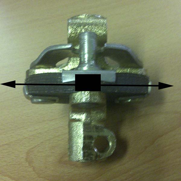

There should be an explanation for why the steering shaft is longer than required. The intermediate shaft does not extend pass the cotter pin area so it does not appear to be part of the manufacturing process. They have gone to the trouble of machining the shaft down so it will slide easily into the joint. It appears to be there for a reason.
The two long pins on the rag coupler will make it difficult for the rag coupler to separate in the direction of the arrows.
There is however not much to stop it separating in this direction particularly if it kicks out on an angle.
However with the steering shaft extending into the rubber section the short rivets will hit the steering shaft preventing the rag coupler separating in this direction. They could just as easily used all long rivets
