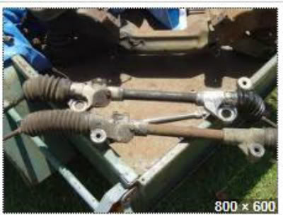

Ok did some googling and found this pic of a UC rack (which I assume has the same shaft as an LH/LX rack). I can now see the stepped down end you're talking about. So just to clarify, that stepped down end has no flat recess in it for the cotter pin? The flat recess is on the large part of the shaft. Therefore making it impossible to fit correctly without cutting off the stepped down section? I don't remember seeing this on mine, but I'm still keen to check it out.
Not to be picky but I don't think that's a UC rack. UC's don't have rubber mounting bushes, they have aluminium bushes.

All of the UC racks I have removed haven't had aluminium bushes.

LH/LX had rubber bushes.
A9X has an alloy version of the rubber bush, the mounting hole in the rack is the same as the LH/LX.
UC racks have a different mount with a steel crush tube.
This photo by Rorym shows LX (top) and UC (bottom) racks. The larger version of the photo is missing.
