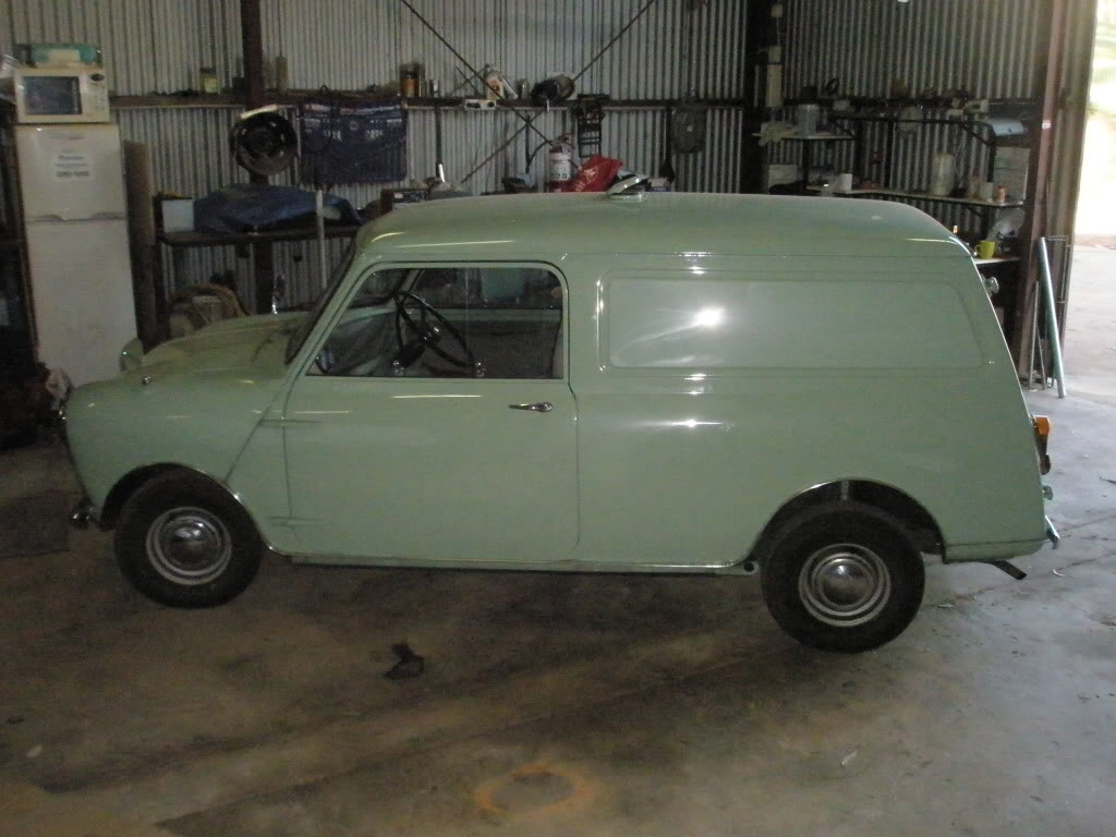

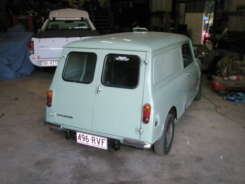

I've got a couple of jobs from a mate of a mate...
This is the first one:

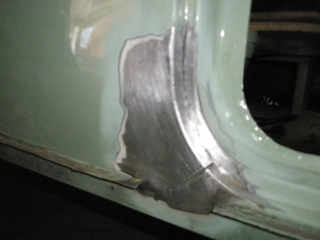

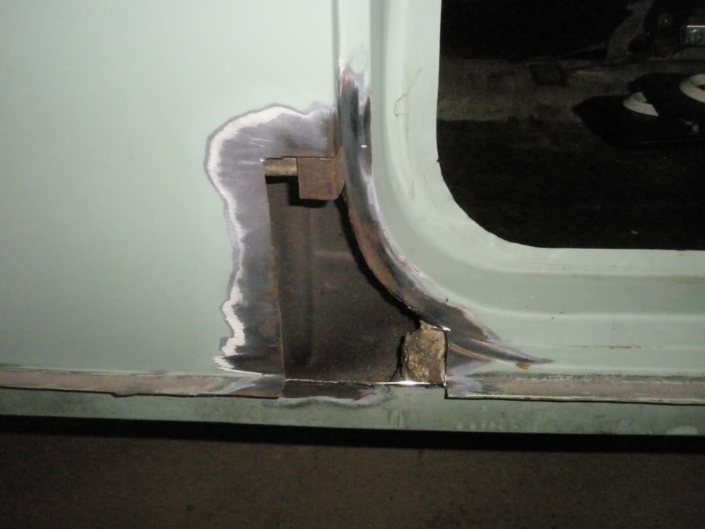

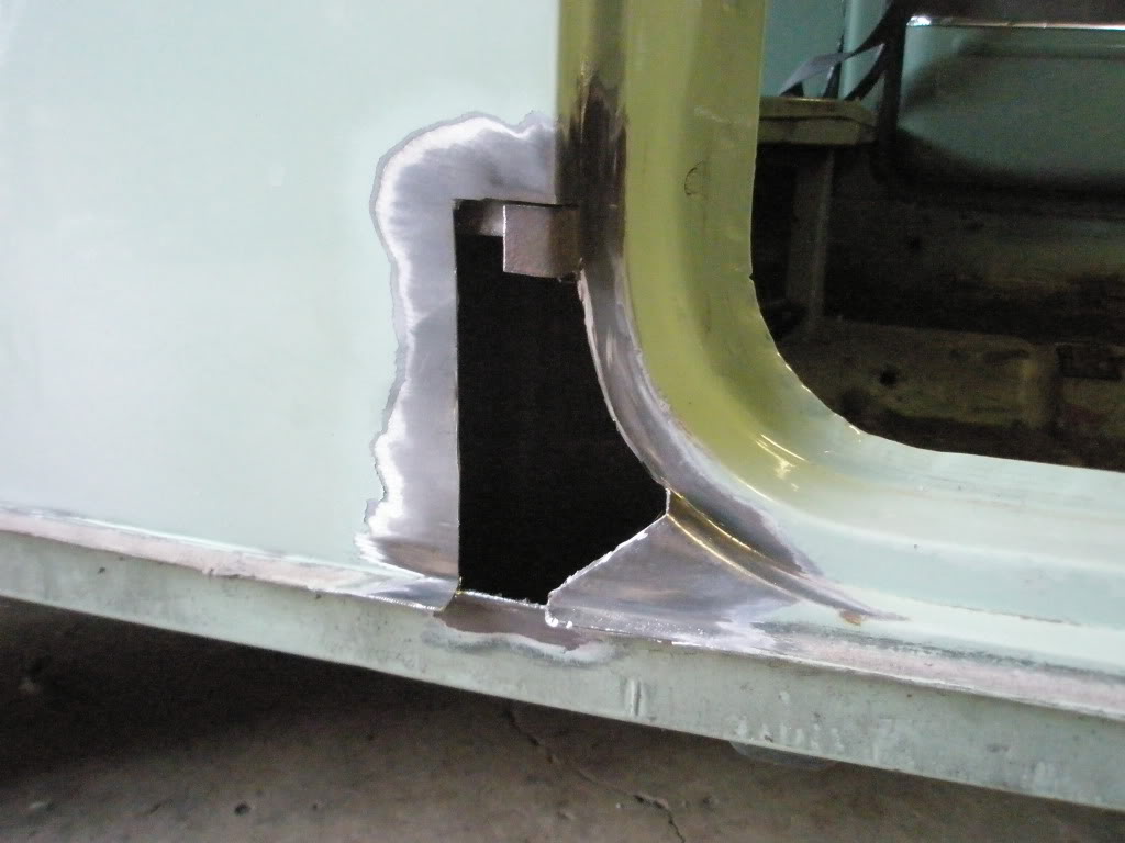

It has a small amount of rust in the lower sill:
So I cut it out:
I will replace it in 2 sections as the owner wants to keep the seam as per factory.

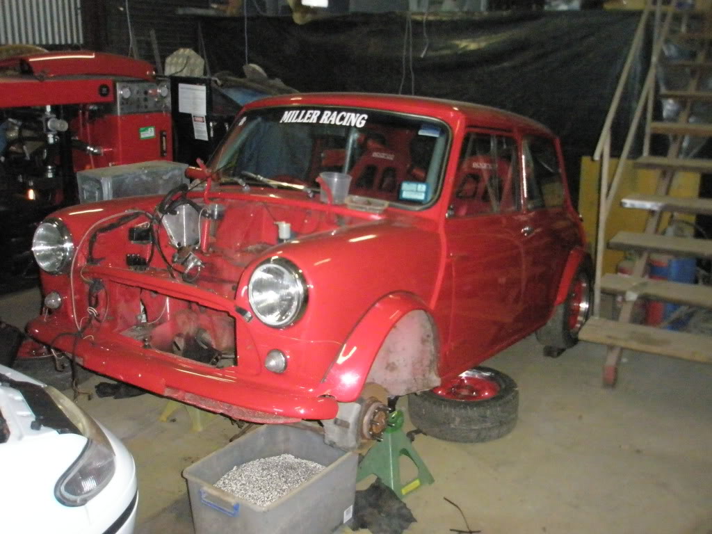

It's a Cooper S race car that I'm going to deseam and degutter, fix some rust and probably some other custom work, depending on what he decides to do with it.

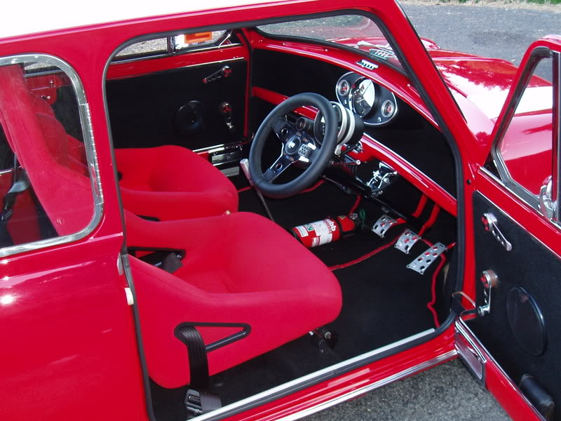

Hanra, a couple questions out of curiosity...
What's been done to the engine? It looks like an A series with SU's, what else has been done?
What does/would it do over the quarter mile? (I know this is not something Mini enthusiasts care about usually, I'm just curious)
Are they 13" rims? Would you say they make it handle better or worse?
Cheers mate, I know the owner of these cars would be interested in these answers too.

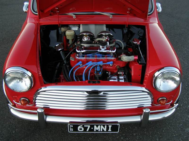

#14 hanra
Posted 11 October 2011 - 10:51 AM
Hey mate, Ill just give you a speil that Ive got saved:
Engine: 1330cc A-Series, Graham Russell Engineering Ported/polished/flowed head, Graham Russell Engineering RE13 Cam, Hypatec pistons/rings, twin 1 1/4in SU's, stub stacks, Ramflow filters, Petronix electronic ignition, re-curved dizzy, 3 core radiator/6 blade fan, High capacity water pump, Engine/Box painted in 2 pac red
Gearbox: 4 speed 4 syncro, KAD Quickshift, straight cut primary/idler/input gear, S clutch.
Diff: Cross pin diff centre, 3.44:1.
Exhaust: 3-2-1 LCB extractors, 2in straight through system with stainless straight through muffler, 3 1/4in tip.
Suspension: Spax 15 point gas adjustable shocks, Adjustable height f/r, Adjustable camber f/r, Adjustable castor, powder coated subframes f/r and suspension/brake components.
Wheels/Tyres: 12inch Performance Superlights, Dunlop Formula R D01J's 165/55/R12.
Brakes: Honda Civic 9.1 inch discs/calipers up front, Stock rear S drums,
Interior: Sparco Sprint Race Seats, SAAS 3 point harnesses, SAAS 12inch steering wheel, Nikken pedals/gear knob, Autometer Monster Tacho w/shift lite, Autometer oil pressure/water temp, Lowered steering colum, Billet indicator stalk/door lock, Billet window winders/door openers, Fire extinguisher.
Exterior: 2 Pac Ford Monza red, Jet White roof with white bonnet stripes, S arches, Bullet racing mirrors, 2 Monza Fuel Caps.

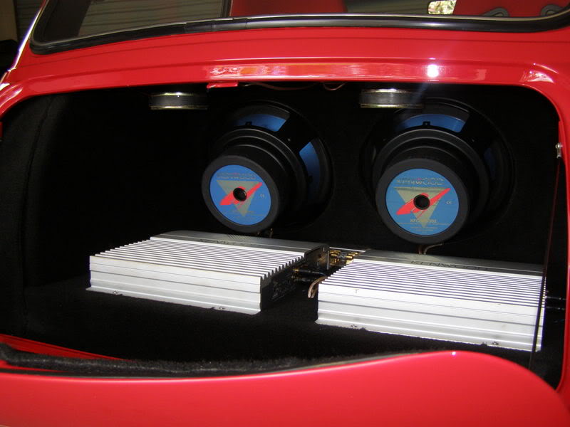

Stereo: Full Kenwood system, RDS head unit, 11 band electronic EQ, Six stack CD, Four 350w 7 by 10's, Two 180w 6in's, Two 750w 12in Subs, Two 4 channel 100w Amps, Steering wheel remote.
Quarter mile..... meh,,, A bit quicker then a stock V6 Commodore. They car only weights in the mid 600kg, I know guys that fit turbos/blowers to there cars get them really moving!!!!
10in rims/tyres are better for handling, but my 12's are still quite good but thats also down to my semi slick tyres.

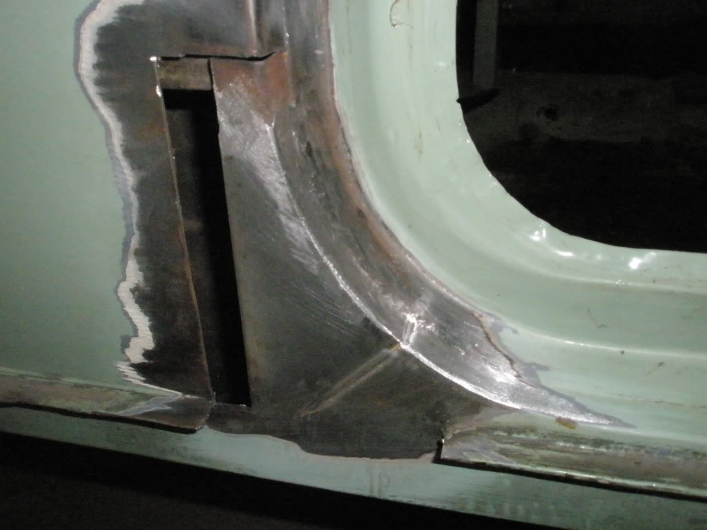

Well, like I said progress is slow, but here is an update for those that are interested...

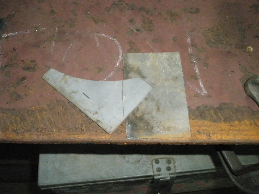

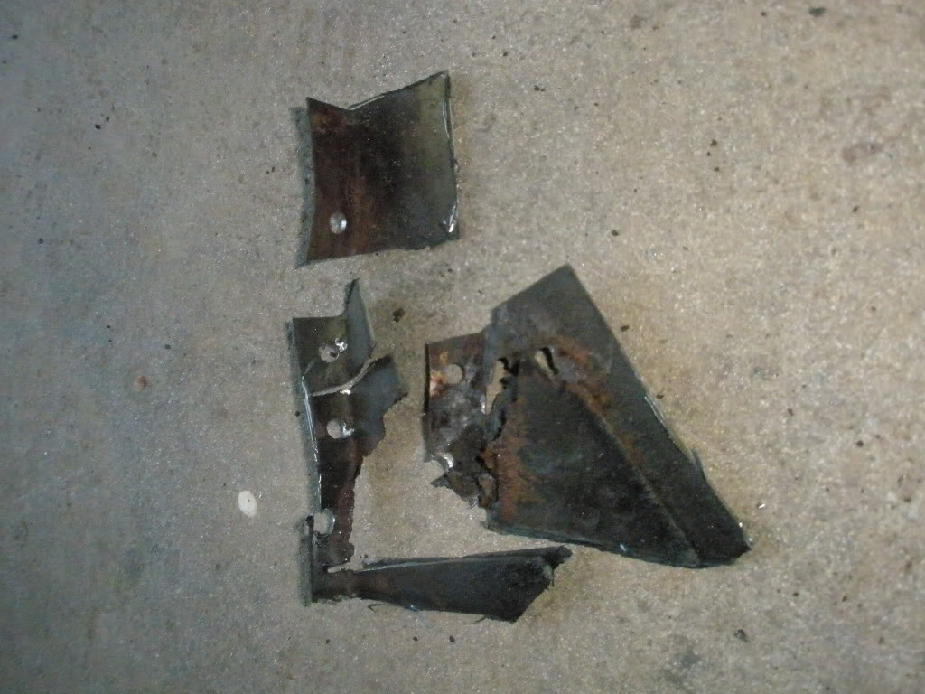

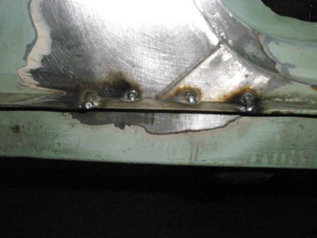

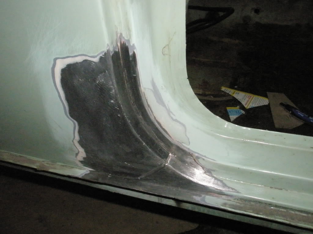

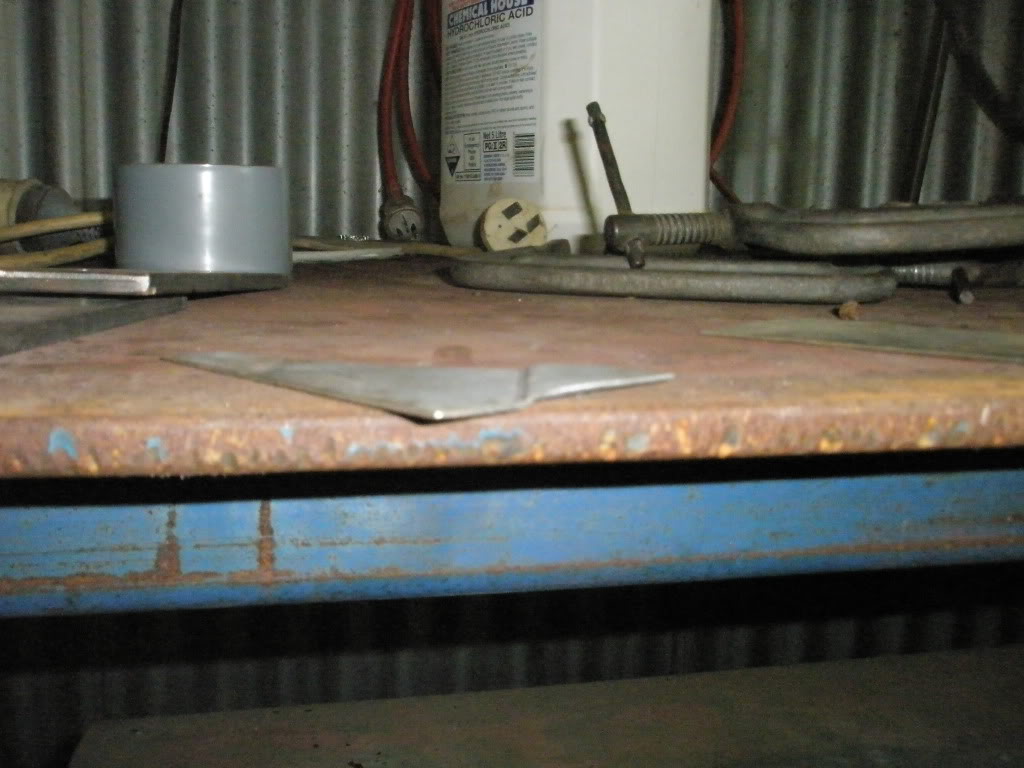

First step was to make a cardboard template of the inner panel. I originally cut it through the join between the inner and outer panels so I knew where the join was supposed to be. Once I'd made the template, then I could hook in and cut a bit more out so I wasn't welding on the join... (if you're pickin up what I'm puttin down. It should make more sense as I progress...)
I then had to make up the inner panel which now included a small part of outer panel seeing as I had cut the extra section out. This meant putting a small swage (dogleg) in the piece so when the 2 panels overlap they still end up flat to follow the body line. This is how I did it...

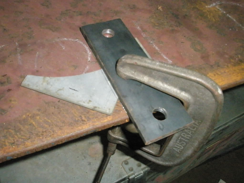

Firsly, I cut a new piece of steel with an updated template, marked it where the swage has to be from the old template, then found a spare piece of panel steel, the same thickness as the swage depth to clamp underneath the new panel to the bench...

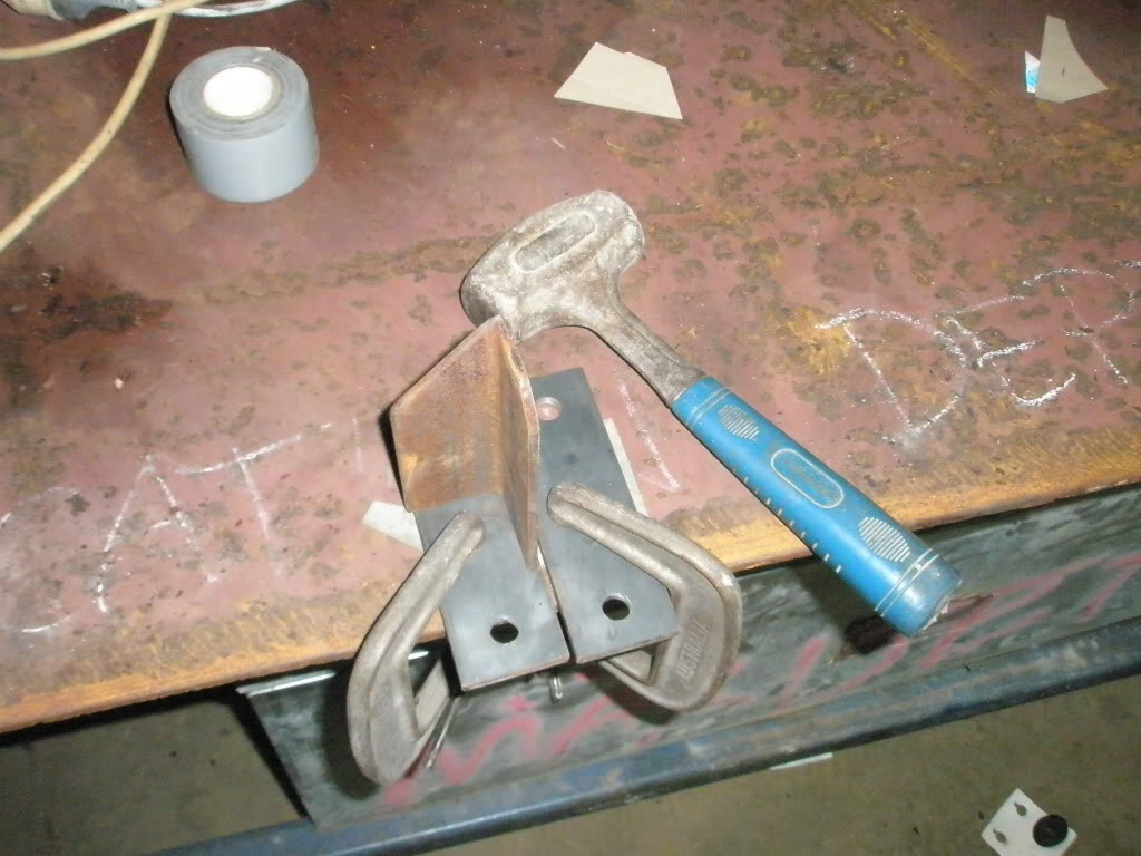

With another piece of substantial sized plate clamped on top of it, both of them lining up with the swage mark...
Then with another substantially sized plate (I used 6mm thick x 50mm wide for both), I clamped that a little off the swage line with a drift on top (I used a piece of 50mm angle to spread the load) and gave it a few hits with a FBH...
And ended up with this...

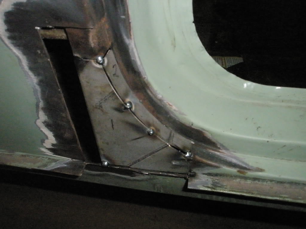

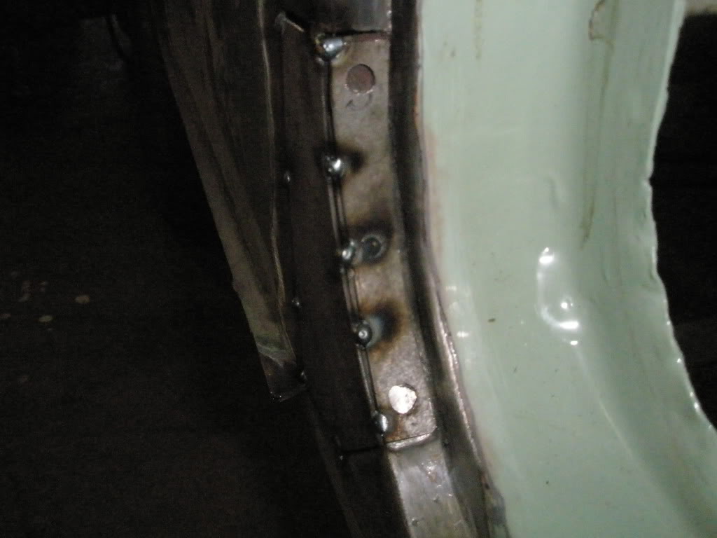

I cut and bent a strip to fill in the inside of the door jamb, which also required a swage to match and tacked them in...
After fully welding them and cleaning them up, it looked like this...

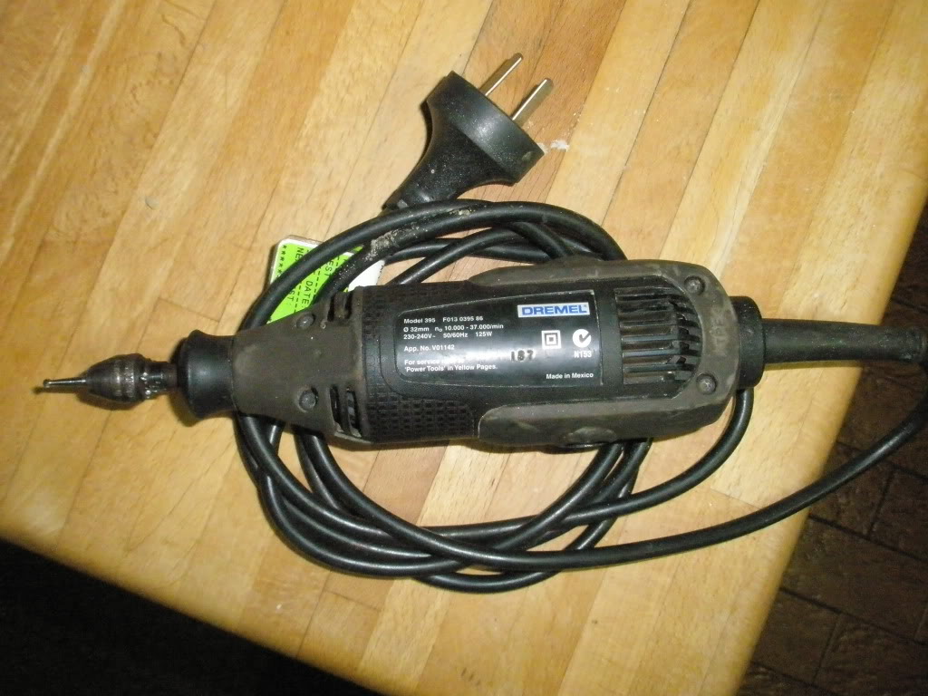

To clean up the weld in the tight corner of the swage I used a Dremel with a tiny little round burr...
Worth it's weight in gold for this job!

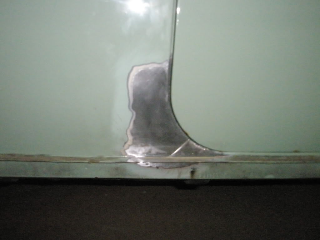

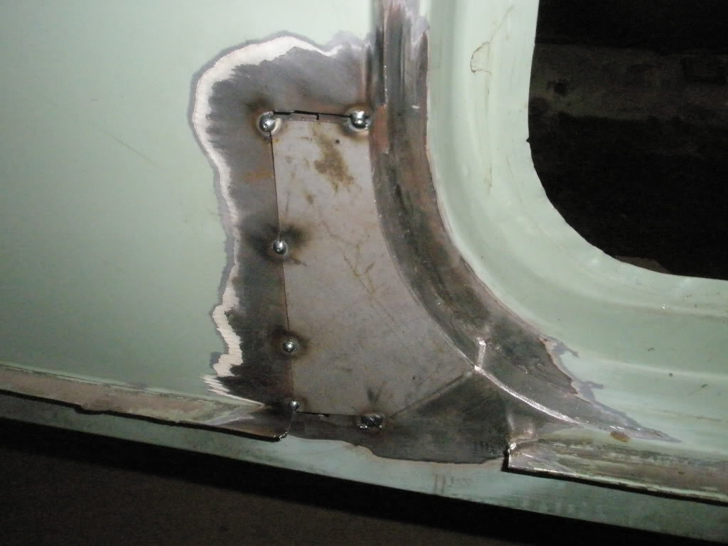

There was then the task of the outer panels. I cut the first new piece to shape, and after a little curving to match the body lines I tacked it in like so...
The next piece to go in was the outer door jamb section which is spot welded from factory so i made the strip up and drilled it to match the factory spot weld spacing and plug welded it, as well as welding it to the new outer panel.

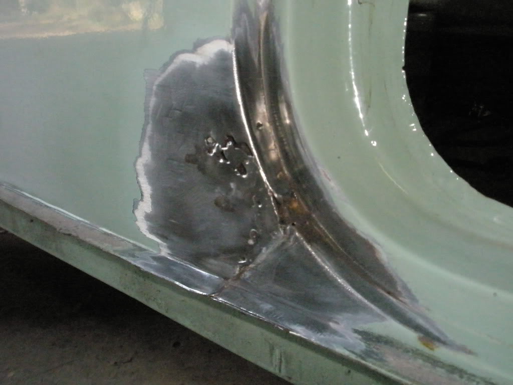

This is it all welded and cleaned up...

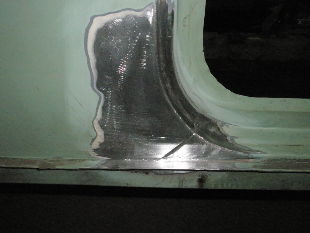

The last piece to go in was the lower seam which is where the lower sill and upper panel meet. As this is covered with a polished ally strip, and the fact that I have just welded the upper and lower panels together, I didn't see the point in sandwiching 2 pieces back in to it to invite rust to gather again. I put 1 piece in as such...
And finished...
I just need to prime it, give it a little spray filler and job done.
There may be more to do on this with seat mounts, etc, but I need to speak to the owner before I go any further.
Until next time... Thanks for reading, Cheers!
