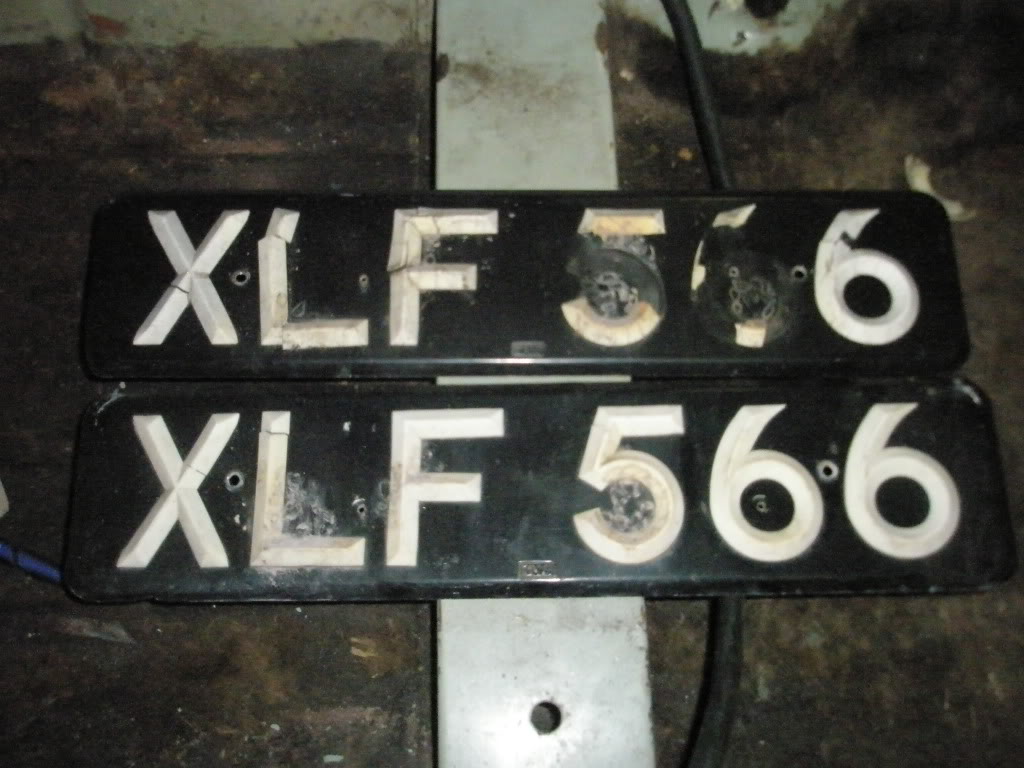

Just another point of interest with this car, it came with the original Pommy number plates with local plates screwed over the top of them. A nice touch, I thought but someone decided otherwise and took them off for rego purposes...

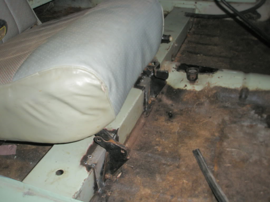

So I've got the go ahead to fix the seat mounts.
Here are the passenger side mounts that are ugly but functional...
Nutserts for seat mounts... Hmmmm.
Here are the drivers side mounts...
As you may or may not be able to see in the dodgy pics, the nutserts have busted out of the x member, leaving gaping holes.
Back of the x member...
Hole is to allow access to fit the next generation of seat mount engineering brilliance...

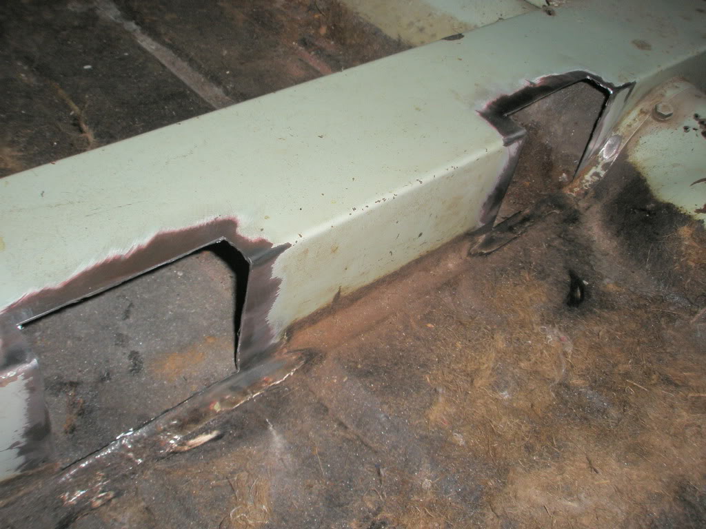

Measured, marked and cut the old sections out.

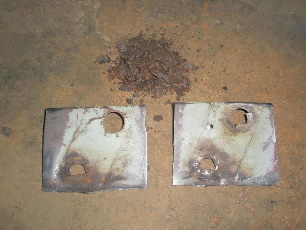

Old pieces and some loveliness I found inside the x member.

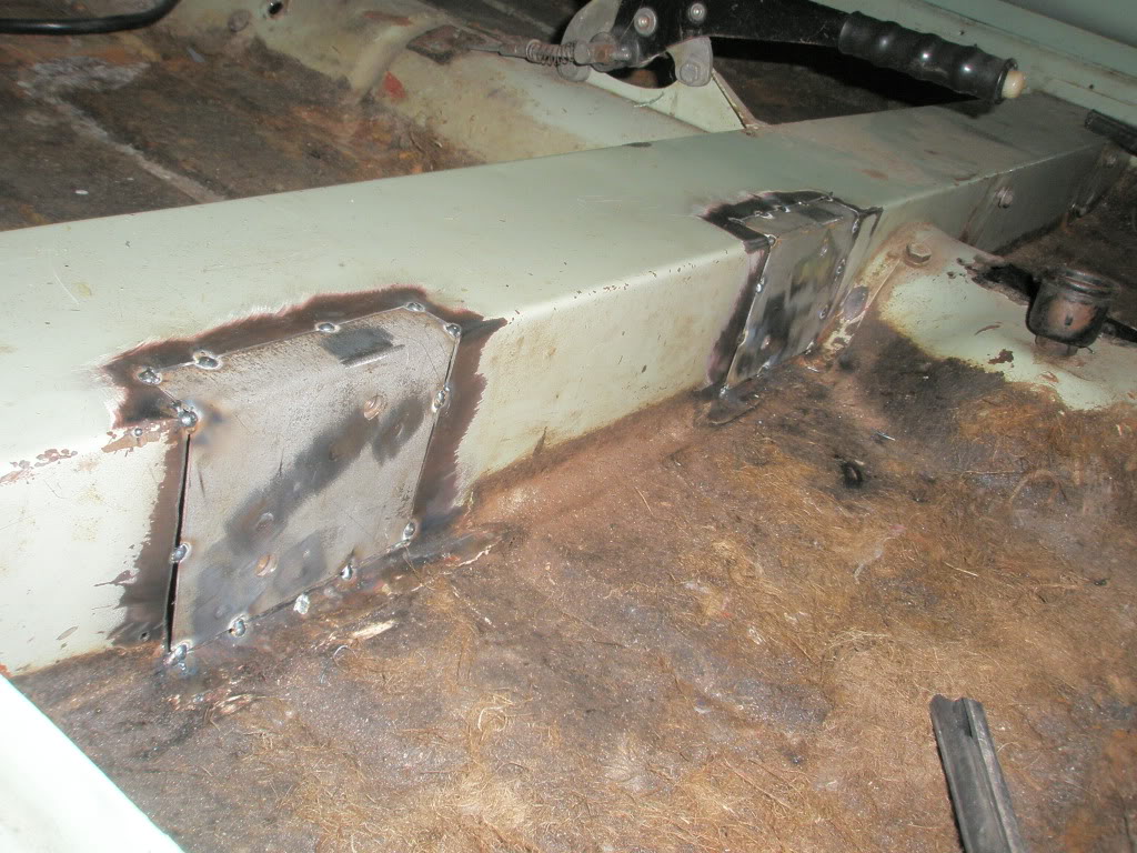

New bits tacked in.
Trial fit of the seat. Fits nicely.

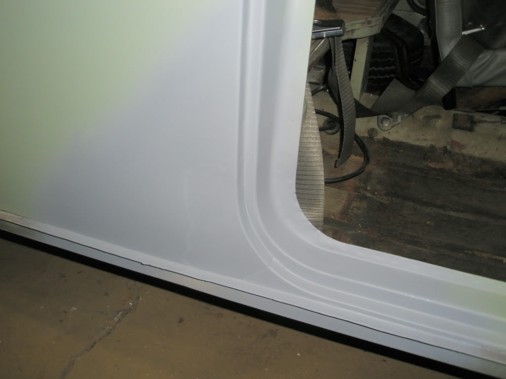

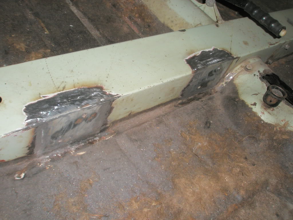

Got the new mounts welded in and smoothed:
As this is a structural repair I was more concerned about making it strong rather than pretty, so I cranked the mig up a bit to ensure proper penetration which ended up giving me a bit of distortion in the top of the x member. I was a bit pissed off at myself about this but when the seat is in it can't be seen and I'm happier knowing the seat won't fall out rather than worrying too much about having a mirror finish.

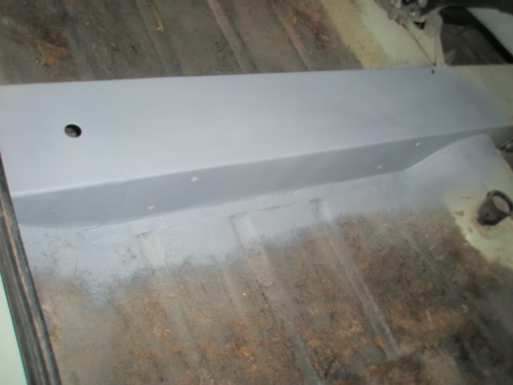

Anyhoo, a quick squirt of high fill, knocked it back and threw on some etch primer and here it is:
And the first repair with the same treatment:
I didn't worry too much about this step as this car is about to be repainted anyway so the painter can smooth it out as they see fit.

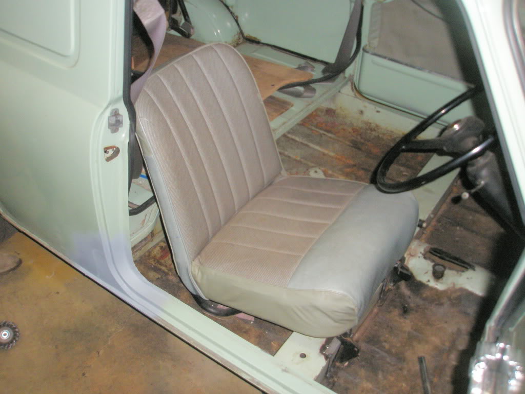

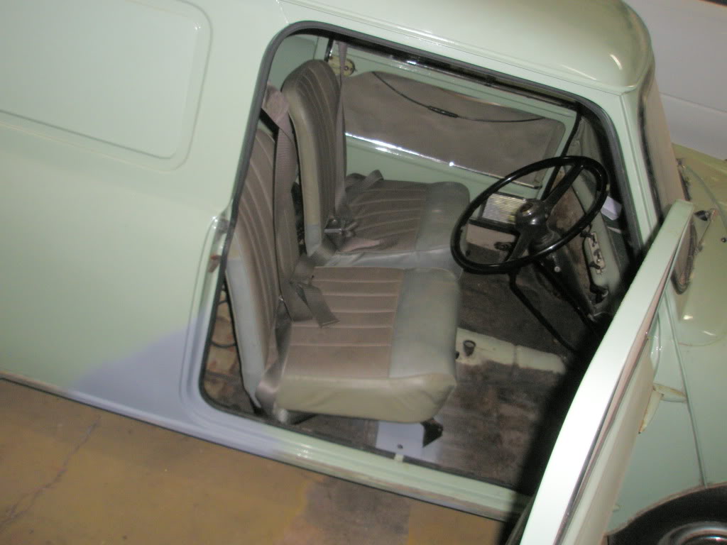

Here it is all reassembled, my job is done:
Onto the next job...
