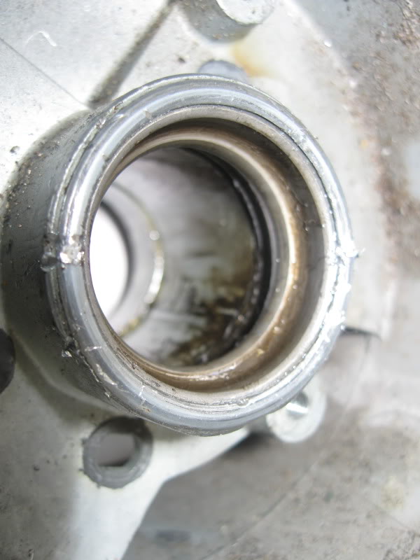

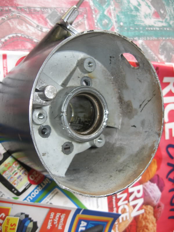

how do i remove the bearing from the steering colum? heres 2 pics of what i am talking about

That top bit that you've already attacked is part of the pot, it has to be removed by force (then you have to figure out how to retain the new bearing without it)

Pretty much use force to get it out?

Break it or grind it off

But then you have to figure out how to hold the new bearing in
I'd say don't touch it unless you have to replace the bearing
And even then.... most here have opted for another pot with a better bearing and left it as is

The bearing fell to bits, tiny little balls everywhere

I believe there is supposed to be as thin metal retainer for holding the bearing in... like a circlip that goes into a groove in the pot
But your bearing looks like its moved so the retainer might have been long gone
BFI might be your only hope

drift it from the rear is how I got mine out, there should be enough of a lip to get the punch on, and slowly work around the bearing race.
To retain the new one, just centre pop it in a couple of places on the front.

I can tell you've never removed one of these bearings Datto.
No groove and no circlip. The alloy lip is simply machine rolled over to retain the bearing in place.

Sadly no, the ID and OD are so close that there's really nothing available. You can get needle roller bearings in roughly the right size if you could figure out how to retain it but it really needs a proper radial ball bearing. I've considered machining the sleeve away completely to allow more room but the column attaching bolts are really a bit too close to allow this, the sloppy factory bearing is about the only option.
