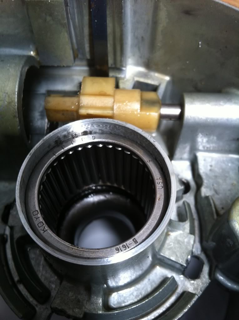

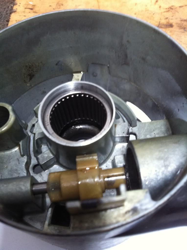

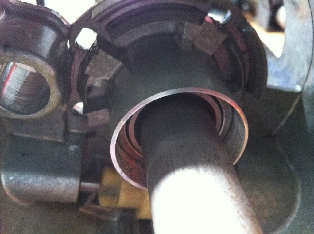

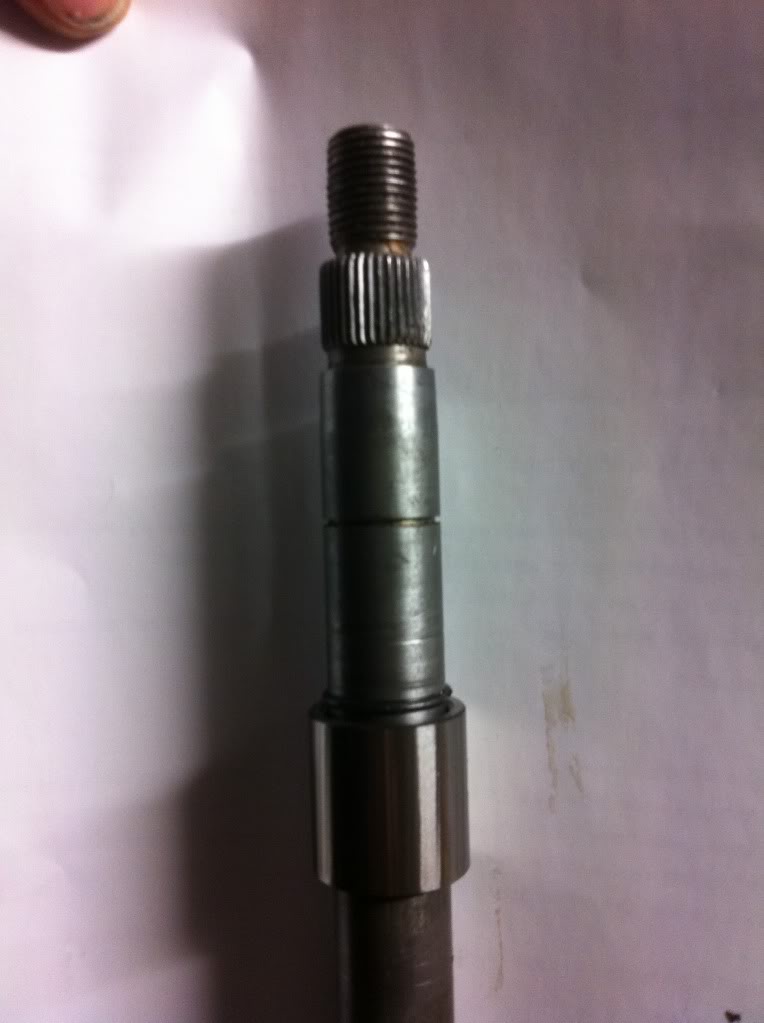

Spoke to CBC yesterday and he was able to get the bearing and inner ring i wanted, picked them up today and machined the pot.
Bearing part numbers and again not so cheap :( but gives an excelent result that leaves the shaft free to collapse if the worst was to happen.
1 x S1616 Needle bearing (1.250" OD and 1.00" long) $25.00
1 x P121616 Inner ring (0.750" ID and 1.00" long) $73.00, ouch again!!
Pot machined and bearing fitted.
Inner ring fitted to shaft.
Shaft installed.
Moved bearing a little deeper (Now directly behind the old bearing)

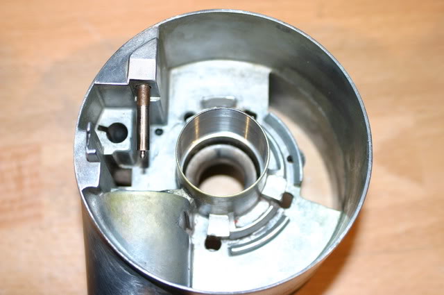

#40 _gsh253_
_gsh253_
Posted 10 July 2012 - 05:13 PM
TB
Bottom of old bearing locates position of coffee pot in relation to steering shaft Re (second circlip)
so i would leave old bearing in place.
Machine centre bush ( approx 28mm before machining) of coffee pot from bottom side up to bottom of old bearing
to take new bearing ( approx 31.75mm after maching) does not leave much material on bush but will be fine
when new bearing sits down in the casting areas of coffee pot. That small lip at the bottom of coffee bush will disapear
with machining.Personally i would do this mod first before attempting to remove old needle rollers you could try repacking with
some grease to keep them in place.
vic

Hi Craig, answers to your points and questions.
""You have to leave the old bearing in the pot"", its what holds the shaft in place, so yes the rolled section is still their.

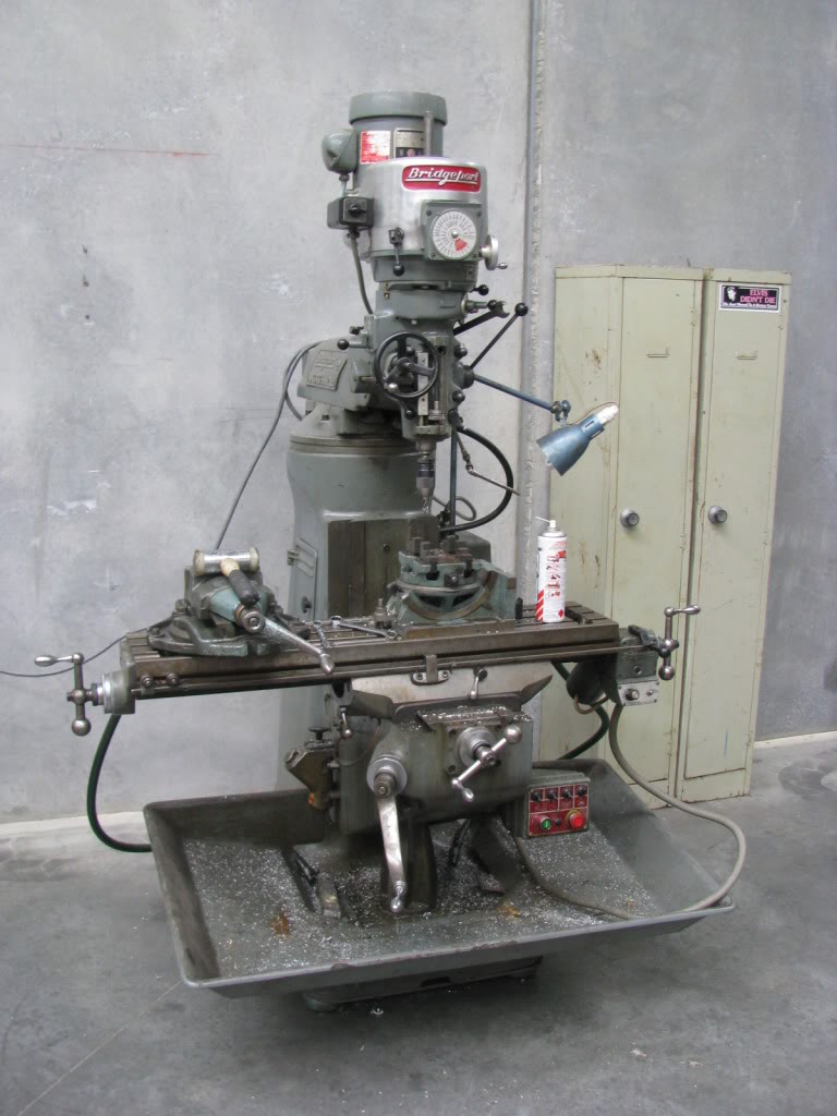

I'm lucky enough to own my own Bridgeport milling machine, Posted Image
so i vertically bored the back of the pot to remove the lip and had to take a little out the rest of the way down to make room for the needle bearing, i didnt have to use loctite here as i left a press fit (Not too much as i didnt want to split the pot) the needle bearing is behind the old bearing.
I do all my own machining.
I didnt and will/would not remove the top bearing under any circumstances.
1. leave the bearing alone, clean it and grease it only.
2. definately get new bearing. (Needle bearing)
3. Take the pot to a machine shop to be machined, or send it to me, as i said earlier in this thread im happy to do it for you for a small cost of my time plus postage. I'm pretty sure a machine shop will be more expensive? It will also be a one off for them, ive already done it and know whats involved and have made some adapters to line it all up on the mill prior to machining and am ready to go. (If you already have the bearing you can send it to and i'll fit it at the same time for you.)
4. Yes reassemble and install
Wouldnt change anything, it works that good.
In the end, if your bearing is so bad that the center of the bearing is already pulling out, you probably need a better one.
All lateral/radial load is removed from the old bearing, it is only their holding the shaft in place so even if the bearing is gritty you wont feel it unless you are pushing forward or pulling back on the wheel.
P.S. i also have a lathe but decided that the mill was the best way to machine it as its a bit fragile and awkward to grab on the sides, whereas i was able to clamp it nicely on the mill bed without fear of crushing it.

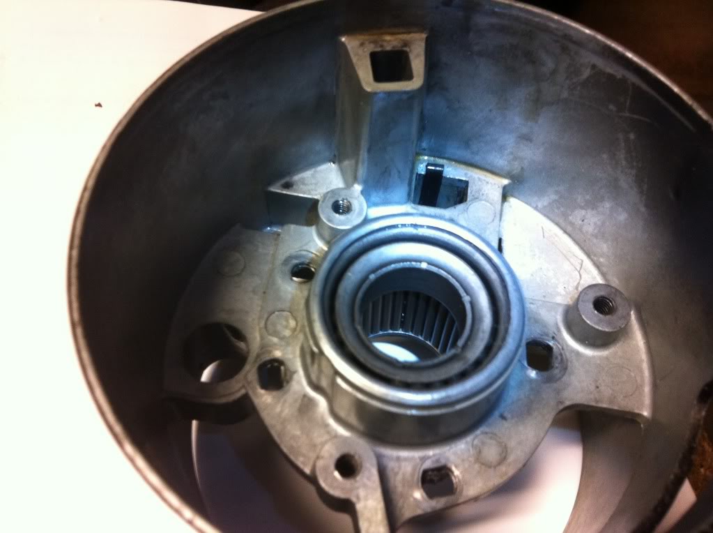

Well I had my coffee pot machined for the bearing remedy provided by LX2DR (Paul).
It was arranged through a friend of a friend and so wasn't present when done, but a reportedly very fancy CNC type machine was used that (apparently) can work to the fourth decimal of a mm - must be an amazing machine.
The coffee pot has been bored to allow an 'interference fit' - apparently a very tight fit not likely to require Loctite, but jeepers it is tight and I'll see how I go getting it into place.
The only issue I see is the fella doing this for me stopped about 10mm shy of the existing bearing and so I will need to place the sleeve very carefully on the steering column shaft to mate it up. I hope there are not issues arising from having this a tad further down the shaft than Paul and Vic (gsh253) have done.
Just need to wash the existing bearing out using Ethyl Alcohol (I was told) and then paint the pot before fitting it up.
Thanks again Paul and Vic for your advice on all of this.
Cheers, TB

Hi Craig
That looks the goods, well done.
As i have said, set the inner ring down the shaft until the rest is assembled, then push the ring back to the bearing, flush with end of the needle, cant go wrong!
Paul

Don't use too much force as you will pop the shear pins lower down the shaft.
#49 ls2lxhatch
Posted 20 October 2012 - 11:13 AM
I did something similar but with a piece of alloy I machined to size. If you cut the tube to the right length then you can use the steering wheel nut to crush the spring.
#50 Tyre biter
Tyre biter
  • 982 posts
  • Joined: 08-December 10
Posted 20 October 2012 - 03:10 PM
Thanks guys,
I considered this but thought it likely to bugger the cir-clip given the shaft OD is greater.
Thought it might twist or bend it, but clearly I need not worry - you've done it without issue.
Thanks for your advice.
Cheers, TB
