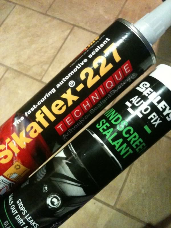

I know there is that rope trick which works well? Ive never tried it though... Whats the best type of rope/cord to use? Any other traps/tips or tricks? Ive bought some sikaflex sealant.. but Ill have to check the number of it to make sure its non-hardening...

SM08 Selleys windscreen sealant black

Don't use the Sikalfex or you will NEVER get the window out again if you have too.
