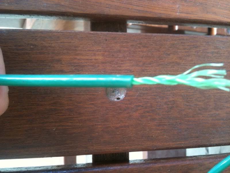

I'm planning on using this cord to fit the rubber over the frame. It's smooth and is rope inside so won't stretch. It's what's used on clothes lines I guess. Hope it's not to small in diameter??
#37 S pack
Posted 16 November 2011 - 08:55 PM
G/day Brad
Yeah mate that clothes line type cord should do nicely as long as it's at least 4mm in dia.

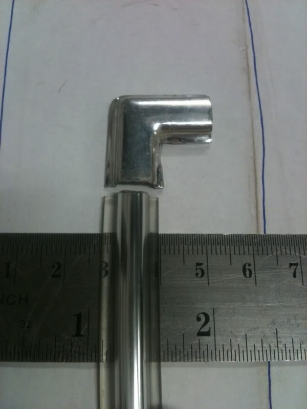

The Rare Spares 'Mylar (chrome) strip' is a bit wider than the original Mylar for the LH - UC screens.
Surprises me they haven't addressed this problem as they would sell plenty of it. Probably because they don't make it.
Think I read somewhere it fits Valiant windscreens perfectly, but I could be mistaken.
Dave.

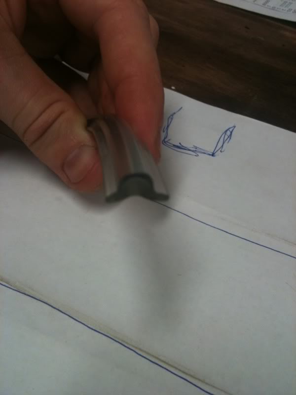

Hmmmm, that cord is closer to 3mm in diam... Might have to take a look at bunnings for something thicker??
The chrome locking strip that I have is 12mm in total width, the edges of it are clear and just the centre is chrome? Not sure if this is correct stuff to use? It was supplied with my rubber kit which uses Rare Spares rubbers. I would have thought the chrome section should be wider to match up with the corner locking pieces???

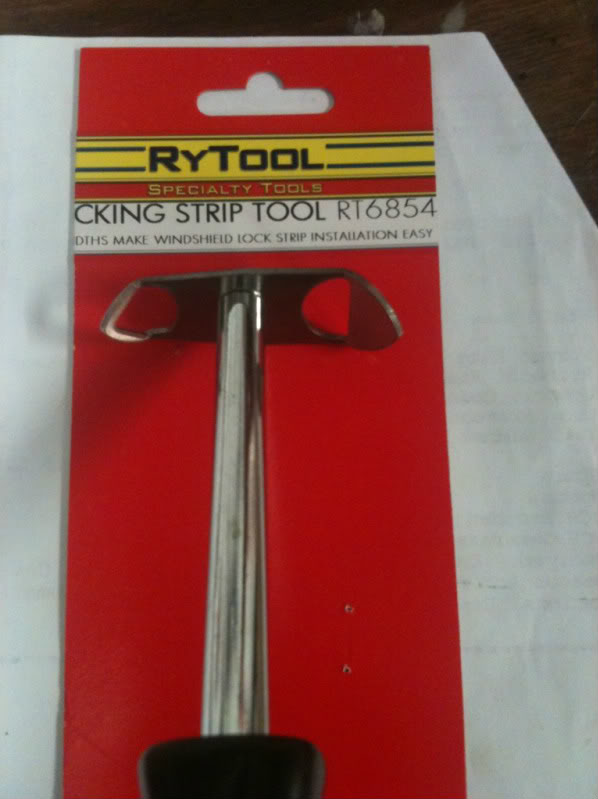

Hoping this tool makes fitted the locking strip easier?

3mm cord will probably do ok , esp as what you've got is so smooth, but 4mm would be better.Thinner cord is more likely to tear the rubber lip on the corners if you aren't careful.
With the Mylar insert they never have the chrome right across to the tips of the edges. The original genuine Mylar had clear edges.
The profile of the Mylar you have looks more like the LC/LJ insert not LH - UC. LH Mylar is flatter and wider, as in it should match the profile of the corner piece.
I'll put up a pic later of the genuine LC/LJ Mylar.

Yes I would have expected the chrome locking strip to also match the profile of the corner piece.... Hmmmm...

I installed some winscreens not long ago, i found thicker cord it the best . Also i found fitting the winscreen without sealant is the best way, then after slide the sealant nozzel under the rubber and pump it in, far less mess. You can then take your time, good chance it could take a few attemps. the lock strip tool is brilliant, same one that i have. leave the car in the sun and use a soapy water, also if the tool is on the wrong angle it can damage the chrome strip.

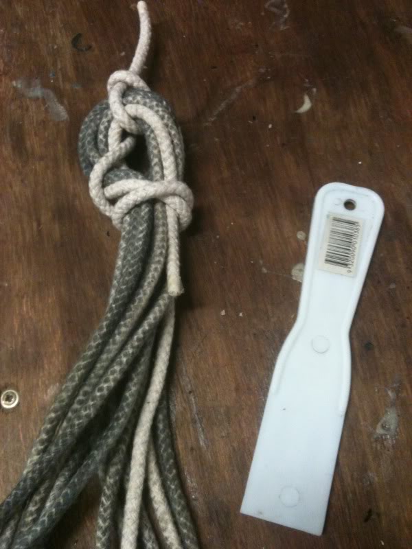

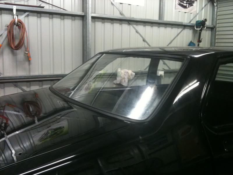

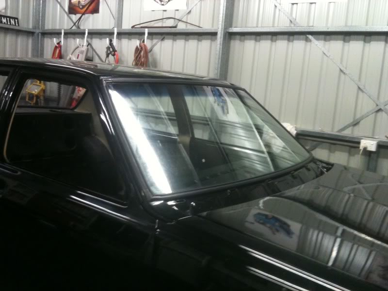

Glass all in! Rear screen took 3 attempts but I think that was pilot error in not using enough lube...
Front screen took all of 5mins! Havnt sealed it yet as Ill wait till I get my NOS locking strip, and seal it just before I fit that.
My trusty tools!!!
