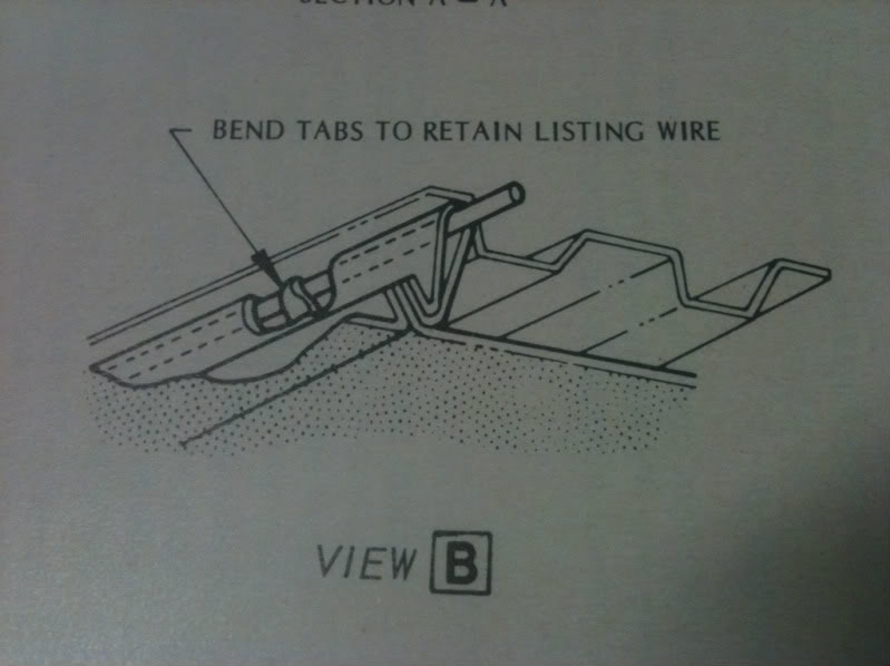

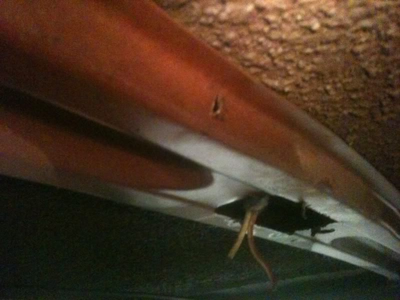

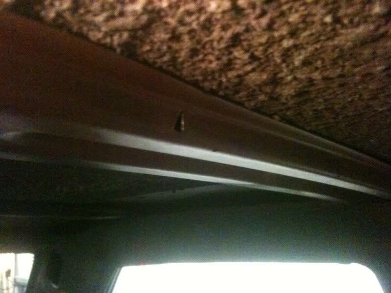

One big concern I have is about the 2 wires. There are hooks in the beams running across the roof which the wires are held up by. The rear beam has all the hooks in tact. The front beam however.... out of the 6 hooks total, 3 have been broken off....
From right to left it goes. hook-missin-hook-interior light-missing-missing-hook.....
Im not sure what to do here.... I was thinking drilling another hole next to the existing one where the hook is missing and feeding a small cable tie through? Or even just some lockwire?
Ive been told to fit the wires first up???
Ive bought 2m of pinch weld which Ill cut up into bits to keep the edges in place when Im fitting.
Any hints,tips or suggestions would be appreciated.
From the GMH Manual:
Intact tab
Missing tab
#2 rodomo
Posted 02 November 2011 - 09:10 PM
Drill a small hole beside it. Find a small self tapper and a small washer. Put a bend in the washer, Screw the self tapper and washer in, hang your wire over it, then tighten the screw so the bent washer captures the wire.
#3 hanra
Posted 03 November 2011 - 04:23 PM
Good idea, however do I want to clamp the wire totally or still allow movement of the wire?

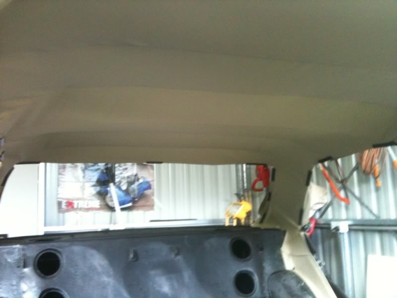

I used the trick of a small screw and a bent over washer. It has worked well. Made a start on it today. Its just held up by pinh weld at the moment.

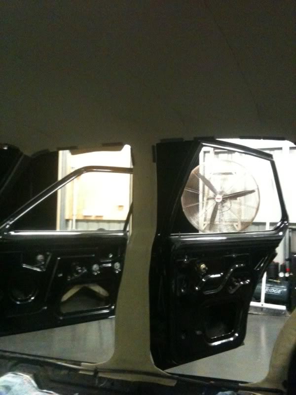

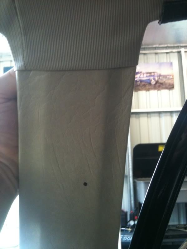

Can I ask a BIG FAVOR..... Can someone please take a pic of the B pillar where the roof lining meets the pillar? Im not sure how high or low this part of the lining should be....

[attachment=16885:HOOD LINE.jpg]
#16 hanra
Posted 13 November 2011 - 03:00 PM
Brilliant effort there NO BALLS. Thanks for that. I noticed your date is wrong in your pic though?

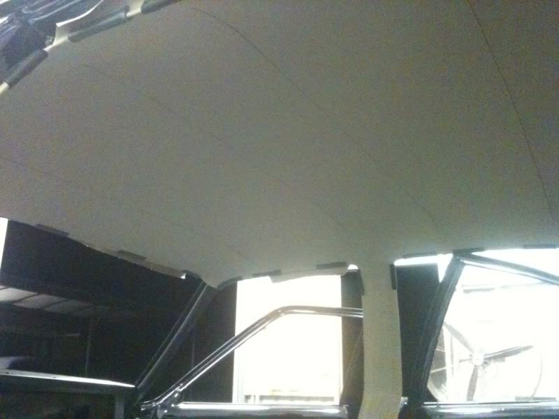

Righteo, thanks to all the support from members here, I think I've got the right idea. Good one.
#18 hanra
Posted 15 November 2011 - 09:55 PM

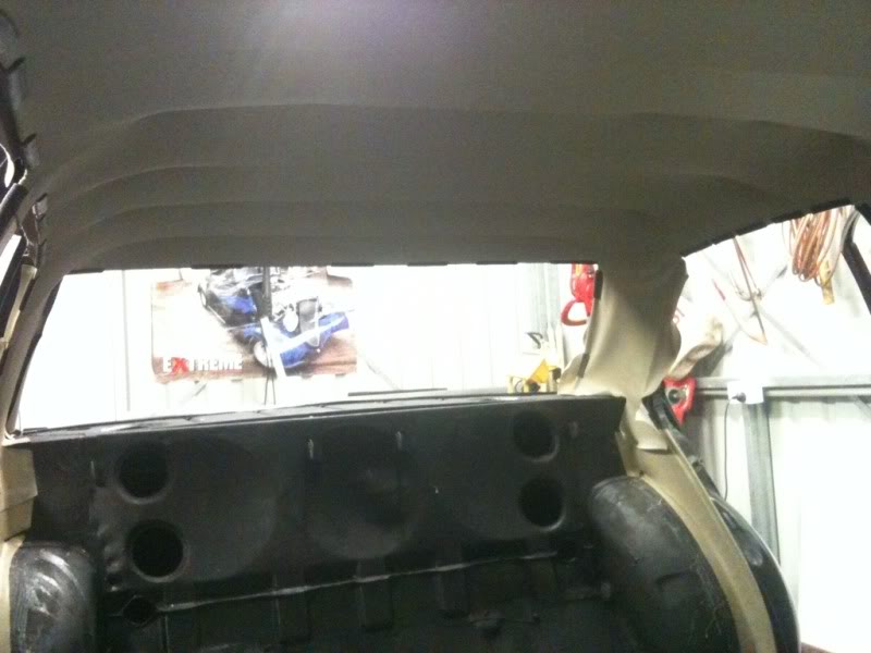

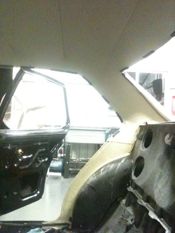

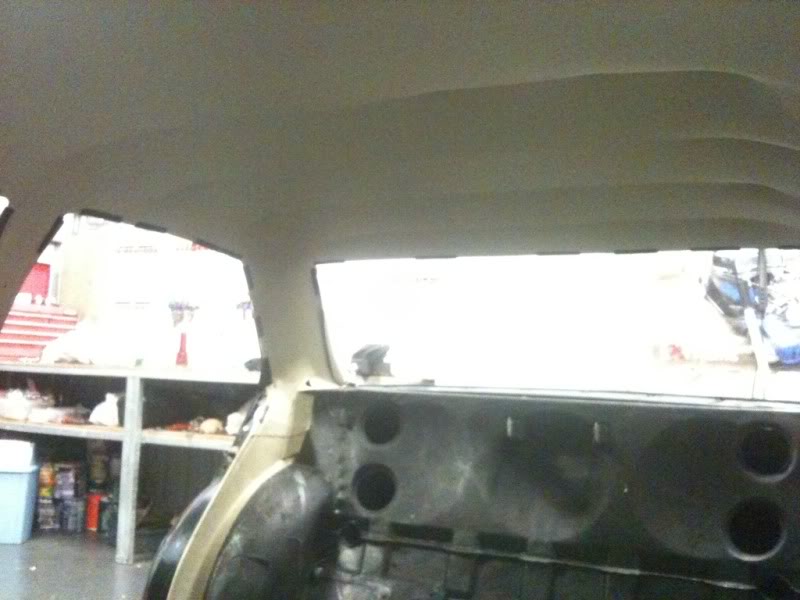

So its coming along pretty well... Just need to glue up the passenger side rear pillar and then trim the excess.. Week long process this has been!!!

Posted 16 November 2011 - 10:30 AM
Nice, looking good there, when its totally fitted are you able to email me some better quality photos if thats possible.. i dont have good ones of a 4 door torana

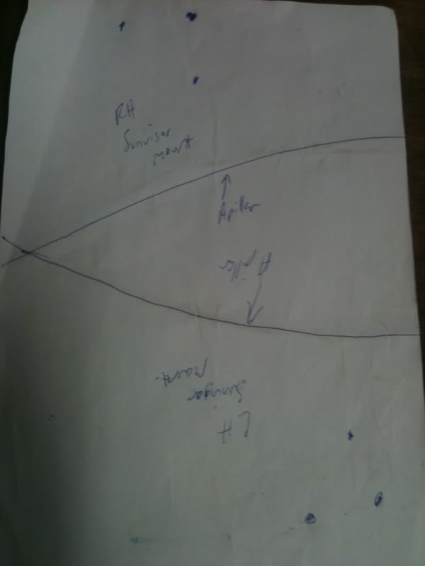

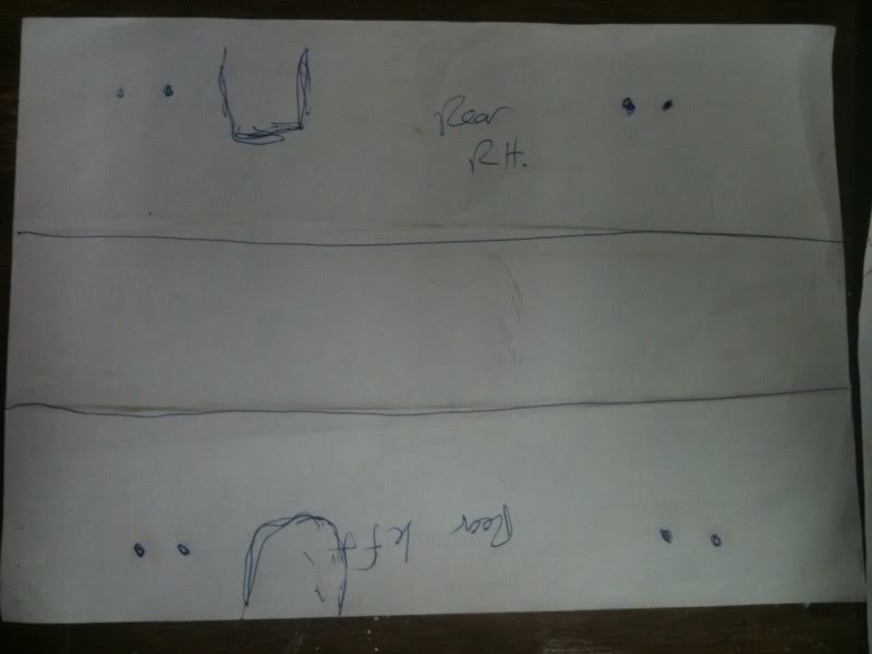

One small thing I did prior to fitting the headlining was to take a few bits of paper and mark out the positions of all the holes for the grab handles, sunvisor mounts and rear view mirror. Hopefully will save me having to poke around endlessly searching for a hole...?
