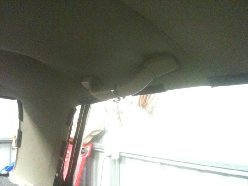

Grab handles:

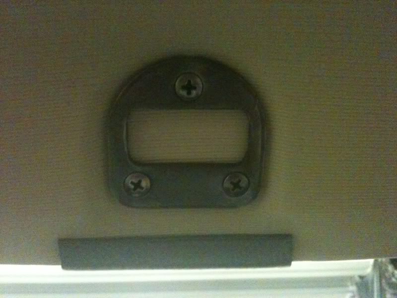

Sunvisor mounts:

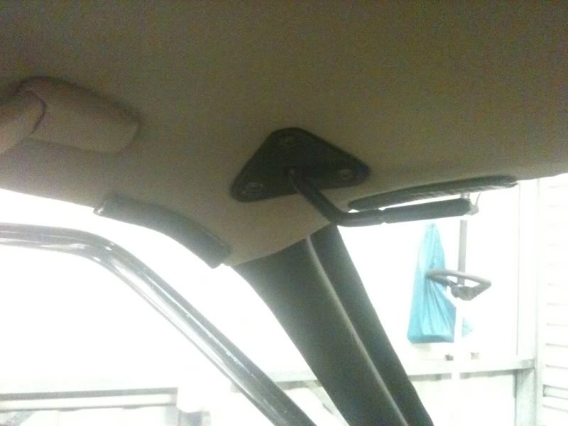

Rear view mount:

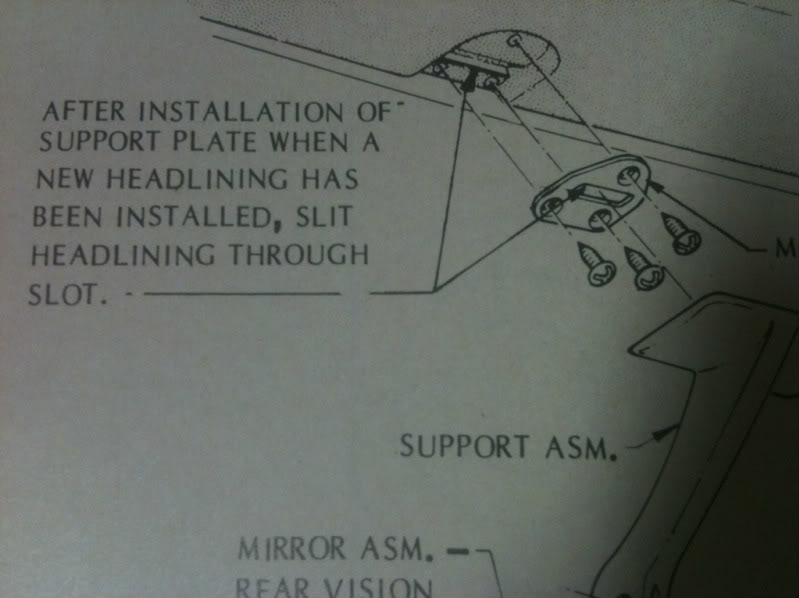

Why is it that the manual says to cut a slit in the lining on the inner section of the rear view mount?

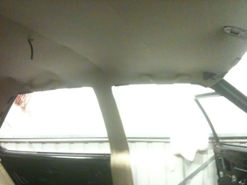

All finished. Bought a new windscreen so now good to go to fit the glass, I want to try and sort out the mylar chrome locking strip though... I simply dont believe that the correct profile stuff is not available....

brad turn your rearview mirror
bracket upside down
you should see couple of tapered pins and a small spring
roof lining needs to be sliced so these pins can locate into
the mounting bracket properly
bracket upside down

Ahhhhhh Yes Dave very good!!!!! Thank you!
