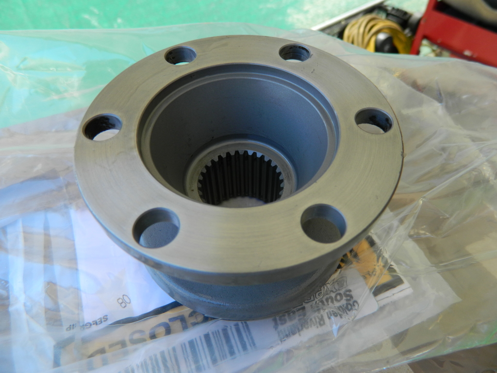

#41 _Mint_
_Mint_
Posted 21 September 2012 - 05:08 PM
heres my reco'd diff yoke we fitted,went for a drive and....................no change ..vibration is stil there it may have moved it up from 95-100 kays to 110 kays
we checked the tailshaft runout was 18 thou at the diff end..so no result

#43 _Bomber Watson_
Posted 21 September 2012 - 08:13 PM
How does just facing it fix a bend in the yoke??
Facing it will simply mean the tailshaft face runs true laterally across the car, but if the yoke is bent it will still "orbit" so to speak x amount......Fool and his money??
Also if the pinion shaft is bent and not the yoke, or a bit of both, then the newly faced yoke will still move in all directions.....
Edited by Bomber Watson, 21 September 2012 - 08:14 PM.

#45 _Bomber Watson_
Posted 21 September 2012 - 08:59 PM
Well if its actually bentt between the spline and the face, in teh cone kinda shape in our pick, then facing it will obviously straighten the face but wont affect the runout.
#46 _Mint_
_Mint_
Posted 21 September 2012 - 09:06 PM
umm..just facing the yoke wont fix a bent one..but Precision Diffs in Adelaide where i got this yoke face both sides of the outer ring(the front and back) which would square it up to the yokes centre line..im guessing but they arent gunna send out a rebuilt diff with a bent yoke if the yoke was bent beyond repair they would bin it
fool and his money..well yes everyone who has a car knows they are like a black hole in the ground to which you pour money :huh:
the pinion could be bent..unknown at this stage
#47 _Bomber Watson_
Posted 21 September 2012 - 09:09 PM
How will facing both sides fix it?
Its all about the alignment of the spline and the middle spigot where the tailshft locates....
