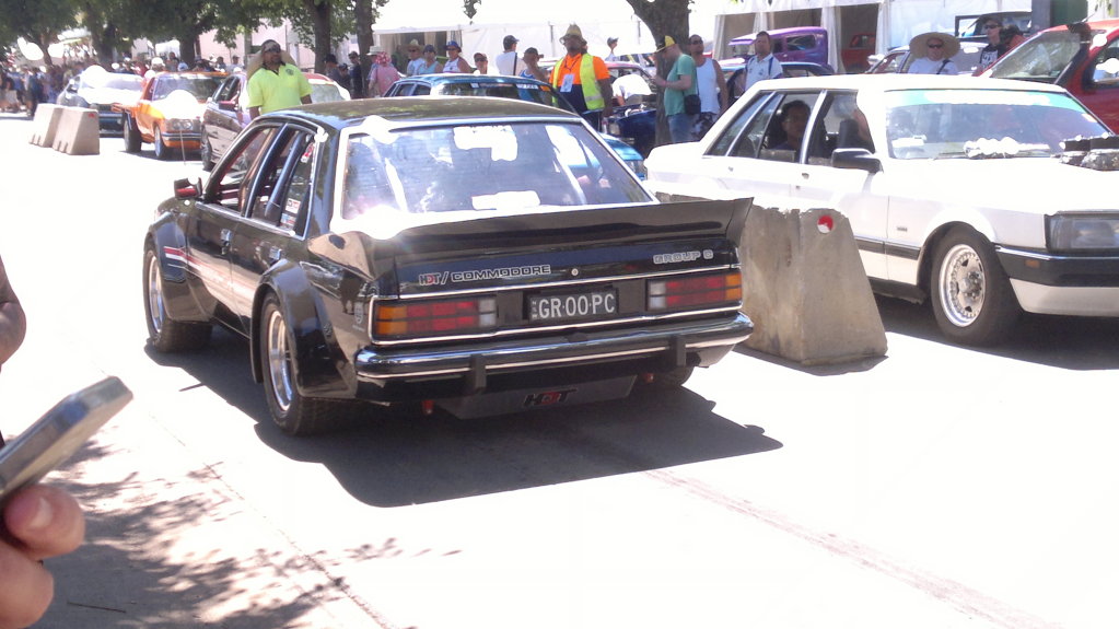

good work Tim, here is a bit of inspiration
